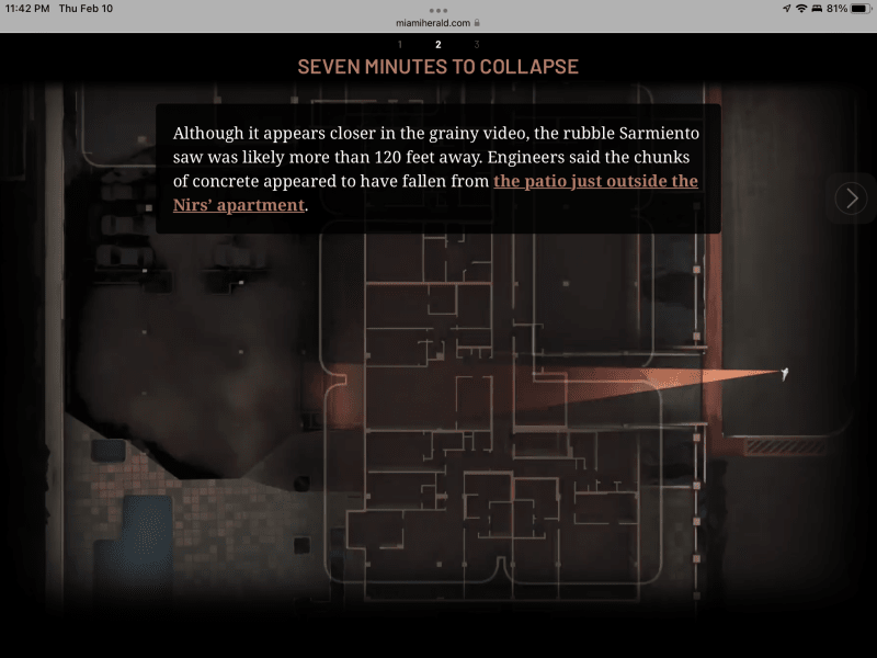

If the deck collapse started at the wall on the southern end of the deck and then progressed northward toward the building, then why don’t we see the collapsed deck in the TikTok photos posted by Sym P. le above? These photos appear to show sprinkler pipes and drainage pipes that were hanging from the garage ceiling underneath the deck, but no trace of the deck itself. Could the deck have not fallen yet in these photos?

…why don’t we see the collapsed deck in the TikTok photos…
Here’s the perspective of the TT video. There wasn’t enough light to see beyond the rubble to the collapsed deck outside of the building. From the Miami Herald House of Cards infographic:

MarkBoB2 said:
11 Feb 22 00:54
@MarkBob2, I think it is possible that the north side of the deck was still supported, attached, or partially attached to the columns and drop slab that ran east-west along the south side of the portion of the building that collapsed (at row 9.1/10). Or even that some columns along 11.1 had not yet punched through. I can imagine parts of the weaker planters breaking away and dropping through the deck while stronger areas, where beams were present, remained intact for a few minutes.

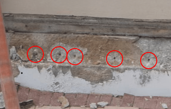

And yet no one has pointed out examples of badly corroded rebar, yet.
I'm not saying it didn't happen. But show me!
Also, at 24 seconds in the Fiorella Terenzi CTS garage walk-through video, that looks like iron oxide in the runoff on the ceiling to me.
