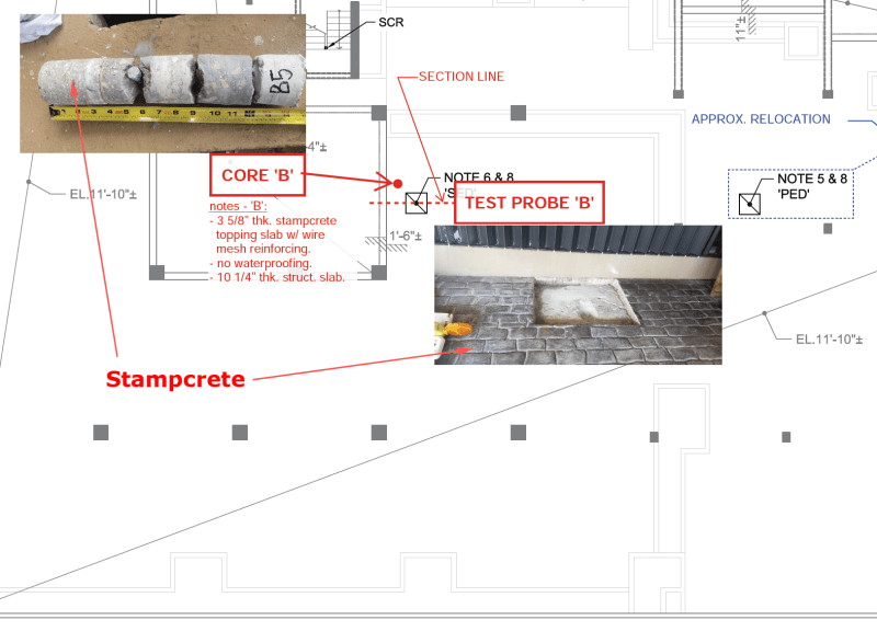

OT, what is "stamped" concrete and how does it differ from the concrete under the pool deck?
AusTony, both the stamped concrete topping slab and the patio deck pavers are finish floor materials and NOT structural members, like the 9.5" or 10-1/4” structural slabs below patio deck and parking deck.
We know waterproofing was not in original build under either topping material, but we know it was added under patio deck over pavers.
The poured stamped concrete slab was most likely poured directly on top of structural slab without any water proofing layer at all.

Hello @AusTony2046,
Following on from thermopile's post above, there are good images in the 2020-10-14 Board of Directors minutes approved, uploaded here by SFCharlie (Computer)(OP)7 Sep 21 16:29
Link

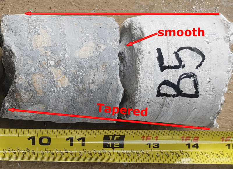

It is worth looking at the original document, specifically page 43 of 83, because the images embedded are high resolution and you can copy and paste into any image processing application then zoom in.
The image of Core B, and notes below it, confirm there was no waterproofing on the parking deck. Something doesn't seem right to me about the last piece on the right labeled B5, it appears to be tapered, the top surface looks smooth and the color appears different than the section above. But the fact that the deck had delaminated meant that the yield strength of the connection of the rebar to the concrete was substantially reduced below its design value, right?

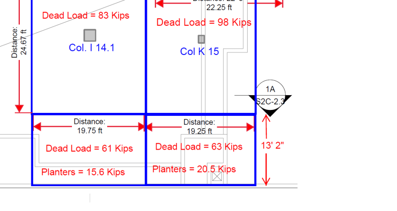

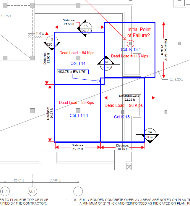

In trying to guess where the initial failure of the pool/parking deck happened, I like to consider which columns were most heavily loaded. Because of the spans, column K-13.1 appears to be the most heavily loaded by a long shot. It is almost 38% more loaded than I-14.1, about 36% more loaded than I-14 and about 17% more loaded than K-15. If we assume deterioration was roughly equal everywhere and barring meteorites, any theory about the initial point of collapse would have to explain why a more lightly loaded column would fail/punch through first. Not only is K-13.1 more heavily loaded than I-14 and I-14.1, but I-14&14.1 are bigger columns. Thus, I would think that gridline K was more likely as an initial point of failure than gridline I. Following is a diagram showing the tributary areas for each of the four columns:

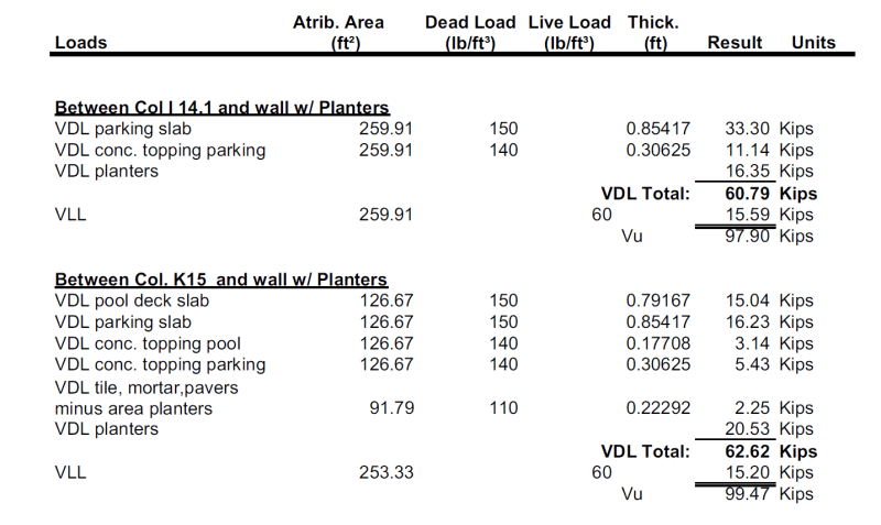

Here are my rough calculations of the dead loads:
[URL unfurl="true"]https://res.cloudinary.com/engineering-com/image/upload/v1644099527/tips/Load_Calculations_ianneg.pdf[/url]
EDIT: There is an offset towards the west of 3.5 feet as you go south from column K13.1 to the one I have labeled as K15. So K15 is not on gridline K. This offset is labeled on Sheet S2 of 14 with the 1-17-80 revision of the original Breiterman drawings. These are the "Basement Level Dimensions." It should also be noted that gridline 15 is 8 inches south of gridline 14.1. There are a lot of offsets in the column spacing that are interesting and make calculations difficult.
The parking slab thickness of 10.25 inches that I used in the calculations is taken from a Morabito core. The change in dimension of the slab from the pool deck to the parking deck I haven't found in the original drawings. For calculations purposes, I have assumed that the slab changed from 10.25 inches to 9.5 inches along the north south gridline defined by the column I labeled as K 15, which is not on gridline K. It's a guess.
Following is a quick and dirty of the loads in the areas between the tributary areas for columns I-14.1 and K15 and the wall. The planter weight is included in the overall dead load. Most of the planter weight would be on the wall and thus not loading the slabs. I still don't see how the failure could have started at the wall.
Rough calculations:
Sym P. le said:
Consideration for weight of vehicles?
That would be in the live load of 60 lbs per ft². I didn't include it in the diagram, since the live load would be even everywhere but it can be seen in the calculations. The factored load uses 20% for the dead loads and 60% for the live loads.
IanCA,
Thanks for your responses to my questions/thoughts out loud. I just got back to read your white paper comparing two theories. The longer lever/moment arm tugging at 1’6” step down in building slab is interesting concept. I am having hard time visualizing how the slab punch shears progress. The long lever arm indicates at some point in time, the deck has punched thru all deck columns prior to hitting garage floor, such that at some moment in time, the whole deck is tugging at I/K/l/M 9.1 at same time. That implies deck failure at South Wall progresses East-West prior to the wave going South to North.
Perhaps I am not following your logic correctly?
