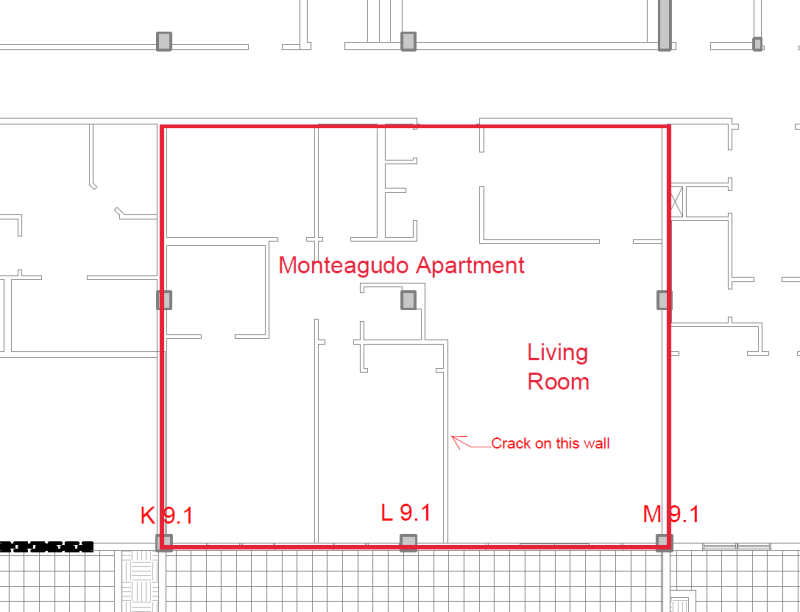

I think I may have solved the mystery of the crack in 611 (Monteagudo). The Miami Herald article shows the crack on the east wall of 611, which would be along the Row M of columns. Based on another look at her testimony, it would appear that the crack is on the opposite wall. The Miami Herald shows the following illustration:
Based on a study of the transcript (corrected) of her testimony, which is referenced in the Timeline, she was apparently facing her balcony door, which wouldn't close, when the crack appeared to her right. Accordingly, the crack would be on the wall between the living room and the bedroom as shown as follows:
As you can see, this is much closer to Row L. Thus the crack would be consistent with the theory by Mike Bell, which theorizes that the building collapse begun with columns K9.1, L9.1 and M9.1 and not near the weight room. It would appear from the transcript that Mrs. Monteagudo woke up when the pool desk collapsed and barely made it to the western staircase before the building collapsed, which took about 7 minutes. The collapse sequence then may have been as follows:

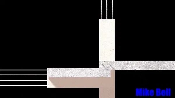

A. Pool Deck collapses. I still favor the collapse at the edge of the parking deck due to fatigue failure and not at the southern wall.
B. The pool deck collapse damages columns K9.1, L9.1 and M9.1, so that they are no longer able to support the facade. A small displacement would suffice. The building immediately begins to find new load paths. Unfortunately, the step beam along Row 9.1 was apparently NOT anchored to the shear wall at the elevators. I have not been able to find a structural detail for how the step beam was supposed to be anchored to the shear wall. Unfortunately, I have not been able to find any pictures which show that detail. However, it appears that the entire building was not anchored to the shear wall very well if at all.
Here is an animation of Mike Bell's theory:
[URL unfurl="true"]https://res.cloudinary.com/engineering-com/image/upload/v1642399134/tips/Mike_Bell_animation_8AXsK1D_p1ffhn.webp[/url]
[URL unfurl="true"]https://res.cloudinary.com/engineering-com/image/upload/v1642399167/tips/Mike_Bell_animation_qsfZCKn_mxs50h.webp[/url]
