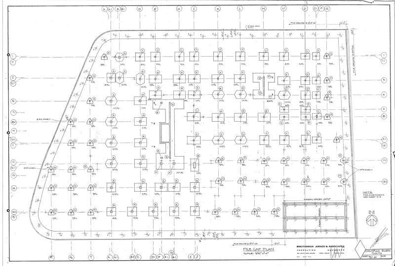

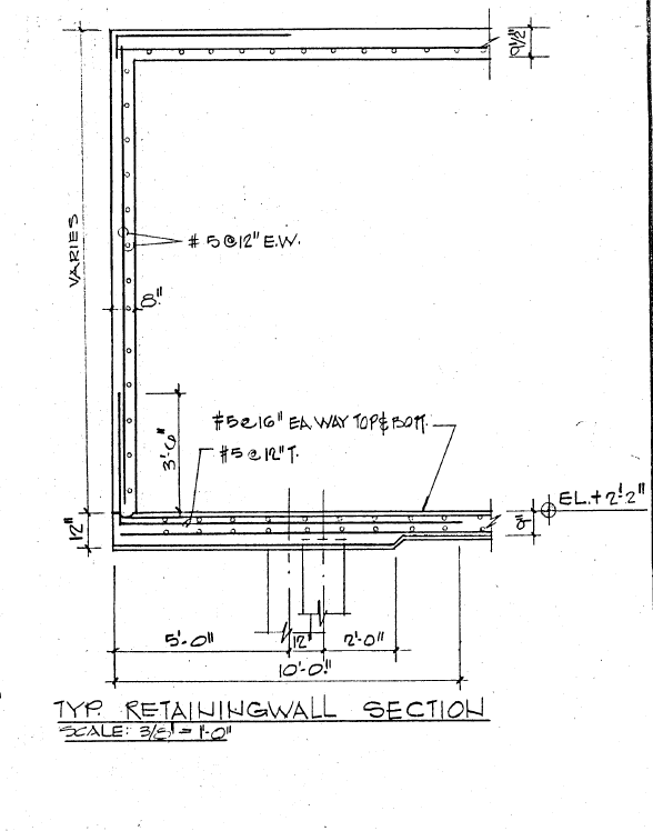

Here is the section detail dug up by IanCA. This sure looks like a turned down slab at grade supporting the South Retaining Wall, via direct load transfer to the hydrostatic soil below and thus the retaining wall supports the patio deck.
thermopile said:
This sure looks like a turned down slab at grade supporting the South Retaining Wall, via direct load transfer to the hydrostatic soil below??

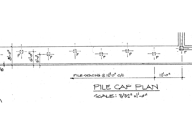

That is correct. Also the drawings show piles on 12 foot centers supporting that slab around the entire perimeter to handle the load. Page 307 of 336 from the big set of drawings or page S1.

There is no such thing as a "down turned slab" if it where it would be a footer or a grade beam. Slabs are on the ground, decks are suspended.
There is an 8" wall running from the West corner of the building to the East corner with #5 bars horizontal and vertical @ 12", and a section of wall from the East corner that is a 12" wall for 10' with #5 bars hortizontal and vertical at 16' centers. The corner is just what a corner is, because you always reinforce them to account for wind loading. Even in a single story CBS house you will have more steel and fill cells in the corners.
NuleDuke, so you have pile 12' on center, that shows nothing in relation to the perimeter wall. I actually know the order of construction, so I know that the sheet piles were installed before the piles, and I also know that there is not a pile under that wall.
Kweef_1, You are looking at the drawings wrong. What you are calling a 12" wall for 10' is the section view of the slab. It is thickened, or turned down as some people say, around the perimeter of the building. The wall is 8" thick and its height varies. At the top of that drawing is the 9.5" pool deck. Those piles are under the thickened portion or footer of the slab. Please take a few minutes to look at the drawings that we are showing you. You can download the full set of drawings from the city of Surfside.

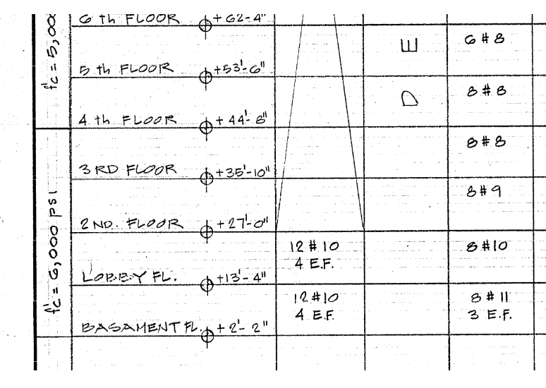

thermopile, the one thing that you missed was that 12" section is called out at an elevation of 2' 2" which above whatever the slab elevation is. It really does not matter what the purpose of that 12" section because it does not transfer to the foundation. 2 is not 0,learn how to read a plan. I would be nicer if you people actually accepted reality.
Dude, the slab elevation is at 2' 2" above sea level. That is the reference point that they used here. Look at page S14 of the drawings. It is page 35 of 336. It shows elevation of each floor. It would be nice if YOU accepted reality.

When you look at the entire sheet, the pile layout is crystal clear. It's simple, really. Piles are spaced 5'0" or 6'0" from the slab edge. The slab had a thickened edge per the detail shown earlier in the thread, 8' wide. There are no columns above this ring of perimeter piles; the thickened edge of the slab is carrying load which has been transferred down from the grade level slab, through the retaining wall which bears on the thickened slab edge.
Say it over and over again all you want, but that perimeter wall carried a non-zero load. Period. End of story. To continue to say what you're saying is ignoring facts. If you want to modify your position and say that the perimeter thickened edge/pile placement/retaining wall/grade level slab detail is a bad design, say that all you want and I don't think anyone is going to really disagree with you.
Put your ego away and LOOK at the detail thermopile posted above. That vertical block drawn at 5' OC from the edge of the slab, with a twin another 12" further in? Those are the piles dude. Note that there's not a column above in the section; note the hook bar tying the grade-level slab to the retaining wall.
None of this is that hard to figure out if you stop rambling about how smart you are and actually read the drawings.

Nuke, you don't know where the ground is, there is an entire floor below that 2'2" elevation, you talk about being an idiot, you define it. Bottom of E-4 is 125' 8" to the top, learn how to add, it is a easy as 1+1=2
Again, seems like you're talking specifics without looking at drawings, or if you are actually looking at drawings, you can't read them. It's very clear what the basement TOS elevation is, and that there most certainly is not a secret hidden floor underneath it.
