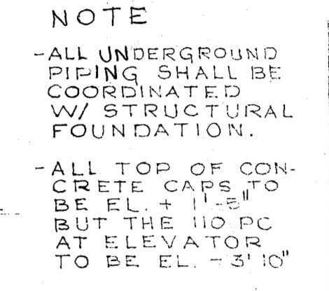

...there is an entire floor below that 2'2" elevation, you talk about being an idiot, you define it. Bottom of E-4 is 125' 8" to the top, learn how to add, it is a easy as 1+1=2
Holy cow! You got something right! One whole thing right all by yourself! E-4 does go up to 125' 8"! Congratulations dude! Maybe we all owe you an apology! ... or something.
But wait! There's more!
Not only does E-4 go to 125' 8" like you said, but so does E-2, H-2, and H-4! And those four columns just happen to be where that big old air handling unit was located, 1' 6" above the roof! What a coincidunce!
Well it seems you taught this old retired electrician how to add and subtract and to read these old drawings perty good. Why don't you grab a shovel and measuring tool and show us that secret hidden floor below the parking level.

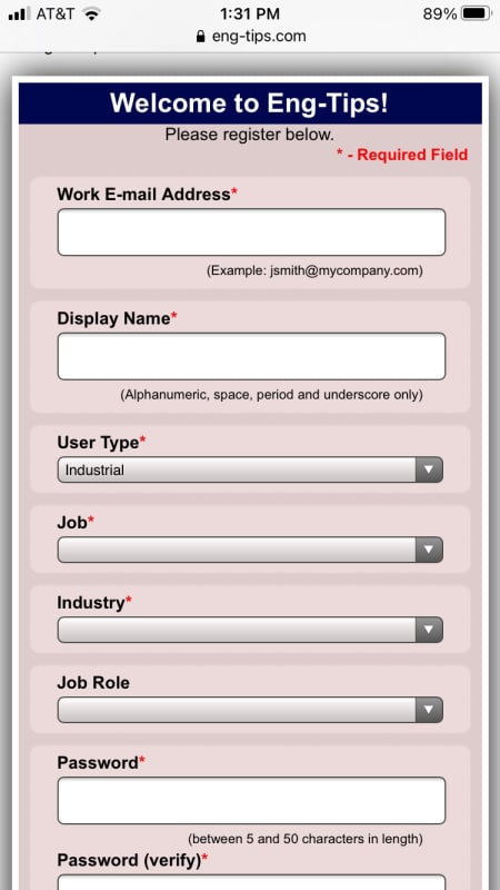

don't know why it displays as that for me when under my profile it states Manufacturing - Metal Fabrication/Welding, Fabricated Metals, Technician
When you join Eng-Tips you answer the questions shown on the screen shot below. The User Type Field is the field input that gets pasted by your Display Name, rather than your job, industry or job role.

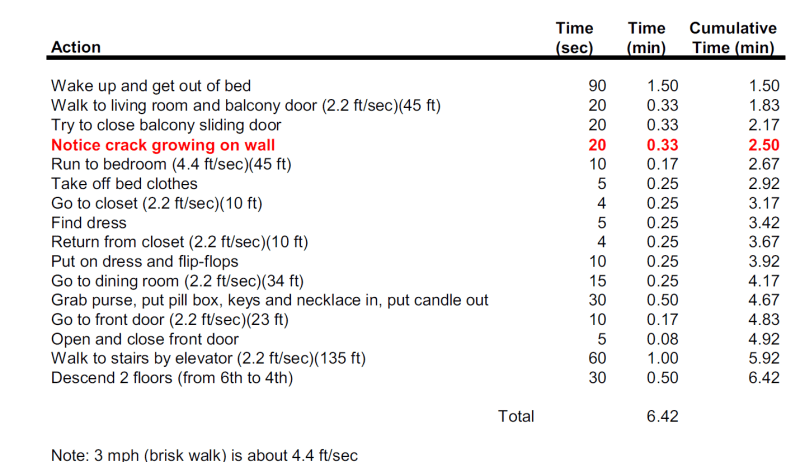

Thanks for your kind words. I did a quick and dirty time and motion study of Mrs. Monteagudo's movements:
As you can see, there isn't much time for Mrs. Monteagudo do anything else. I think that the seven minutes between the pool deck collapse and the building collapse is not exact. I think that that there is some uncertainty and that time may be between 5.5 to 7 minutes, with 7 being a maximum. The time may actually be closer to between 6 and 6.5 minutes. I think the crack was close to the outside wall and may have been caused by column L9.1, as can be seen in the picture below of the second bedroom. The wall to the left of the column is the wall between the living room where Mrs. Monteagudo was standing and the second bedroom. As can be seen from the time and motion study, the crack reached her at about halfway between the pool deck collapse and the building collapse. Her apartment (611) is also about halfway from the top to the bottom. If the pool deck collapse caused the base of column L9.1 to no longer be supported, then the crack may have started at the top as the column separated from the floor slabs. The step beam at the lobby level also had a smaller section at column L9.1: it only had a vertical section of 16.5 inches between gridlines K and M. West of K and east of M, the step beam had a vertical section of 27.5 inches, so it stands to reason that of the three KLM9.1 columns, it was the weakest at the step beam.
There’s no doubt that the Timeline estimates the time of key events, as the only true time stamps we have that are accurate to the second are the 911 calls. We do have several times that are credible, but not accurate to the second:

If the collapse happened at about 1:15 AM, then Mrs. Monteagudo would not have had time to do her hair. If you have any suggestions how the time and motion study could be improved, I would be most appreciative.
EDIT: I am assuming that the pool deck collapsed at 1:15 AM or so and that the pool deck collapse and NOT the first collapse is what woke Mrs. Monteagudo up. The time and motion study is necessarily speculative, because it cannot be determined when Mrs. Monteagudo woke up. The rest of it is estimated, but not speculative.
There isn't enough detail in her testimony, but the distances to the lobby are the same. It would have taken her about 30 seconds to go to the lobby from Apt. 111. And about 30 seconds back to Apt. 111 from the lobby.
