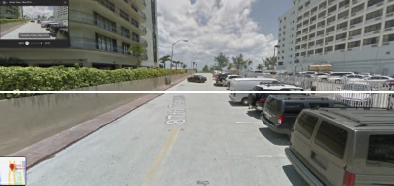

The image of the Street between Champlain South and 87 Park, prior to Construction of 87 Park, clearly shows there was a concrete walk/curb, on the 87 Park side, up to the privacy wall of Champlain Towers South. It appears Champlain's South perimeter garage wall definitely had better water protection prior to construction of 87 Park than after concrete sidewalk removed and replaced with loose gravel fill.
So removal of that concrete walk/slab would have been very hard to do without damaging the privacy wall.
One would assume the concrete sidewalk sloped away from privacy wall and drained into street.

thermopile (Military)28 Jan 22 15:59 said:
... removal of that concrete walk/slab would have been very hard to do without damaging the privacy wall.
No, its not difficult to remove a sidewalk from an adjacent structure.
The gravel strip/boardwalk was a straight forward exchange for the sidewalk/asphalt pavement that it replaced. The gravel free drains through the substrate and has no impact on the adjacent property which hugs the property line.

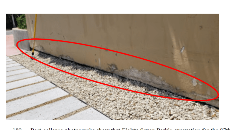

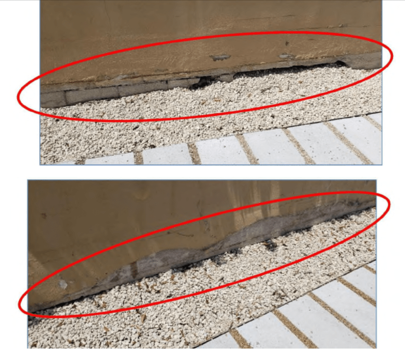

For skilled crews, it's easy. For the lowest bidder, not so easy. Pages 62 top 64 of the class action suite do appear to show damage caused by removal of that sidewalk. Water would definitely penetrate CTS from these points. This area of the building wasn't in good condition going back to the late 80's/early 90's, so definitely not the cause of the collapse, but without a doubt provided another hand in pushing the building past it's limits sooner.
Potato images for those who don't want to look through the PDF.
Thanks Demented, I've considered the damage shown by those images to be superficial. The construction detail as I understand it is that the sheet piles are driven, then the basement wall is poured to the inside of the sheets and capped by the slab. This concrete work is easy to finish and will be solid. The privacy wall then slightly overhangs the prior construction to create a finished line against the property and the lower overhanging portion is trimmed with block sections. This is not structural and can be (and was) refinished. When the slab fell away to the inside of the property, it broke away but left the privacy wall standing. Where the site was later stripped and the remaining portion of slab removed, the gravel sluffed in.
I have no reason to believe that the sidewalk removal might have damaged the slab or even remotely disturbed the sheet piles or foundation wall. Although Building Integrity made a pitch for slab tension compensating for failed column supports, and thus reason for perimeter damage to cause the collapse, I cannot agree with that extended reasoning.

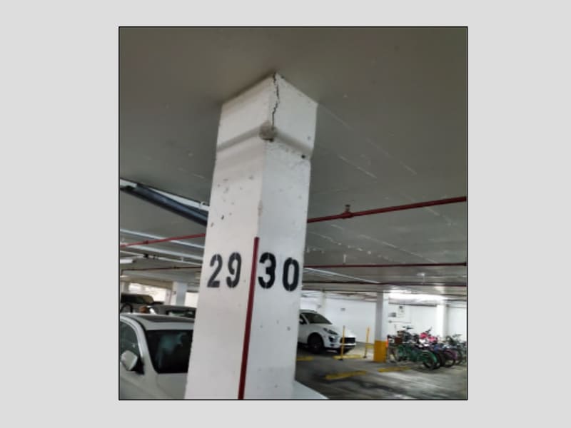

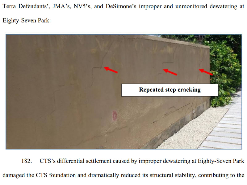

A more damning image from the litigation is found on page 71:
Consider the following (green circle is 29/30):
Also, from page 60, if the east end of the property was settling, the vibration from 87 Park could be contributory.
EDIT X: Also, while I'm at it, all of the cracks that were readily apparent on the underside of the pool deck/parking slab would indicate significant topside cracks centered around each of the columns but hidden by the topping/tile work.

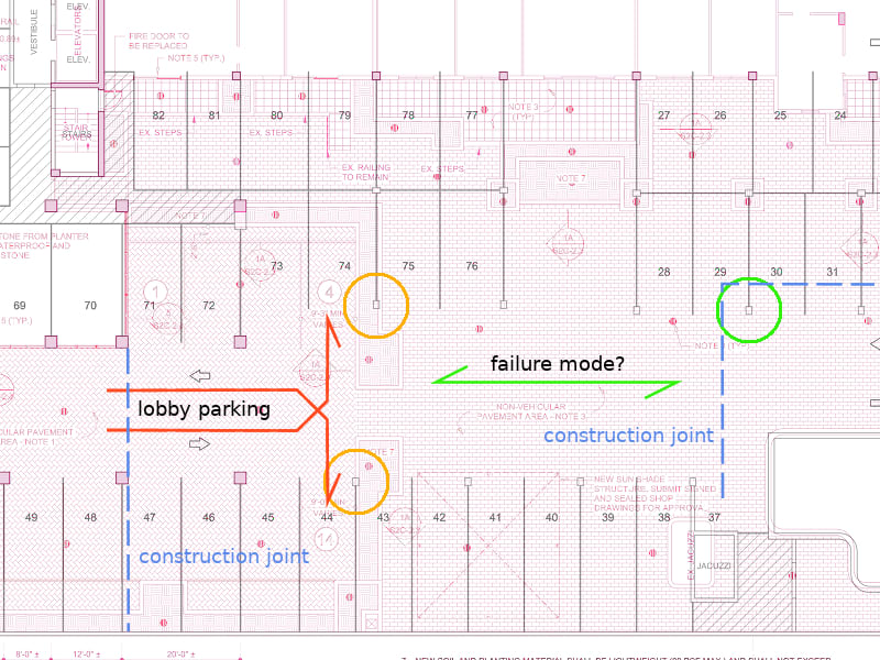

Looking at your failure mode overlay area showing construction joints, and the fact that rebar is missing in pictures of construction joint near pool, and BI’s jump rope theory;
it would seem jump ropes in failure mode area between building and south patio deck wall, may have be carrying much of the deck load.
The construction joints allow failure mode area to contract and expand east to west with less restraint than the North-South expansion and contraction of failure mode area, thus contributing to deck sag and allowing vibrations to create movement in deck.
Thus the Vibrations and thermal cycles would appear to stress the overstressed areas even more till rebar starts popping from sagging slabs and stress relief at tops of skinny columns.
I won’t waste any more time trying to explain why removal of slopped concrete pad allowed more water into garage, as that may have been very small contributing factor to collapse.
