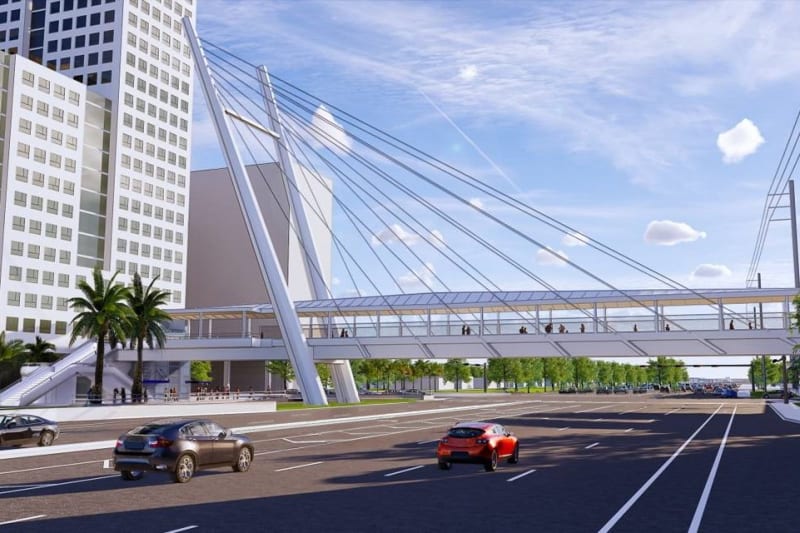

New FIU bridge designs revealed, four years after fatal collapse
06 MAY, 2022 BY ROB HORGA
