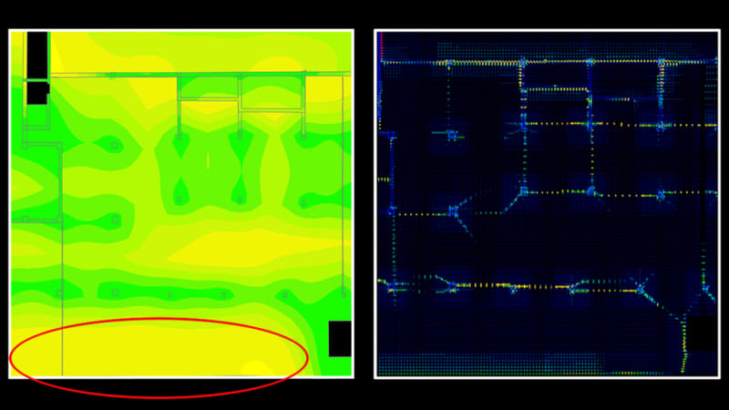

Round 1 sold well in print so they're doubling down in podcast form. Again, the engineering model promoted by the Miami Hearld seems to assume the pool slab abutting the perimeter wall rather than resting upon it. I doubt the likelihood of this construction detail.

Agreed. The MH really wants that Pulitzer.

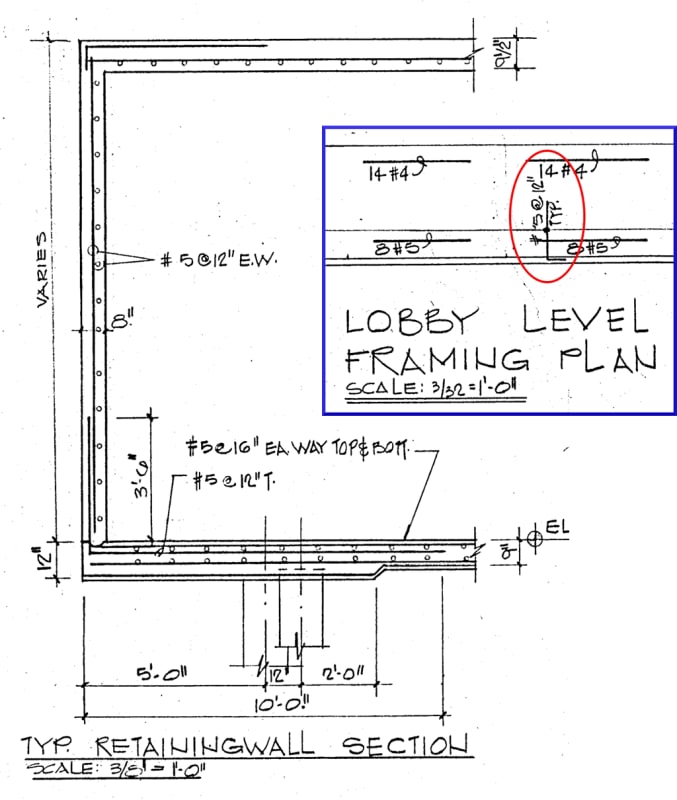

From what I remember seeing the drawings and the photos of the aftermath, the pool deck slab was sitting on top of the south pool wall
From the first link above, it's difficult to reconcile the following statements:

... 90-degree hooks were used, which adequately simulated 180-degree hooks called for in the plans
... Slab to perimeter wall connection - No. 5 bars at 12” on center, 90 degree hooks with 18” leg. ... the connector bars were placed at the middle of the slab.​
with the plans:
They've set up a sensationalized detachment scheme that allows a > 1" drop along the perimeter wall as a precollapse stress riser.
The drawing seems to show a monolithic corner, between the deck and the wall. The deck does or does not sit upon the wall. The deck does or does not "hang" off of the wall.

The problem with having the deck abut the wall is that it sets up different shear scenarios for the slab. The slab rebar layout anticipates the wall supporting the slab (which a monolithic pour is consistent with). There are plenty of issues at play but MH's introduction of this nonstarter (my opinion) is not good for discussion or journalism.
