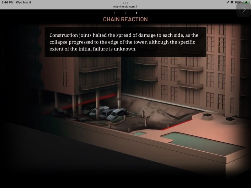

In case it would help, here’s how the Miami Herald infographic House of Cards depicts the construction joints. Dr. Lehman would have reviewed this prior to publication, so it may have been acceptable to her from an engineering perspective.

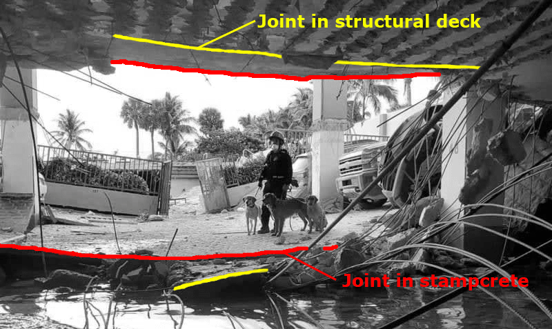

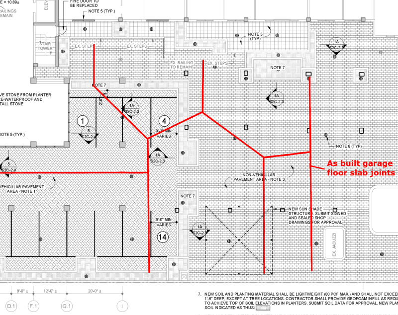

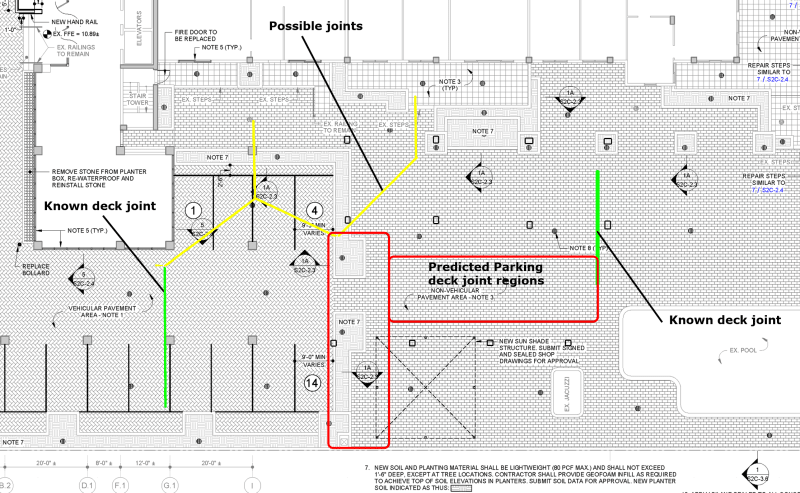

Thanks MaudSTL, you prompted me to make another effort.
I think the Miami Herald infographic is slightly off because it appears to show the joint to the West as a straight line, but I think it actually steps about 2' - 3' further to the West, in the area south of column row 14 (South of the lobby area). This is based on photos that show the joint in the stamp-create aligned with the East face of the columns in row I as shown below:
But the joint in the structural deck appears to be further West than the West face of the columns in row I as shown below:
In order to predict where the joints were in the parking deck and pool deck I looked at the joint spacing in the garage floor slab, because the actual as-built positions can still be observed.
If the garage floor slab joints are overlaid on a drawing of the parking/pool deck they appear as shown below (with parking garage column positions emphasized):
The spacing of those joints can be aligned with features on the parking deck by mirroring the joints and shifting West as shown below:
New version showing regions, due to uncertainty.
The point I am trying to establish is the probability that there was an intermediate construction joint beneath the planter running South to North close to columns on line K, in addition to the two shown on the Miami Herald House of cards infographic.
Suggestions welcome.​

I updated the image in my 12 Mar 22 10:19 post above to regions for possible joints rather than specific locations.

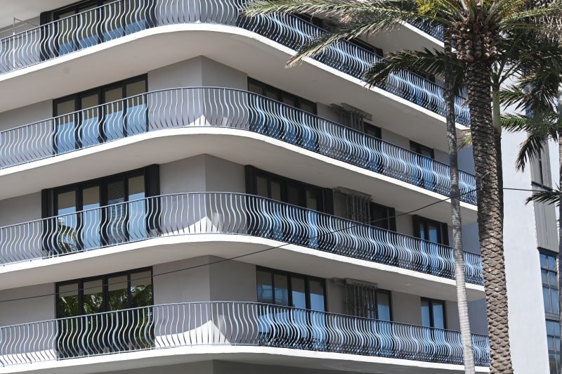

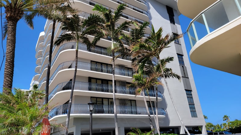

I visited the Champlain towers condo collapse site on Saturday and shot extensive amounts of video and photographs and as I had mentioned on one of my videos back in February about how they added some shoring poles to the Champlain towers north building in the garage and some unit owners closets, now they have added shoring poles on the patios of several units on the building here are some photographs I took on Saturday.
This does not inspire much confidence. Those poles are not there to support the balconies IMO. I bet they finally got around to testing the concrete used throughout. This should be a big deal.
