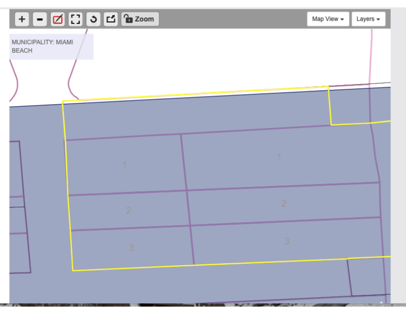

8701 Collins
From Miami Dade GIS Maps
Here is legal description on 8701 COLLINS AVE CONDO. Looks like 6 lots, part of erosion way and adjustments to Blocks 1 and 10, plus 50 ft road closed. Would need to look at plat books, and deeds cited below to see full details. But it appears City Sold Right of Way of Road from this. Perhaps public access is an easement on property?
ALTOS DEL MAR NO 2 PB 4-162
LOTS 1 THRU 3 INC BLK 1 & LOTS 1
THRU 3 BLK INC BLK 10 & PORT OF
EROSION WAY LYG BETW & ADJ TO
BLKS 1 & 10 PER PB 105-62
& 50FT RD LYG N & ADJ CLOSED
PER RES #2014-28608 & 2014-28839
AS DESC IN DECL 31691-1664
LOT SIZE 101179 SQ FT

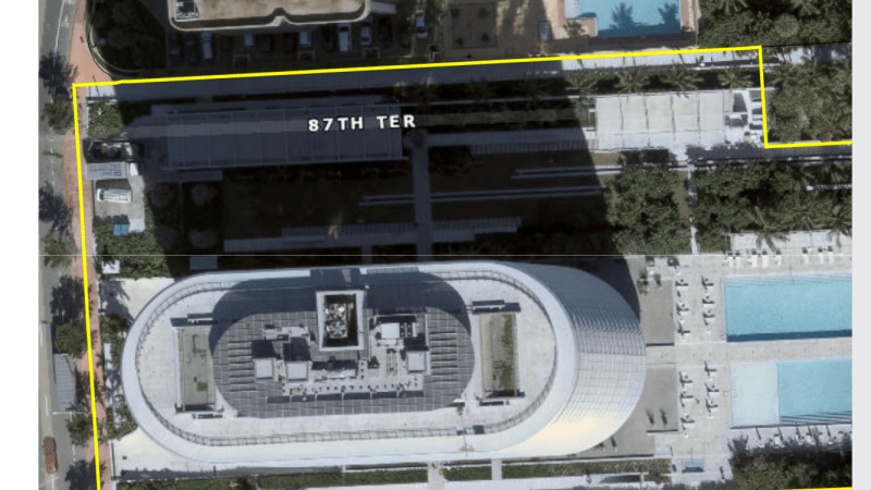

Is the West edge of that property shown in the aerial photo actually running down the center of the sidewalk? So does that mean it has been confirmed that the property line is not the center of the street?
Is that considered good enough for legal work in Florida?
Were all the laws adhered to in the sale of a city street to a private entity?
I seem to remember some of those issues haven't been fully explored in court yet.
Call me skeptical.
Skeptical, The aerial photo looks like property line is running along North edge of sidewalk to me. If you click link and go to their GIS map site, you get a lot better image than that to look at.
In my state, property lines are typically not the center of streets. In plat mapped residential sub-divisions the street Right of Way is say 50 feet wide, but road is only perhaps 30-35 feet curb to curb. The other 15-20 feet are divided evenly on each side of road and are basically used for utilities. So property lines for lots are typically not at curb of street but 7-10 feet past curbs. So you end up maintaining part of the right of way for the city.
Definitely some shady dealings went down, and I expect it to be interesting legal battle.
No. I was talking about the WEST edge that runs along Collins Ave. But then your other image shows the property crossing the city limits into Surfside on the North. Not sure how that works. Really doesn't matter, it's not going to get resolved here.
Looking at Google street view. The width of the sidewalk was approximately doubled when 87 Park was built. The property line aligns closely with the original sidewalk.
