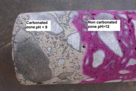

I will be first to admit, my chemistry education ended as freshmeat in College, and had long been forgotten except for times where it affects everyday life like the voltaic cell battery in my autos. I remember as a kid my dad storing a 12V auto battery on a concrete pad outside our home and how it ate the paste in the concrete at a rapid rate and left honeycomb of aggregate and voids showing. From that time on, dad burned in my brain to put a wood board under auto battery to protect concrete. He was mechanical engineer so not chemistry major. Concrete patio was under a cover so not a lot of rain getting to it, but perhaps some in blowing rains.
Interesting short read on "Case Studies Show Galvanic CP Effective on Corroded Reinforced Concrete Structures". Interesting to note that repaired areas create a potential difference between old and new areas and basically cause the cancer to spread to new areas around repaired area. Here is quote below form short article:
"Chloride-induced corrosion of reinforcing steel in concrete is a major problem worldwide. Chlorides can be introduced into concrete through deicing chemicals, seawater, soil, or as contaminants in the concrete mix. This can lead to pitting corrosion and concrete deterioration."
"Localized repairs are often performed to address concrete corrosion damage. When a repair is completed, new corrosion sites can form just outside the repaired area and are driven by the residual chloride contamination and the difference in potential between the steel in the chloride- contaminated and chloride-free sections. When incipient anodes form, further repairs will be required. The patch repair process may be repeated several times over the remaining life of the structure."
Per the link below, it clearly appears we have sulphate attacks where concrete or layers of concrete turned into powered mass. As stated earlier only lab tests of many samples of concrete will conclusively determine if more than one chemical process was going on at the same time, perhaps in different locations or layers.
"Types of chemical attacks on concrete structures per link"
"Following are the different chemical actions on concrete structures
Sulphate attack
Chloride attack
Alkali aggregate reaction
Carbonation
Acid attack"
"Magnesium sulphate also reacts with hydrated calcium silicate and makes concrete into powdered mass." "Concrete with low water cement ratio is less affected by magnesium sulphate while high water cement ratio concrete is highly affected. Sulphate-resisting Portland cement should be used where sulphates are present in the soil, water or atmosphere and come into contact with the concrete."
