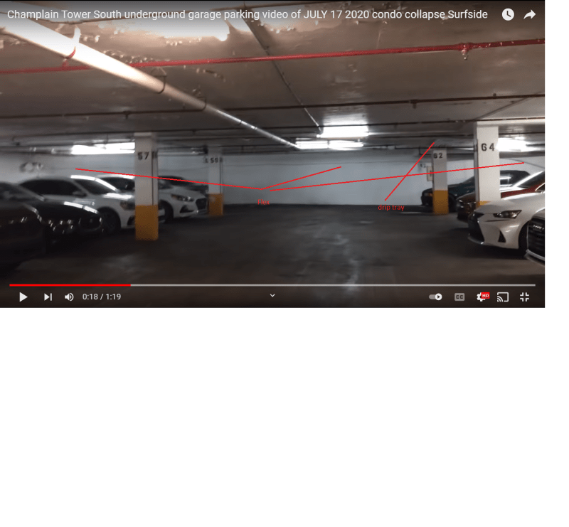

For example here is the flex that is feeding the fan in SW corner. It is running up from low on the wall. And yet again there is a drip tray running over to the wall so the water can track the cable to it's source. If the transformer video image was mirrored this could be the spot but it's not because the escutcheons on the care are correct. So I guess one just has to imagine this in the NE corner. But that would mean water is on the floor there as well. One question is if this fan is 3 phase does, it make sense that the cable would be coming from down on the wall. For example it would not need a transformer. per se. But is it a wet location thing to use one for isolation? Just more dumb questions.
Edit: I just realized that where the flex disappears a bit up high, that three phases could be going to the fan and one phase down to another mystery transformer. There is always a piece missing.
The drip tray looks to be on the near side of the first column away from the wall. And the "flex" is on the wall. Don't see how water from the former could get to the latter.
It seems extremely unlikely that that is flex, anyway. IF it's supplying the fan, it would have been installed by AT LEAST a drug-crazed apprentice, who would have used conduit. 'Cause it's already straight. And easier to pull. And you don't HAVE to pull a ground wire.
I think it more likely that it's a half-assed water line, used for my latest hobby-horse, planter irrigation. There's an isolated planting area just above.
As I mentioned earlier, you can't use one phase of 208 3-phase without a neutral. And there aren't too many electricians who throw in a free neutral when they're supplying a 3-phase motor. I have, but then I'm a thoughtful and considerate guy.

Yeah I saw the tray goes to the column. But I thought there was another frame that showed a tray extending back along the side of the column. Anyway there are so many drip trays if you step through that walkthrough that there are likely more than one resting on a pipe or conduit at a wall. I wasn't saying there is another rusty transformer necessarily or even another transformer here.
If you use 1 phase of 208 with a neutral it would be 120 right? What your saying is you have to run another line with a neutral. And a free neutral would be an "illegal" ground. How would you get 208 to a transformer and why would anyone do that if they could just run 120 separately?
