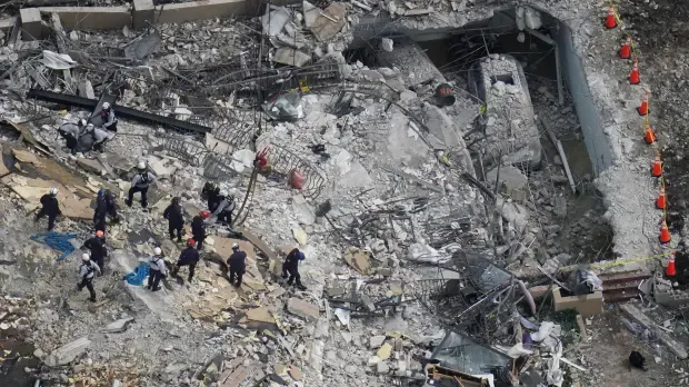

[URL unfurl="true"]https://res.cloudinary.com/engineering-com/image/upload/v1644871599/tips/APTOPIX_Building_Collapse_Miami_53686_sq37ov.webp[/url]

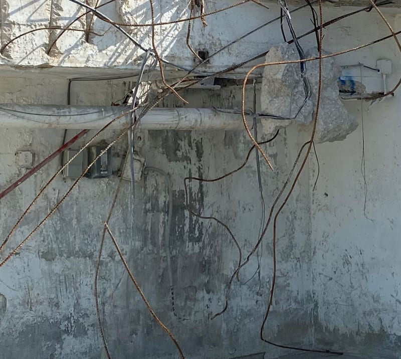

Edit: Another pic... Flex, wires and some boxes but no pipes or transformer.

Edit: I had not seen your photo yet. Wow. Transformer could have been knocked off the wall. Not as protected by overhang.

All the old conduits didn't survive site cleanup so there is nothing to follow to try and understand what the intent was. There is no way of guessing how many changes were made or why over the years. The only conclusion I have is that the average person has no clue how to take a decent video. Closeups don't show the big picture and most people pan way too fast.

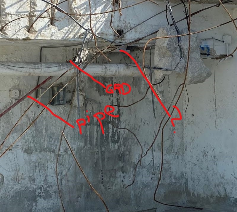

Red pipe is likely fire sprinkler, question mark could be exhaust fan inlet but not sure. Grd, no idea.
Edit: red pipe is definitely fire sprinkler. It's Kilsheimers pic #0295 if you want to zoom in yourself.
Yeah, That's good. If nothing else to note, that rebar looks pretty rusty.

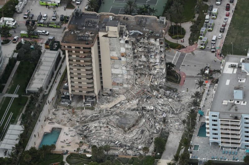

Definitely could be connected to an exhaust fan >>
NE corner shows an overturned fan in the grassy area.

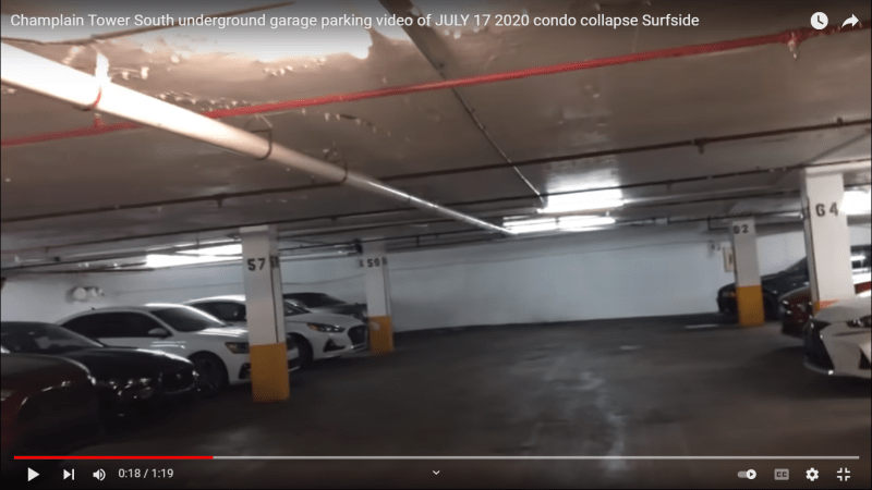

No much point to it other than trying to get a different glimpse of the pvc plumbing. Was it draining any outdoor deck exposure? I have to look at the whole walk-through again. BTW I think condensate is be pretty corrosive similar to DI water. It might not strictly fit "corrosive" but it dissolves metal over time and creates it own chemistry in the process. But salt would be worse. I think. I just don't think condensate would create the corrosion that is on that transformer. I have condensate running into my pitted cast porcelain deep sink and I don't see rust.
I am leaning towards apace 82. I don't see that small step curb at the perimeter.
Edit: except there is no wall in front of 82. Are we sure that transformer is in CTS? lol.

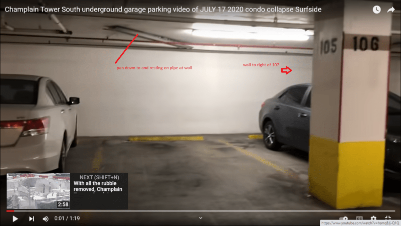

Slightly interesting. The catch pan leads downward to a pipe of which I don't know the purpose but it looks grey. spot 107 has a wall to the right of it. So it fits the transformer video. I mean what are the chances of finding a deck drain pan leading to a pipe that could (maybe) lead down to the transformer - assuming this is the location of course. One of the conjectures made by Ostroff was that water was simply following the pipe. There are still huge unknowns, but what are the odds of even finding this? I've had about enough of it though.
Edit: If I am not mistaken this catch panel is under the front driveway and the room on the other side of the wall is under landscaping. So this is not related to the collapse, other than to say well there were leaks the front also. But that was already commented on by Ostroff when he voice tracked the walkthrough I believe referring to where water was found on the floor. If anything I can't quite figure why there is much water coming in from the from front drive because it has cover. Or am I all wet? Is irrigation water running onto the drive?
Edit2: Ostroff noted the catch pan also and the water below it. I just happened to notice there was a wall beside space 107 which makes it fit the transformer video. It doesn't prove the audi in the transformer video was in spot 107. And I can't really see how the things in that video are on the wall in the walkthrough video, because there are no facility connections coming down the wall that I can see. So it's probably not there. I'm not saying that it's there.
