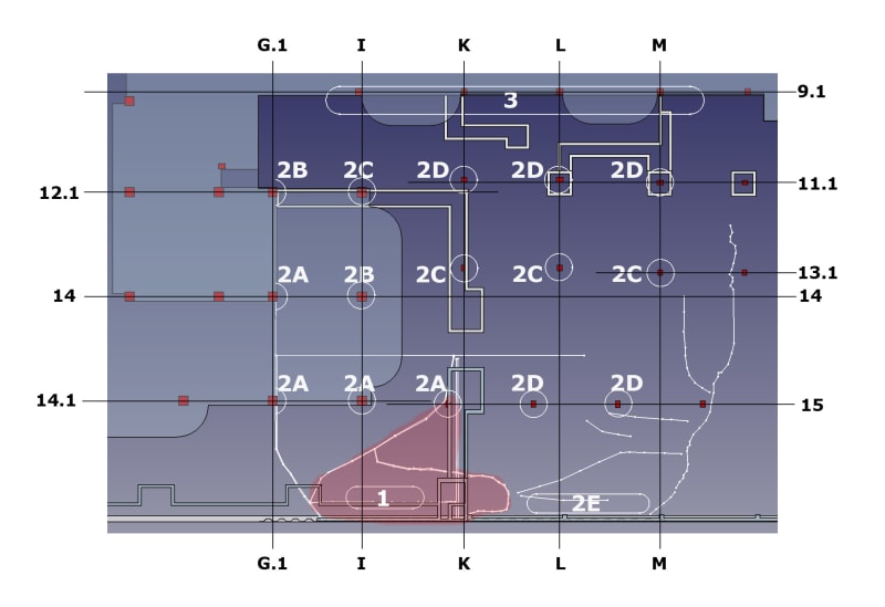

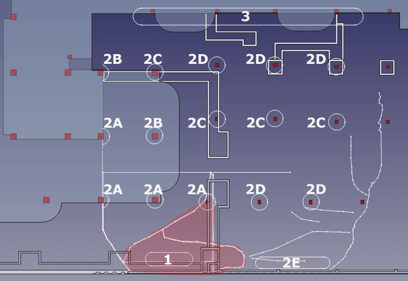

Here is a diagram indicating what I believe to the approximate sequence in which elements of the parking deck, pool deck and building support columns failed.
The positions of most of the cracks in zone one are taken directly from photographic evidence, but some are inferred.

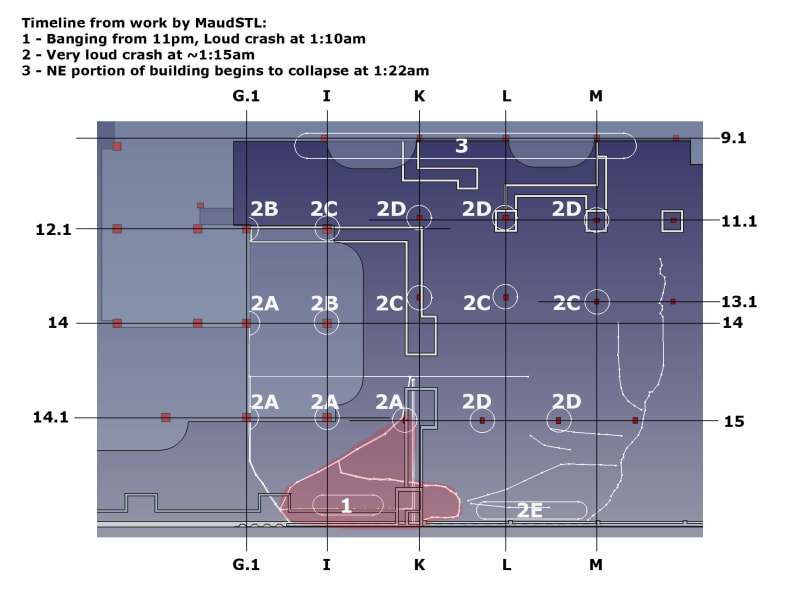

With reference to MaudSTL's timeline summary posted on 3 Feb 22 17:50.
I believe the failure of zone one occurred relatively slowly and agrees with timeline item 2 (banging heard from 11PM onwards increasing in intensity) until the southern extremity of the deck detached from the wall. That could coincide with the loud crash described in timeline item 3. I believe that area of concrete was very degraded and could explain the dust.
I believe the collapse of zone two occurred fairly rapidly due to the forces involved as an increasingly larger area of the deck begins to fall. This could likely coincide with the very large crash described in timeline item 5. I have added a letter suffix to indicate the relative time of the collapse. The progression is generally from south to north but the collapse of the eastern region is delayed slightly until it finally reaches the wall at 2E.
I'm interested to hear comments. I can explain the sequence in more detail and I still need to explain why some areas of the structure are exposed to more salt than others.
Suggestions welcome.​
Good start on graphic depiction. I would suggest adding column labels from original CTS drawings to make discussions of a particular column easy to reference. Perhaps add legend with timeline events to label those on drawing as well. One graphic could tell a lot of story.
I am interested in complete decay theory in Zone 1 causing loss of steel grid or concrete deterioration in that area.
Also interested in your vibration resonances leading up to further delamination and punch shear readiness.
More description of what is happening on time clock at each column or area would also be inciteful.

IanCA said:
@thermopyle2.1 Let's keep going.
I would like to see construction joints noted in different color on your graphic, perhaps a dashed yellow line? The one on East is not shown, however it appears the white straight lines that cross at K15 are construction joints?
I have a hard time following flow of progression from 2A. I would like to see notations beyond 1,2,3 A,B,C,D like .column labels thru .column whatever extensions showing progression flow at each involved column. I clearly see spread for example from 1 to 2A, but as to why different pieces fall in sequence beyond that, it is nor clear. I think it takes narrative to go with picture and perhaps photo thumbnails referenced to logic to tell story.
Good work and I hope you continue with your attempt at explaining the puzzle.
Agreed, that would be a good addition, but I'm not sure about the locations of some of those construction joints. Do you know if there is a drawing anywhere showing them, please?
Yes, the narrative is important but it will take me some more time to put it together.
All I have seen is the construction 🚧 joint section view in the original drawings. I have not noticed locations of joints identified.
