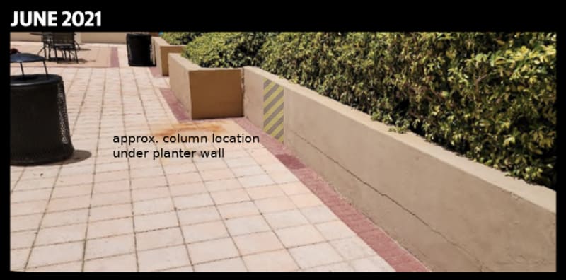

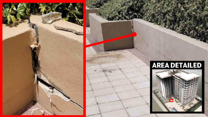

Less than a month before Champlain Towers South collapsed last June, the building manager noticed something that made him pause on one of his near-daily walks around the property: A large horizontal crack, maybe 20 feet long, had formed in the planter along the western edge of the pool deck.
So he called a structural engineer working for the building to come check it out.

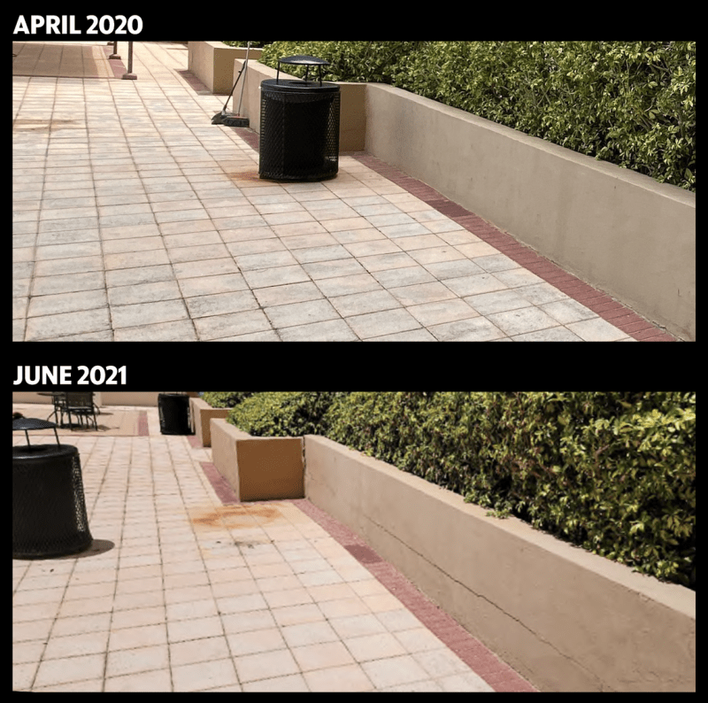

The long crack hooked upward on one end in a gaping vertical fracture as if the planter was being torn apart at one corner, photos taken during the June 8, 2021, inspection and included in court records showed. The concrete-block wall on one side of the vertical crack appeared to be about an inch lower than the other, as if part of the planter had started to slump into the garage below.
The planter itself did not play a role in the building’s structural integrity. But the dramatic change in the height of the wall on one side of the vertical crack suggested the structural slab below could have been starting to fail a possible canary in a coal mine warning of the deadly collapse that would happen on June 24, six structural engineers who reviewed the photos told the Miami Herald.
A cracked planter alone isn’t enough to cause major alarm, the experts said, but the slab nearby had been showing signs of distress for months. Photos exclusively obtained by the Herald show water had poured through the slab, cascading down a column supporting the pool deck just 20 feet from the planter. The file names suggest the photos were taken in November 2020. Josh Porter, the president of Punta Gorda-based Consult Engineering, said the photos from November were already “evidence of imminent collapse.”
“This building was definitely screaming that it was in dire straits,” said Porter, a structural engineer who specializes in restoration of high-rise condo buildings.
His concern was more than water damage to the column.
The amount of water streaming down it was a sign that the slab was already severely cracked around the top of the column, Porter said. It looked to him like the slab might soon break away from the column supporting it. “Most engineers would say this is a serious problem: Part of your pool deck could collapse,” Porter said.
The crack in the planter months later suggested the problems in the pool deck slab had likely worsened, although more inspection was necessary to be certain the two problems were linked, the engineers consulted by the Herald said. Although it’s unclear exactly when the problem in the planter started, a photo dated April 20, 2020, shows no vertical displacement between the two planter walls and no cracking at all. “That’s a lot of movement in one year,” said Florida engineer Nestor A. Cueto of Miami-based Cueto Engineering. “If it was noted that significant movement of that area occurred after the previous inspection, that would be a cause for additional investigation.” Cueto, who performs 40-year inspections, said that given the other problems in the basement, he would have also requested temporary emergency shoring while simultaneously investigating the underlying cause of the crack. The town of Surfside requires a permit to place temporary shoring, which generally involves positioning adjustable, steel support jacks to relieve some of the pressure on weakened structural elements.
A spokesperson for the town’s building department confirmed no permits for shoring were taken out for Champlain South in the month before the collapse.
On June 24, just two weeks after the cracked planter was discovered, the slab broke away from the columns a type of failure known as flexure-induced punching shear that the engineers told the Herald was both predictable and likely preventable based on what they observed in the photographs. The planters and pool deck crashed down into the underground garage below, kicking off a chain reaction that resulted in the collapse of most of the 12-story residential tower. Ninety-eight people died.

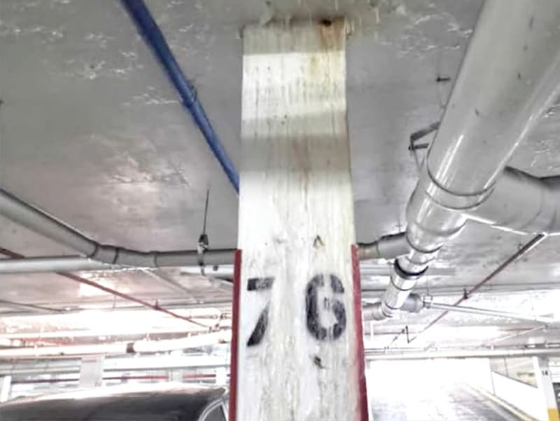

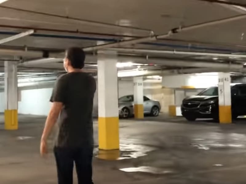

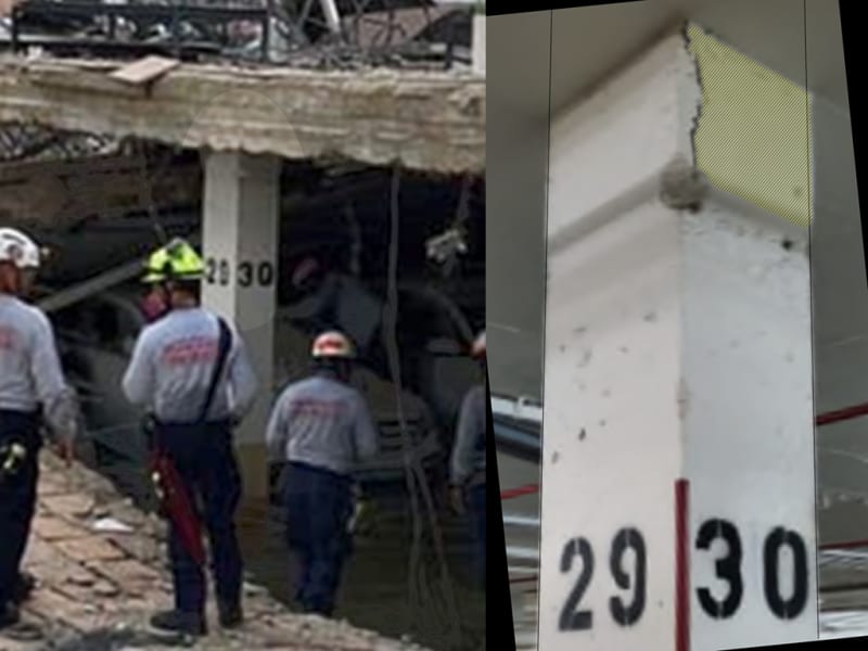

In November 2020, Stewart, the building manager, was touring the underground garage with someone from Morabito’s engineering firm. It had just rained, Stewart said. And, as usual, puddles covered the floor, proof of the failed waterproofing on the pool deck, which Morabito had noted was causing “major structural damage” to the slab. In one report, Morabito said urgent repairs were needed to prevent the problems from becoming exponentially worse. That day, the engineers focused on an area around one column in particular a 12-by-16-inch pillar of concrete painted with the number 76, demarcating a parking space in the middle of the garage. Photos taken that day showed water streaming down the column, causing the paint to run and sediment to build up at its base. “We were trying to figure out basically where the moisture was coming from,” Stewart said.
Other columns around the garage were sometimes wet, mostly from leaking pipes, the manager said. But column 76 was by far the worst. One engineer who looked at the photo for the Herald called it a “waterfall.” Stewart said Morabito’s team snapped the pictures of the column and slab above it to include in a bid for the upcoming concrete restoration process set to begin the following year. But if they had more immediate concerns about the structural integrity of the area, they never told Stewart.
They took the pictures and then did “nothing” more, Stewart said. Morabito made no mention of the column in any reports to the board reviewed by the Herald. “It’s shocking,” said Aghayere, the Drexel professor. “This column was almost crying out; it was the structure crying out saying ‘fix me, do something about me,’ ” he said. Knowing that the structure was poorly designed, with almost no redundancy, Aghayere said the problems documented in the photographs that day “would have scared the daylights out of me.” “I would have shored it up with a goal to evacuate the building, knowing what I know about the structure and how it was designed,” he said.

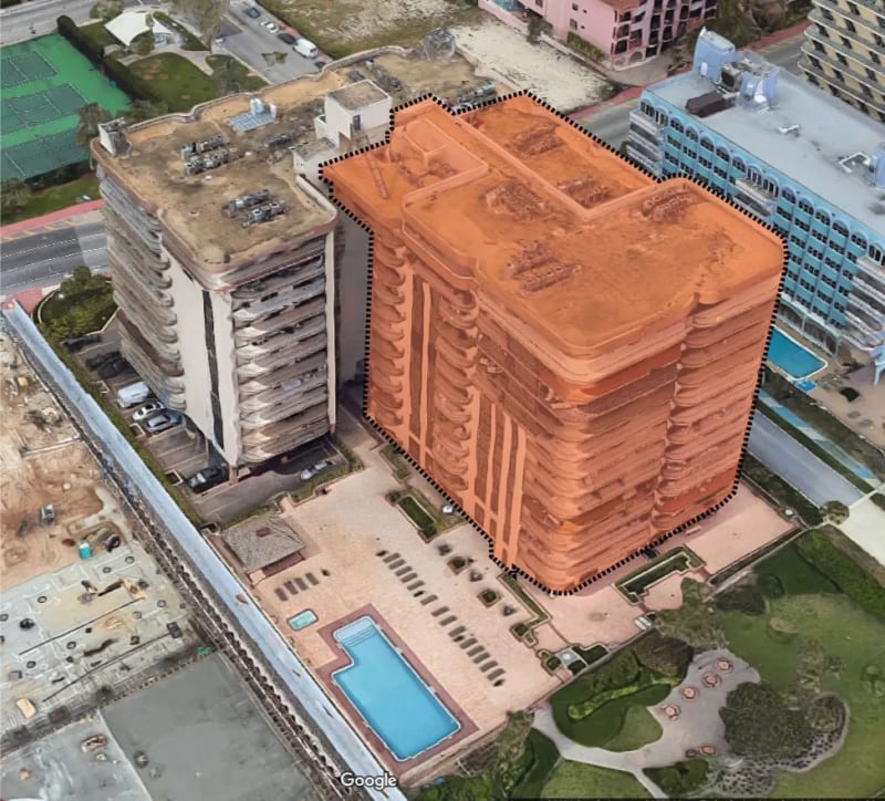

The western half of the pool deck, which caved-in on June 24, was held up by narrow columns placed up to 30 feet apart to maximize parking space in the garage below. It was a flawed design that left the 9.5-inch concrete slab cracking and bending under its own weight from day one, computer modeling by Lehman, the University of Washington researcher, showed. The building designs had originally included beams to support the planters from below, but they were removed in the final drawings, leaving the slab and columns alone to support the boxes of heavy wet earth.
Over the years, pavers and sand were layered on top of the original tiles, permits show, adding more weight to the overburdened deck. Roots from the planters penetrated the slab and cracked drain pipes causing water damage to the concrete and reinforcing steel bars within it, records show. Post-collapse photos show the connections between the slab and columns did not contain all of the reinforcing steel that was called for in the plans, reducing the strength of those critical connections. Photos also show damage and corroded rebar along the deck’s connection to the southern perimeter wall, which experts said played a role in the overall structural stability of the tower. In a well-designed structure, experts said the localized failure of a pool deck should not cause the collapse of a whole tower. But at Champlain South, the design defects, construction errors, damage, degradation and poor maintenance came together in a perfect storm leading to one of the deadliest collapses in modern history. It began when the deck collapsed at 1:15 a.m. Columns punched through the slab, which disconnected from the southern foundational wall. After losing that critical connection, computer models showed damage propagating into the tower.
But missing from the public understanding so far has been what initiated the collapse. The collapse could have been triggered by column 76 suddenly punching all the way through the slab, as it had apparently been threatening for months, engineers said. Or, they said, some failure of the connection between the deck slab and structural perimeter wall or elsewhere could have triggered the punching shear at column 76 and across the western pool deck. “Are we ever going to know what the very first thing was? I doubt it,” said Porter, the Florida engineer, who has studied the collapse extensively and posts his findings on a popular YouTube channel. “Whether [column] 76 happened before the south wall failed, or vice versa, you’re going to end up with the same result.” Regardless, if the connections between the vertical and horizontal elements of the structure had been stronger and the columns had never punched through the pool deck slab, it’s possible the deadly collapse of the tower would have never happened at all, engineers agreed. “This could have been prevented,” Aghayere said.

There are photos taken about a month before the collapse showing severe cracking in the planter by the parking deck.
Those photos are incredible. I can't recall that ever being seen widely such as on this form or previous links. that could be the early predicate of a E-W catenary. There is a sudden step change the deck height from that point east. The long crack going north has not dropped much. So the entire progression *to* the S perimeter and step beam may have happened over weeks. This might argue that the deck started to collapse well before the wall disconnection. Unbelievable that this photo was not widely seen until now...nor witness statements about what it shows.
Thank you, stcbus! My, Morabito must be glad his insurer has already settled; this piece really nails him. I wonder if criminal charges are under consideration…is that even possible?

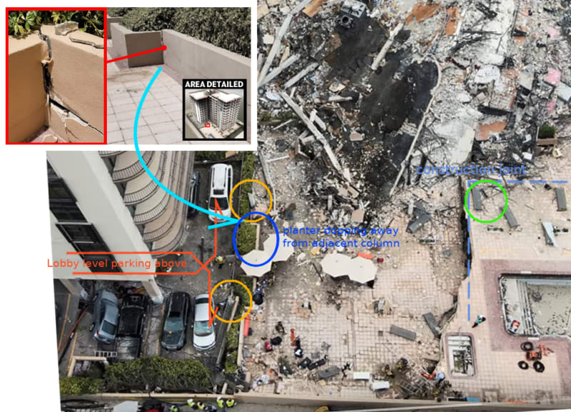

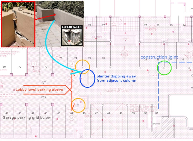

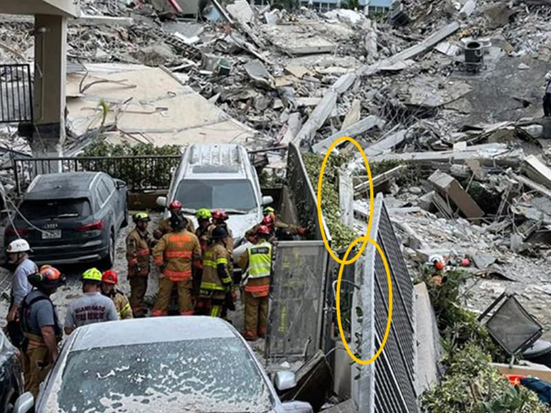

>>>Edit: Yes, we can thank Jinal Doshi of Structural Madness for identifying this area long ago. Here is his video, which he posted around August 2021.
So thirteen (my bad) sixteen days prior to collapse, Morabito photographed the cracked planter.
Even more telling is that the crack in the planter is absent above the column upon which it sits. This would indicate that the punchout is in progress.
Markup transferred to aerial
The remains of two columns supporting the planter in question.
Meanwhile, I was looking at the 29/30 column. The damage previously photographed was either repaired or did not progress through to collapse.

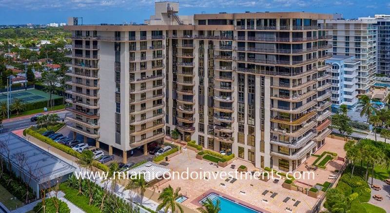

Never mind, I got turned around. The colored tile probably leads to the hot tub and is probably under the pavilion in the overhead photos,
My apologies to the MH
In this MH photo in 2020 we see stanchions and colored tile.
In this USAToday photo we Don't see the colored tile, we see paving for parking leading to the vestibule of the office.
I think the MH miss located the planter in their photo.
No they didn't
Please see "area detailed:
from a real estate site:

How many feet from this sinking deck is the weight of a vehicle being placed? Maybe 5 feet? It's not the first thing I thought of when I saw this. So this is essentially a parking deck at this point. How can anyone not see that as the punch at the nearest column on a deck that is supporting cars and trucks next to it. Isn't that what it really is?
I am guessing you are referring to the progressive punching of the deck to the east beyond this planter located column. as in why didn't the planter just fall through and be done with localized damage? Yeah, Josh I believe in the article said you must run right down to the basement there and look up. The next question I can think of is if he did that where is that photo? So we assume I guess he did not. That photo would largely answer your question. Pavers are hiding the answer on top.
What I meant to ask is, how did the column punch through with the planter wall sitting on top of it? Did the top of the planter rotate west? If so, did the deck break before thee punch through? Or did the top of the column shear, and lean east, allowing the planter wall to fall?

Miami Herald said:
... the engineers focused on an area around one column in particular ... painted with the number 76 .... Photos taken that day showed water streaming down the column, causing the paint to run and sediment to build up at its base.
Column 76 is the next column east of the planter column. This suggests that two columns have at least partially punched through. This is where Josh's (edit: Building Integrity @ Youtube.com) theory of tensile forces comes into play. A significant area of slab that should be resting on columns is now suspended as though it were a tightrope and is pulling on the building to the north and the south perimeter wall to the south (not to mention east/west). The idea that the south perimeter wall let go first is nonsense.
Column 76, center foreground. July 17, 2020
recently from Miami Herald (photo taken Nov 2020)
Miami Herald said:
“We did a property walk almost every day for safety of the property,” Stewart told the Herald
The property owners were in on the problem. Likely, they couldn't commit themselves to vacating the property unless "told" by an authority to do so. Though unfortunate, it is part of the human condition.
