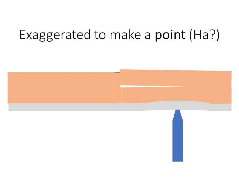

Seriously, the planter wall has an upper and lower part, the upper part having a greater stiffness than the lower. The lower part moves with the sagging floor while the upper part remains stiff as a beam supported on the column (south) and the slab (north) which we may, for the sake of argument, presume doesn't move much as it is close to the next column to the north. The portion of planter which breaks away south of the planter column (75) sits solely on a portion of slab which is presumed to sag and/or alter it's form due to degradation.
An inch or more of separation is breathtaking but it doesn't defy basic physics.

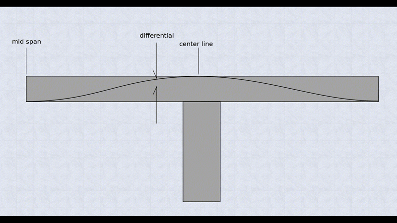

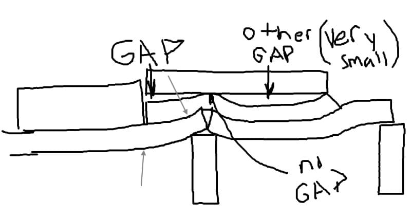

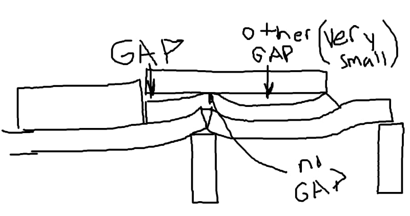

Just saying cracks could be located where 'Grey' arrows are on the toddler diagram, which is the longer span side of column, thus primarily affecting one side more than the other?
Actually, I like the drawing by Sym P. le (Mechanical) 17 May 22 18:54 better than power pointy...
It's when engineers start sketching on the backs of restaurant placemats that breakthroughs are made...
