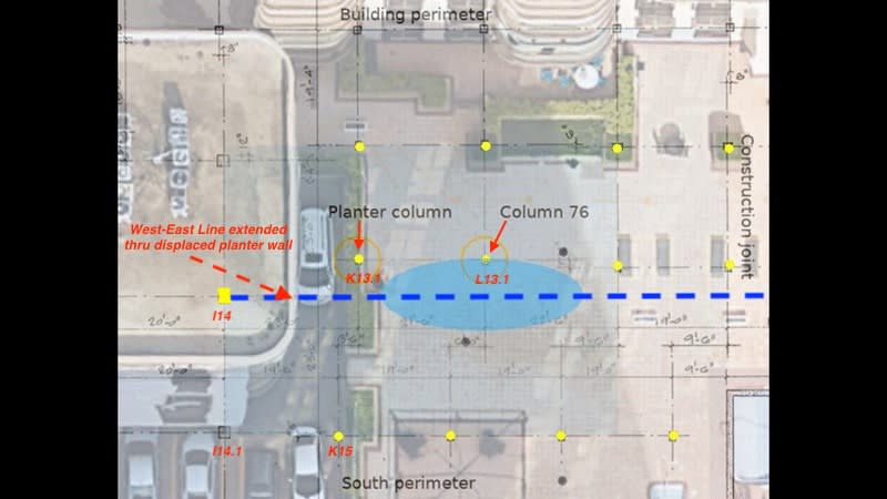

Even though I know I can not 'add value' to a SymPle GIF, I thought I would try, while we wait on SF's PowerPointy.
What I am trying to show is correct column labels on some of the columns of current interest, and that the center line of the slab running under the planter 1" drop aligns with Column I14. And Not I14.1 as I incorrectly stated earlier, and that Column 76 is L13.1, unless I made boo-boo, as I have not received the "color between the lines" class yet.......

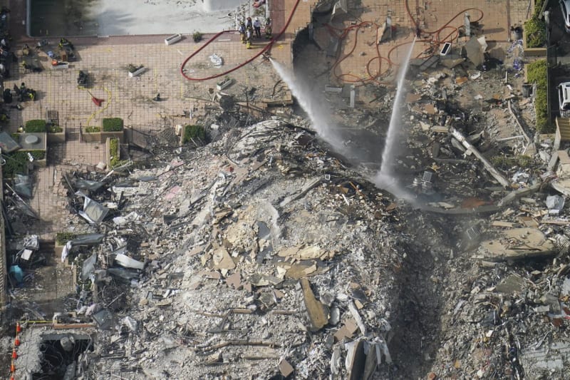

I am wondering how the planter wall reinforced top made it over the trash can without wiping it out. Then I am imaging it was held up for a time by the column. It looks like the piece of wall top that would have smashed the trash can is rotated 90 degrees. Perhaps that portion was hanging down when it fell from the column. Not that it has any bearing on anything. Just trying to make sense where there is none.

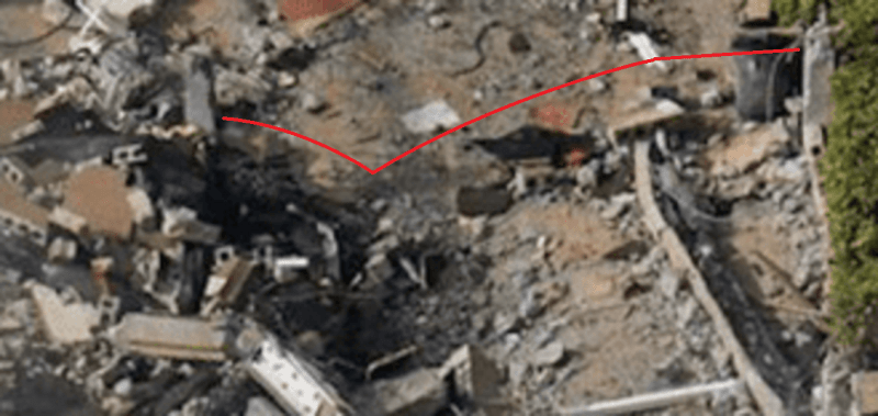

Is there an east-west construction join that runs through the corner of the plant where it cracked? It looks to me like there is a demarcation in the fallen deck where the deck south of that line is higher and maybe even resting on the north section. I thought all the construction joints were N-S. I don't know how you would explain them overlapping, so maybe they aren't. But the south seems to be resting higher along that line. I see this without playing with pixels.
Edit: suggested in this photo (tight crop from a WSJ photo previously posted)
Note the garbage can for perspective. pavers and deck south of can relatively planar and undisturbed. Trash can sits at a level a step below. Pavers north of this line are disarranged and deck is desk DIS- continuous. Does it mean anything? Don't know. There is tower debris encroaching from the lower left. did the falling debris cause this fracture to propagate? All an illusion? Time for my pills now.
The image is so blurry I can not make out the garbage can. I went to WSJ, and grabbed the image below. Is the first image, the WSJ photo you perhaps took a screen shot of? Your thoughts are interesting, but I am still processing.....
Clearly in the second image below, now that I have high resolution from WSJ, I can see the diagonal break in parking deck that is either radiating towards the trash can and dropped planter, or radiating from?

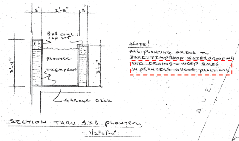

Did anyone else notice that the planters were to be water proofed in 1979, however "weep holes in planters where practical" ? In detail posted by IanCA.
GREAT way to keep that structural slab soaked around the planters...
that's it. I didn't modify the pixels. I just enlarged the image and cropped off what was not of interest. Now if simply saving a png format image readjusts it, I don't know. There are areas (more than one) of fallen deck that are essentially quite "planar", with the exception of localized punch points and the major trough there in the middle. The line I drew is where there appears a more significant break from any hint of planarity. Debris from the fallen building does not help to decipher it. You can see the angle of the sun better in the full WSJ image to see where shadows would be. When I said I could see this line without adjusting pixels I was looking at SFCharlie's AP images several posts back in this thread. I just think this image was more useful because it's more oblique to the deck even though it's quite grainy at this level. The date of the WSJ photo would help but from what I can see things are in the same state. A side by side comparison would help also.
Edit: About the second image with diagonal break. I realize that was identified as significant by several posters recently. I guess the question is whether that is what is propagating all the way out and near column 76. That's the gist of what I am trying to ascertain.
edit again: Weep holes. I saw that. Where practical? That must be with foresight of the drains clogging after a month of use. Actually not too bad of an idea if the deck would be adequately sloped. And that turned out not to be the case. Are the drains bigger than a weep hole for long?
Do you expect a problem with weep holes that drain from a potentially waterlogged planter onto an exterior deck that is, on occasion, afflicted with rainwater?
I suppose you might if you assume incompetent construction methods. But then, the AHJ would catch that, and require correction. Which, of course, the City of Surfside did.
Or not.

Gotta find every satellite photo available to see if the wet spot on the deck expanded towards 76. It's a mystery how a column head got to be the low spot. A mound should form above the column during the punch shear process, hence the leaks should be between columns or at least a few feet away from them. Also the slab directly over 76 also could not have dropped far without popping out the pavers above it.
Maybe there was some odd internal voids within the slab causing this? It almost points back to the delamination theory.
My concern with that statement is the uncertainty. To quote Jeff Ostroff "If you don't tell the water exactly which route to take, it will take the most expensive".

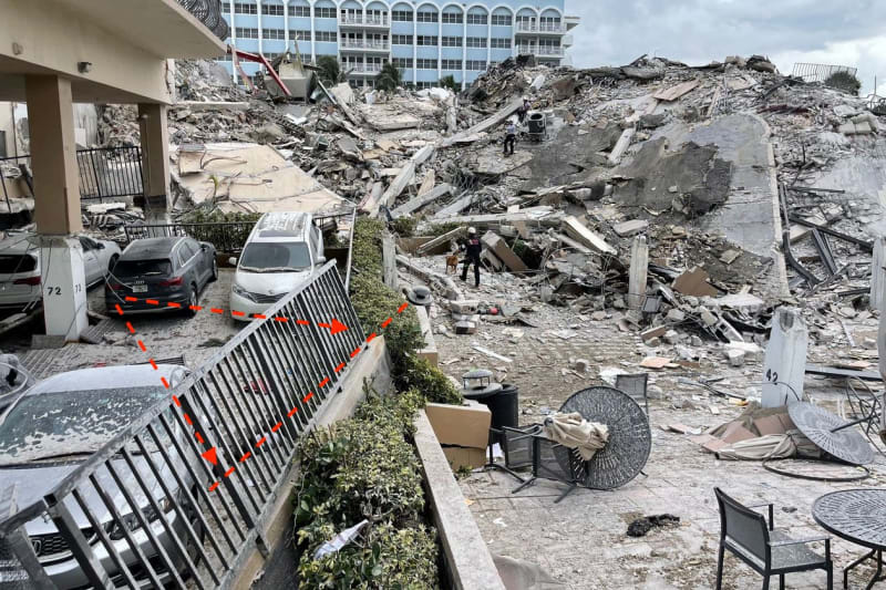

I appreciated your photo because it was from a different angle. together they could give us 3d info.
Please remember the cars under the deck supporting it in odd ways.

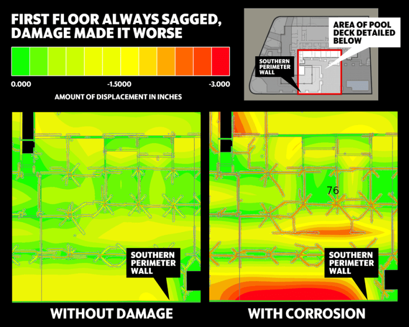

I overlaid the displacement and cracks graphics from the Miami Herald. Cracks from the central puddle are leading to 4 different columns, including 76. Assuming the cracks somewhat resemble what is shown, the water would have a potential path.
Excellent work, Reversebias.
Interesting to note the linear E-W crack in bottom of midspan depression, that lines up parallel between the column lines, thus the planar crack line that Zebraso was seeing in his Pixelizations......
The Planter roots could have made their own path for the water in the depression also...... after they clogged the drain lines in planters....
