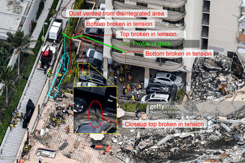

Here is an image that combines a few different ideas:

SFCharlie, thank you, I'm very pleased to hear that. Please let me know if you see anywhere I need to make any adjustments or improvements. Would a new sectional view through the garage at the parking deck with more detail be helpful, do you think?

With IanCA's latest Visualization tool, I am trying to understand the possible implied sequence of events. I have added numbers at end of his arrows trying to understand perhaps an implied sequence of events.
It appears that perhaps step one is the E-W cracking of slab under parking deck planter North side wall, causing planters to roll North, and at some point break the water cooler line and sprinkler lines.
Which then causes deck to retract at 2a and causes tension break in the top of the slab at 2b at same time.
It would appear initially, the E-W rebar just north of the 2b break is temporarily restraining the E-W and the N-S rebar load, and transferring the load.
The loss of N-S tie to wall plus shifted loads causes the complete failure at 3.
Since their is a relatively small liner rectangle of parking deck slab retracted from the South wall, and the area under planters is where concrete and rebar disintegration are worst, there is more powdered concrete in the air at south wall break, when rest of parking deck collapses and creates a high pressure blast of air to blow the heavy dust concentration out and onto the exposed South Wall of broken parking deck Planter, and Pool Deck Pilaster.
Parking deck drops to the West at Same time as to the North, and breaks around pilaster, thus forcing dust cloud out in only one direction, which is towards south wall break at wall?
IanCA, obviously you have deeper thoughts and perhaps you can fine tune this attempt at understanding your Imagine Tool Provided.

@Thermobaric Thanks very much for analyzing the information and contributing to our understanding.
If you would be willing to upload a version with numbers we can be sure to use the same reference.
Yes, I think so, although I am not yet 100% sure which way that crack propagated. Although I think it more likely propagated from the West to the East because in that way the crack is moving further away from the Southern wall and increasing the volume of less well-supported concrete. In that case, the crack is diverging from the wall. I think it is less likely the crack converges with the joint at the wall. Also I see the corner of the pool deck collapse that is bounded by a curved fracture centered near the column as the termination of that phase of the collapse. Please see below:
I see what appears to be two PVC pipes (supply and drain?) along the pool deck side of the wall between the pool deck and parking deck leading to the water cooler and it appears the water cooler was included in the area associated with the early part of the collapse. The supply line could have been broken at that stage. As the pipe was breaking there probably was some water jetting out, but I expect that soon developed to an open pipe with a fairly well-organized flow, such as from a hose. So I think the chances that water would be entirely responsible for the dust sticking to the column as suggested by Nukeman948 is relatively low.
Yes, agreed.
That is a good summary, thank you.
"relatively small liner rectangle of parking deck slab", I estimate the size of the area of slab that detached from the wall is about 30 feet East-West by 10-15 feet North-South. My original estimates for the weight of that volume of concrete (structural and stampcrete) were above 40 thousand pounds. Is that a reasonable estimate, I wonder?
"there is more powdered concrete in the air at south wall break". Not only in the air but I suspect there was a large ammount of dust in the debris on the garage floor.
"onto the exposed South Wall of broken parking deck Planter, and Pool Deck Pilaster". Exactly.

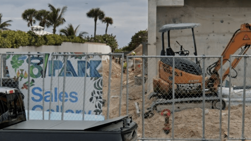

When 87 Park was built, the pavement was removed to the south of the parameter wall,
Here is an image I found that gives some idea of the work that went on adjacent to the CTS Southern property line wall.
IanCA, I follow your logic on the West to East diverging progression of the possible initial break under North Parking Deck Planter wall, and feel the tear at the East end that you illustrated in the pool deck, is consistent with that being a temporary stopping point of initial collapse propagation. And of course we have a HD Diesel Truck sitting near that possible initiation point, at the time of collapse (perhaps more than double the 'fly spat' car that landed against it?)
Edit: I added image I omitted to post, with the sequence numbers above annotated.
