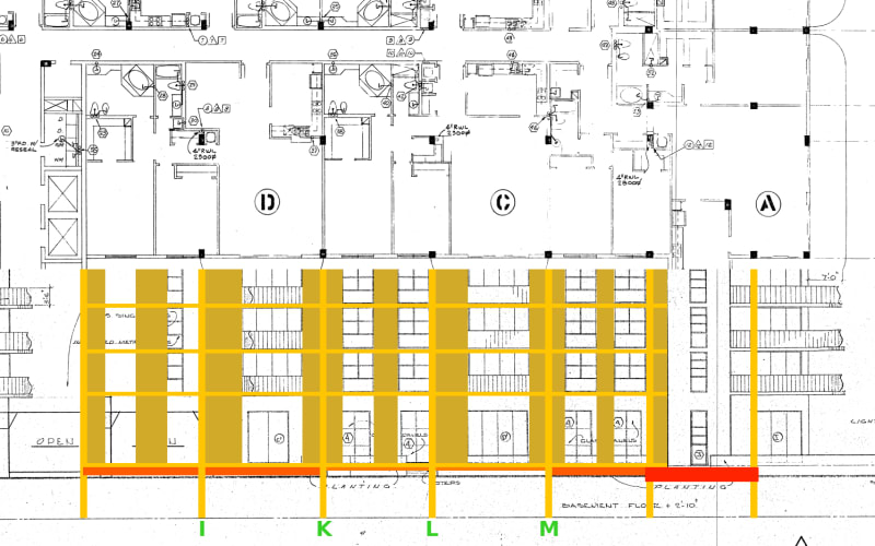

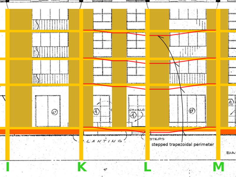

A refinement to my trapezoidal failure theory earlier in this thread (26 May 22 07:20):
The concrete block infill along the building perimeter will not allow the slab to slope in that region, thus, at the perimeter, the slab can only slope beneath the less rigid glazed sections. The effect on the view from the Ring cam is that the credenza will sit level while the farther regions are free to slope, which could explain why the cam is not in plane with the kitchen counter top, even in the first frame.
A further implication is evident in the collapse sequence from the Park tower. At Column line M the failure is distinctly different on either side of the column with the west side dropping precipitously while the east side merely droops, at least initially. If the slab steps (from the pool deck to the interior slab) are considered as lintel beams, there is minor additional support from line K-L and L-M, a 7" step, while on either side of these, the step is 1'-6" offering much greater support.
If Column L buckles first and M is still stable, the thin lintel and block infill could create a condition where the slab suddenly shears off the west side of Column M leaving the column to continue supporting the structure to the east, if not only for a few moments. In the collapse video, it appears that Column K fails in near tandem with column L but Column M is delayed.
Profile showing column locations and CMU infill (darker) and perimeter step/lintel support (red/orange)
CMU infill causes perimeter slope to be stepped in the event of column failure (red line example)

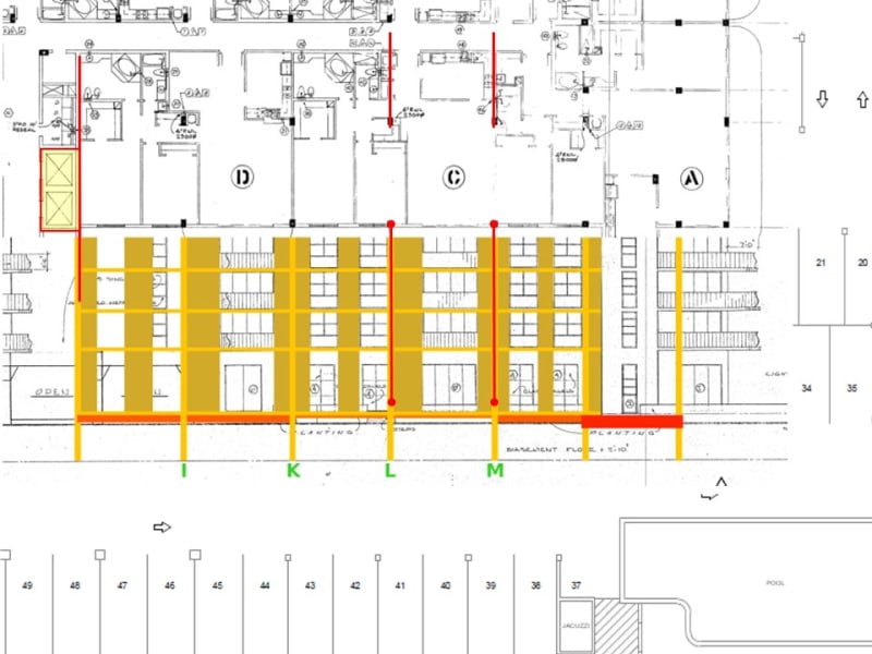

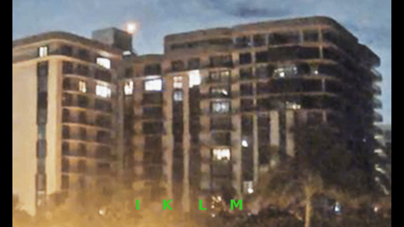

Sym P. le what I notice in your GIF when holding my mouse on lower floors vs upper floors is that the top 2 to 3 floors drop a greater distance in same period of time as the lower say 10-11 floors do.
Clearly if you adding some floor lines to your GIF, I believe it would show this accelerated rate of drop on upper 2 or so floors vs rest of floors below.
I think I see the slight lag of M column line as it tears away from Easter portion of building.
Perhaps because the drop between the two frames is one and a half floors it gets confusing as to what is being seen. I think I see what you're looking at but when I look closer it just seems illusory.
Illusory or Science? From my memory the 13th Floor Penthouse was very open floor plan with long slab spans, and I believe the 12th floor Penthouse was similar as compared to the 11 floors below. So less Block In-Fill Walls, and longer spans between columns.
Thus, are we seeing the top too slabs hinge back (North) a greater distance, in same time period, due to Trigonometry of the longer un-supported slab spans from outer column line to the next column line North?
Please don't get ahead of the video, so many frames passed in between the two hi-res frames we have!
(I have removed the repeated frames of the twitter i{hone vid.)
I can see the parapet wall at the 12th story roof line, appears to roll backwards (North) a lot more than the 13th floor roof parapet, along KLM stack, while the Column line between K and L for the 12th and 13th floor, buckles outward at the 12th floor roof line

Sym P. le said:
Just one of those things that has no other explanation.
Please consider the explanation above.
Thanks for your work on the drawings.
