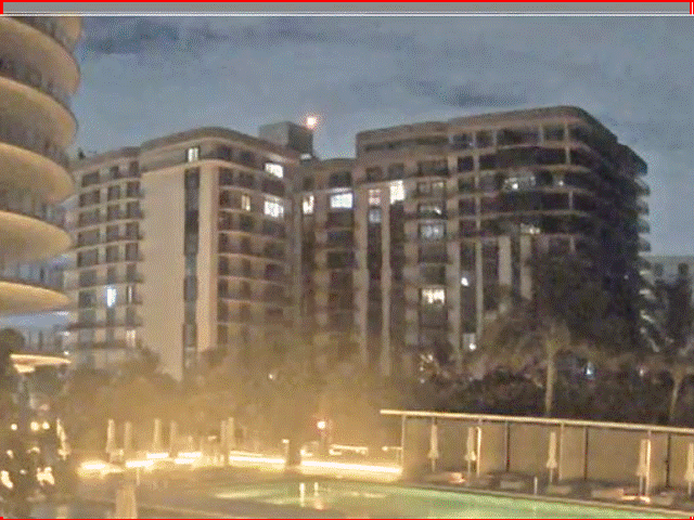

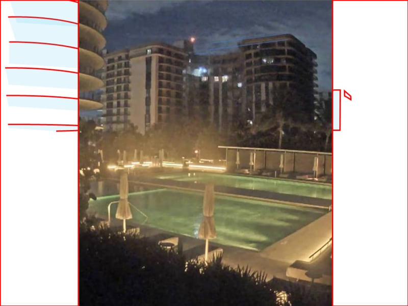

Using two NIST slide images, it's clear that the x11 stack drops with column lines K and L (I think L leads the way). The whole east wing of the building appears to twist grotesquely as the collapse is initiated.
That twist only amounts to every column in the east side buckling at once.
Also sorry if this has been mentioned, but the higher resolution image solves the disappearing penthouse mystery. The apartment with the light on (1110 I think) tore open and the apartment and roof above it didn't drop until a split second later.
Edit: Nevermind, I think that is a power flash in 1210. The X11 stack and the right half of the X10 stack dropped almost in unison. The roof above is from the back part of the building that fell just after
Reverse_Bias (Electrical)12 Jun 22 02:05 said:
... twist only amounts to every column in the east side buckling at once.
A fair comment. The images took some work to scale seperately in the x and y axis. With possible lens distortion and/or reorientation, it's not the purest overlay, however the foreground and background are reasonably stable, so I'll just leave it for people to consider that the lagging structure was rocked when the collapse initiated. And we already know that it was not designed for this type of abuse. Imagine what a nominal earthquake could do.

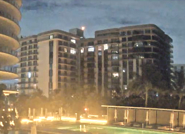

First, I think you did a great job on this, the fact that NIST changed the aspect ratio to make their slide pretty didn't help.
I've been doing this powerPointy thing for thirty years now so I thought I'd give it a go:
I think I got it pretty close?

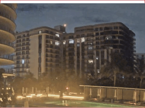

Yes. I was one of the people that was asking that question in earlier threads, based on the apparent lights on in X10 and the lack of a roofline gap. But the higher resolution seems to confirm that isn't the case, that the X11 and X10 stack dropped from the bottom (including the penthouse), and there's no roof gap because something else is obstructing the view of the sky above X10 (the roof level corridor as someone speculated back in an earlier thread maybe? indicating that the front of the building - column line 9.1 - dropped first?).
The other interesting thing from that image is that we can clearly see that the power got cut in the parts of the west wing, and apparently in 611 (that's where one of the survivors escaped from right? did she turn the light off?) but not 1110. Maybe some of you guys with the wiring diagrams can make something of what happened at the bottom of the structure from that.

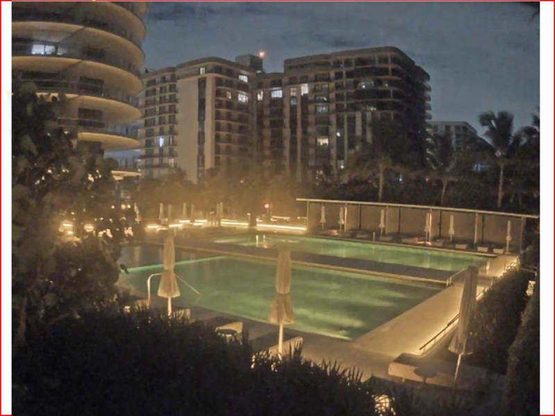

One more time!
There we go!
edit (The "Before" (1st) frame is definitely before the first frame of the twitter iPhone video
edit 2 In the "early" (2nd) frame I'm reasonably sure that the Eastern most portion is not only twisting, but falling also
edit 3 increased brightness in before frame

Sorry, I don't have any Powerpointy training so this is the best I can do.
SFCharlie - here is a corrected copy of the first NIST image of CTS. I cannot guarantee that the sizing is exactly the same as your original, but the levels are close to those of the 2nd image, to eliminate the glaring difference in levels between the two images on your GIF animation. Also it is a PNG not a GIF. If you need it to be a GIF, I can do that.
Edit - never mind, I see that you just did the same thing. :)
Thanks!, Yes that's my point, this image is earlier than the first image in the twitter iPhone vid.
