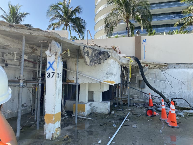

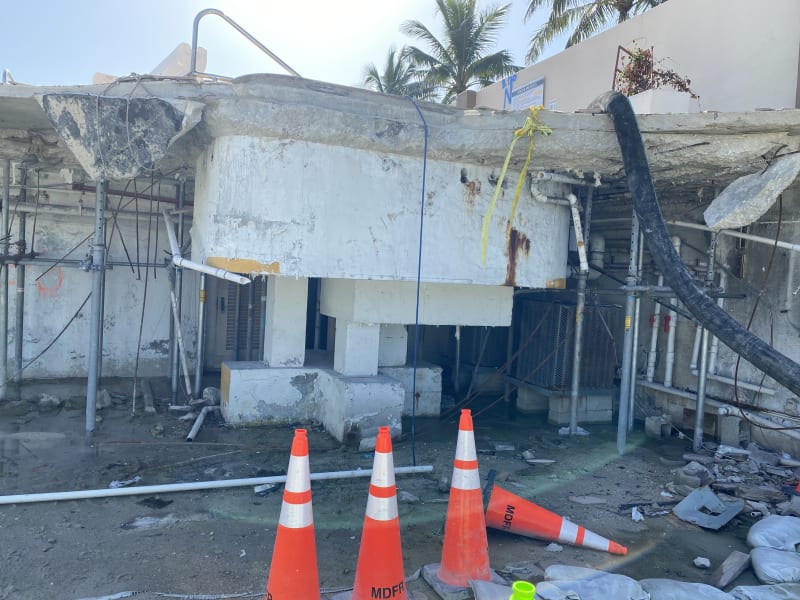

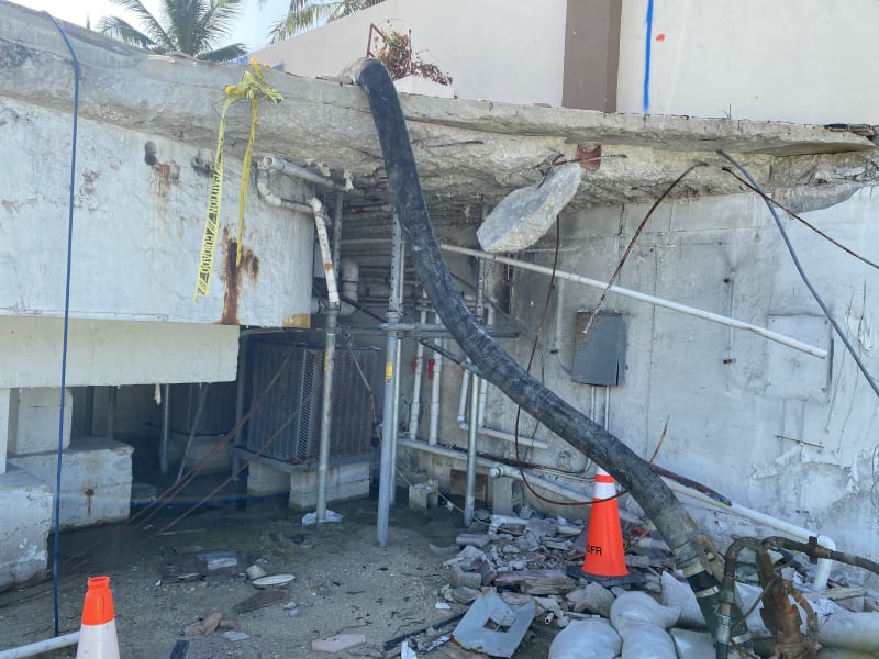

Does anyone have a good photo of the pool equipment area, after the debris was removed?
I think the pool chemicals were a very big contributing factor at South Wall, and remember the vent for the pool equipment room was ducted up and into area adjacent to planter between Pool Deck and parking deck. In a photo posted somewhere, I saw that the vent fan area was surrounded by block walls and was completely open on top. Whatever type of vent cap that was attached to the duct work coming thru the 19"x19" hole in structural slab, was inside a larger blocked wall area adjacent to planter.
I would imagine it had some sort of vent cap, which would force fumes to blow downward and outward and around vent cap, inside that area. So this part of structural slab, and those block walls were bathed in pool chemical exhaust 24/7 for 40 years. Then throw in rainy days to wash the exhaust down into structural slab, as vent fan should have been running 24/7.
Edit, mid deck drop could hit garage floor first as it pulled slab away from wall in one of the zones at south wall, and North end of slab at building. Either way, it appears we have continental divide as far as powdered concrete venting.
Back on Sept 24 I posted my video where I had 100 or so close-up high-resolution images that I showed on the video. Here are 3 of those images so you can zoom into them.
Thank you very much Jeff.

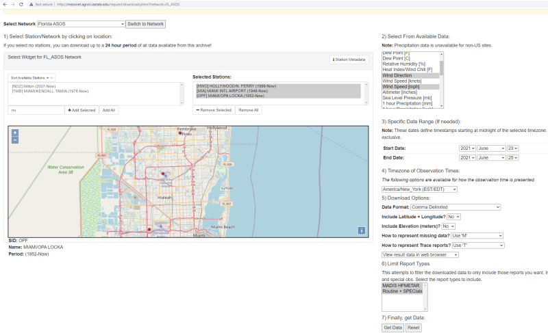

Isn’t prevailing wind also a factor in dust cloud analysis?
I agree that is a valid question. Thanks for asking.
I went back to check again the wind data on weatherUnderground.com and WeatherSpark.com, but the sample rate is only once per hour. I went looking for a better source and found ncei.noaa.gov (National Centres for Environmental Information formerly the National Climate Data Center) Link [Currently unavailable]. Which revealed that the Automated Surface Observing System (ASOS) captures 5 minute and 1 minute data at ~860 stations across the contiguous US summarized here: UCAR ASOS. I found that Iowa State University have a well designed interface to accessing that date here: Also described here: IAState ASOS. Here's a snap shot of the information I entered:
MIA = Miami International

Confirmed here:
FAA ASOS KHWO
and here:
Iowa State Mesonet - ASOS
Here is the 5 minute data for 1AM to 2AM for the three nearest stations:

I take this to mean that the wind was a light ~6mph breeze from the East (6.13mph at 78.8deg - North by East averaged across the three stations between 1:15 and 1:25AM). I think this agrees with the drift of the dust seen in the CCTV video from 87 Park when the north portion of the building collapses.
Even when the wind is blowing from the North (which it rarely does) the garage entrance is shielded by the adjacent properties and it's low elevation. There probably is some pressure difference between the North and South but I don't think it is significant in this case. There is airflow normally from the garage entrance out though the ventilation fans, but again I think that is less than significant compared to the volume and speed at which air was expelled when the deck collapsed. From your timeline, MaudSTL, we know the gust of wind from the garage was reported by Adriana Sarmiento, which I take to mean the air flow associated with the deck collapse event was remarkable relative to the general atmospheric conditions at the time.
Does that answer your question?

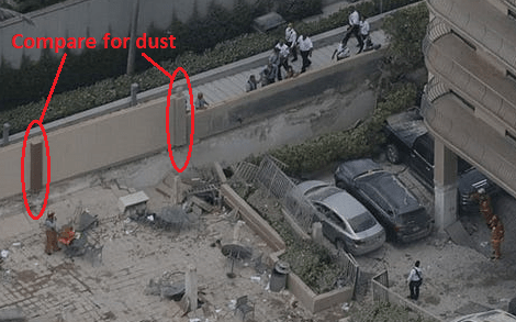

Sym P. le said:
The deck collapse happened suddenly so the initial displacement of air from the garage did not contain dust.
Thank you Sym P. le, I appreciate your response. I would like to share the image below to illustrate the dust I am thinking about.
Just speculating but high local humidity from vegetation and pool equipment room fan may have caused condensation to form on that column causing the dust to stick there more than the other ones.
