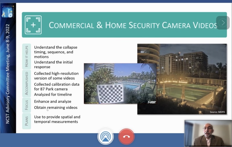

NIST has calibrated the video cam at 87 Park in order to enhance the collapse video in relation to their failure hypotheses.
>>>>Edit: I think we can give up any hope of seeing CCTV video from the CTS cameras. Note how this video slide refers only to home and commercial video sources.
>>>>>Edit: This entire process will extend to 2024-5, and NIST will not want to reveal much of anything until they publish. They plan to make 3D animations of their final hypotheses available at that time, but I don’t think we can look for anything sooner unless there’s a public outcry demanding something. I think this gives KCE the opening to provide an earlier hypothesis…assuming Surfside doesn’t terminate their agreement.
