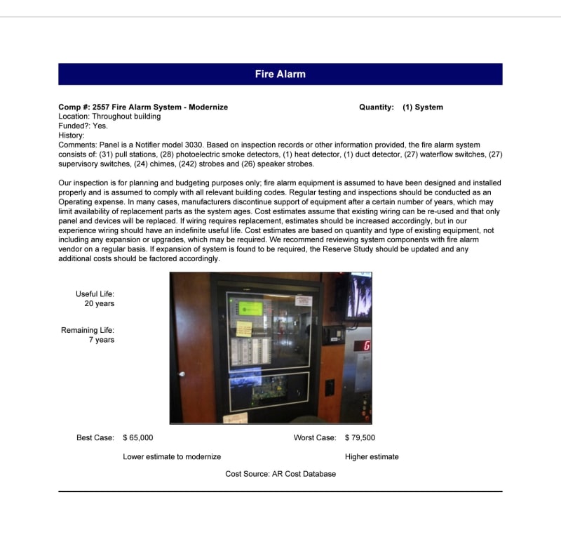

[li]System Features. “Champlain Towers had contracted with an alarm contractor that replaced the existing building fire alarm system with a new voice evacuation fire alarm system. Among other things, it included common-area smoke detectors, manual pull stations, voice evacuation speakers inside each of the apartments and in the common areas throughout the premises, and a remote alarm annunciator located in proximity to the 24-hour guard station in the lobby.”[/li]
[li]System was partly or wholly downnot functioning as designed. “Preliminary forensic examination of the central station’s account history report reveals that prior to the building collapse, the fire alarm system was in trouble, and a supervisory condition existed. The underpinnings of what part(s) of the fire alarm system was not functioning correctly and why it had not been restored to a functional mode through performing service on the system is continuing forensically.” Which parts were downhad issues? How long was it downnot functioning properly? Was CTS notified their alarm system was downhad issues? Was the local Authority Having Jurisdiction notified that this building’s alarm system was downnot functioning properly?[/li]

I can't really see a supervisory condition being equated to "system is down". That would more likely be attributed to a "trouble" status. I guess it begs the question as to how much disfunction can exist before it is considered a problem needing immediate attention. I'm sure the supervisory condition event status is configurable also. It's hard to believe that the supervisor status is presented without more information about what caused it. Wouldn't that data also be logged? Or was it up to the management to study the problem and figure it out? Then of course the question is how long was this status logged before the collapse.

I too found the article yesterday while searching for CTS fire panel info, trying to get a model # for the equipment they had there.

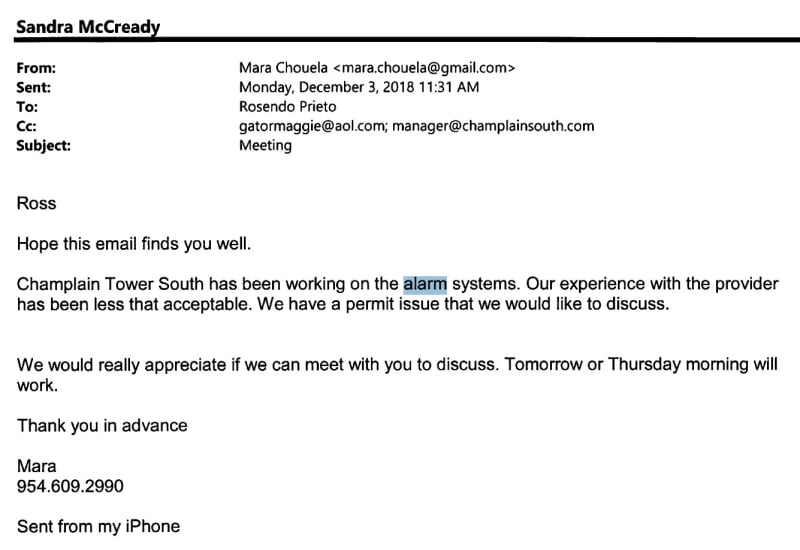

Are you aware that the CTS building manager in 2017 had written to the town of surfside to say they were unhappy with the performance of the company that installed their fire panel in 2017, and wanted to talk to officials in the building department about it.
Last I saw they had a meeting scheduled in Jan, 2018 but never saw what it was about.
Yes, this letter was mentioned in the Miami Herald piece linked to previously. It also mentions that the lobby pull switch had a fault in 2020, and woke everybody up in the middle of the night. I guess that could answer the question of whether that switch controlled the lobby level or the entire building.

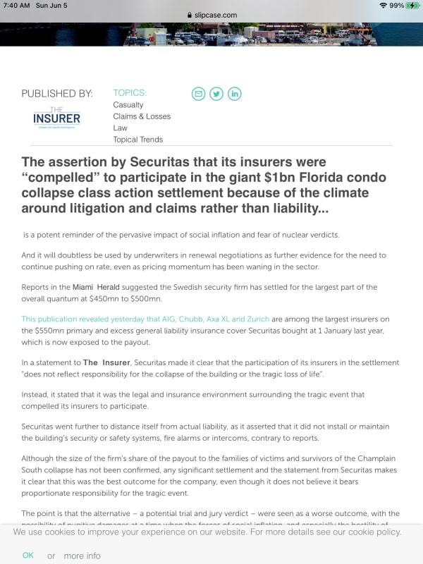

Found this on Securitas settlement. With deepest pockets, the worse outcome of potential jury trial and nuclear verdict compelled their insurers to participate. They distanced themselves from liability and asserted they did not install or maintain security or safety systems, fire alarms or intercoms. Here’s a link and snippet:
