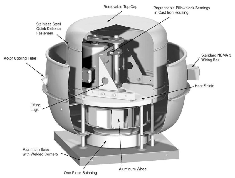

"Anybody see a CAP on top of that Exhaust Fan Assembly in those images? Don't see how the air exhausts immediately vertically without a hole in the top cap?"
In designs like that that I've seen, that "top cap" is a cover for the motor, with the centrifugal fan mounted below. The venting is often downwards out the bottom of the larger diameter cylinder--closer to the ground.
spsalso
Perhaps Nuke can explain???
Blah, blah, blah?
Begin here:

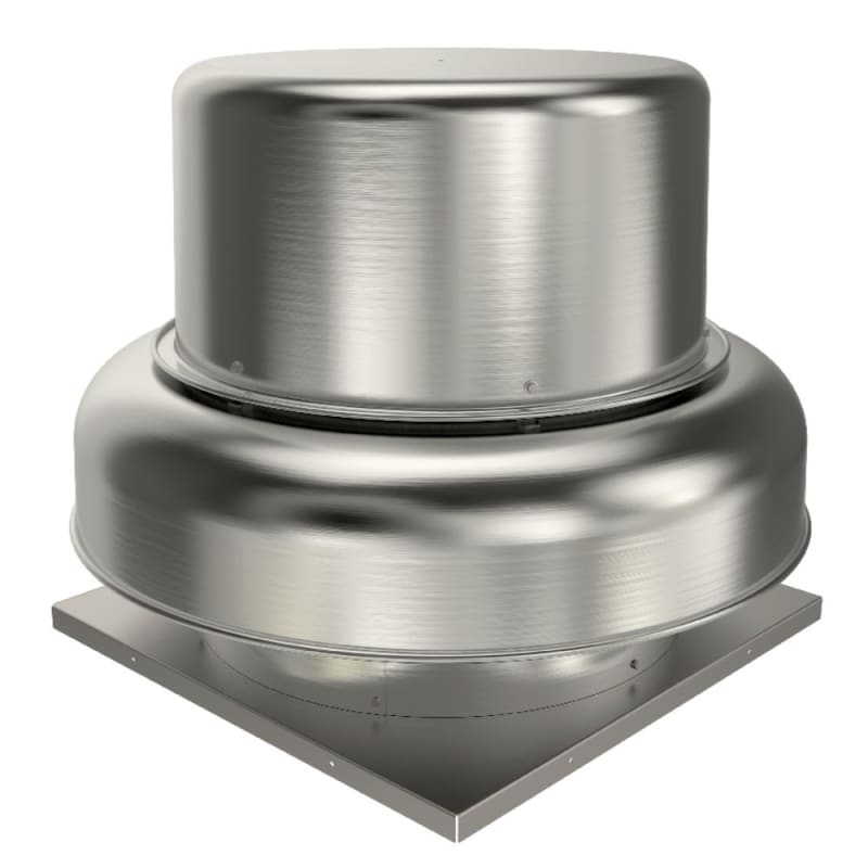

You see, this type of fan is commonly available in both downblast and upblast designs, therefore no separate rain cap is needed. In fact, if you take the time to look closer at all of those nice pictures you just posted, you can see that they are all of the upblast design.
Perhaps you could take the time to study this cutaway image. (since you seem to be too busy to do your own research)
Now, Morabito's drawings show a tube axial fan style for the replacement unit and that is what I thought I had seen in a fuzzy picture somewhere. If CTS still had the original fan installed, it was completely hidden in all that moist humid vegetation in that waterlogged planter. So the fan would be blowing all that moisture on the wall where it could condense unevenly and cause a dust cloud to stick to it.
Sorry, I don't have any Powerpointy training so this is the best I can do.
I am unaware of any images of what type of exhaust fan was in the blocked in area beside the parking deck planters. It could have been upblast or perhaps it was downblast like the image below. Where does the rainwater go that gets into upblast discharge area? Perhaps the fan is capable of expelling any moisture that gets into discharge area? Downblast would solve that problem either way, when upblast is not required.
Well, the model numbers for the original fan schedule are obsolete but all the original upblast fans have a similar model number. Good evidence but not proof.
If you were an architect trying to hide an exhaust fan in a blocked in area and the price is the same for upblast and downblast, why would you even consider downblast, especially if you were exhausting pool equipment room fumes. You would want to blow that up and away from sensitive stuff like pool guests and plants and concrete, right? Restaurants always use upblast for kitchen service to keep the grease off the roof.
All upblast models have a drain for rain water that is usually easy to see: Those that are intended to be used for restaurant service sometimes come equipped with a a grease trap on the drain. You can believe whatever you want.
So even upblast exhaust fans drain condensed vapors and rain water at the base. If that drain port is not hooked up to say a drain line or that drain line has failed, then the condensate mix ends up on top of the parking garage ceiling, and able to soak into the concrete.

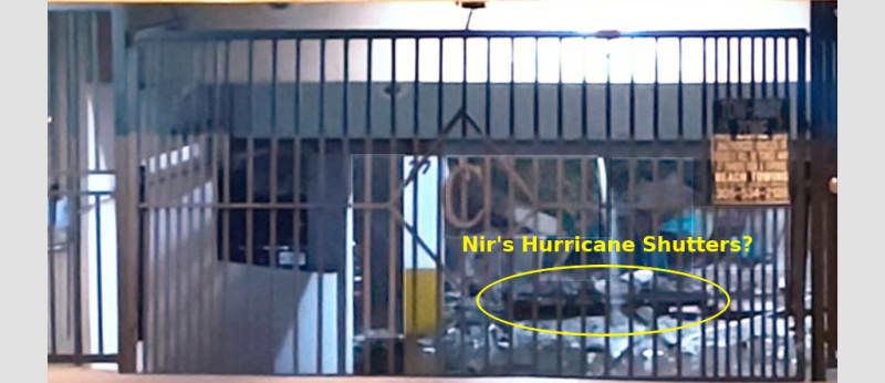

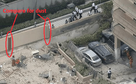

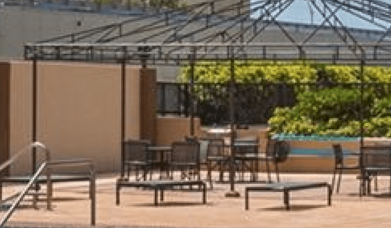

Nir's hurricane shutters? Note the shutters are framed and sit on the deck.
When I zoomed into your photo up above that does not look like the shutters to me as they would not be in one long piece like that remember they would be open like an accordion and probably in a 2 foot wide chunk. What that looks to me like is part of the pool deck in the black that you see on the top of it is the waterproofing membrane. That is where my money is bet
I now see what you are pointing to and it is an interesting detail to be sure. It appears (ABC video) that the single buttress is uniquely dusted. It also appears to be in line with the direction of collapse of the east portion of the tower and a denser path/layer of dust.
I don't believe that it can add much to our understanding of the collapse initiation.
I find it interesting that powder blast at column is Due South of where the slab dropped at the planter over K line, and we know that area dust exit is bound by slab drop to North, Pool/Hot Tub to East, and parking deck hinge to the West.
Perfect storm to force powdered concrete exhaust towards South Wall. Deferred maintenance could mean duct from pool room was rusted thru, or gone?
Edit: Perhaps pool exhaust fan duct work is damaged or drops at opening in slab,and exhaust fan rolls and leaves 19”x19” opening to parking deck below. Or tree roots pushed fan off base? 🥴

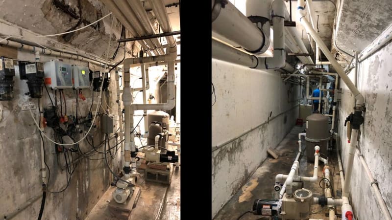

Does anyone have a good photo of the pool equipment area, after the debris was removed?
I am not sure whether you were talking about the deck/hot tub area Jeff furnsished or the actually pool equipment room. Here is a better photo of equipment room area behind louvered doors, if that is what you were asking?

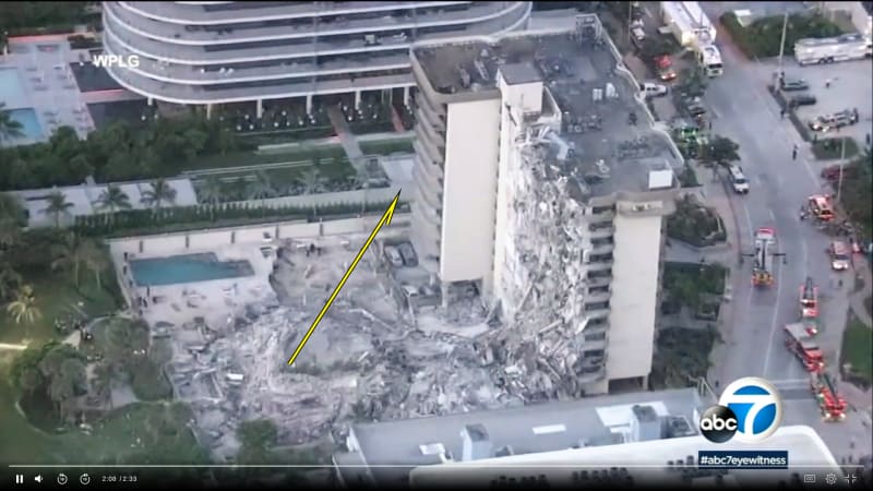

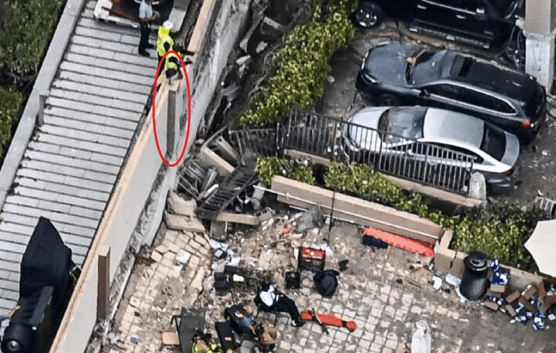

Thank you very much for taking the time to study the photos and search for alternatives. Please can you take a look at the image below and let me know why you think the dust did not stick to the East face of that column as shown below:
Edit: I found an earlier image that does appear to show some dust on the East side of that column but it looks as though the lighter dusting on the East was reduced after it rained. Judging by the cars and other objects.

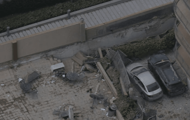

Nukeman948 said:
Just speculating but high local humidity from vegetation and pool equipment room fan may have caused condensation to form on that column causing the dust to stick there more than the other ones.
If the humidity on the column is coming from the vent and vegetation would it be consistent up the entire height of the column even if the bottom of the column were masked from that humidity by the adjacent wall as shown below:
The dust on the North face of the column appears to be quite consistent in its coverage.
