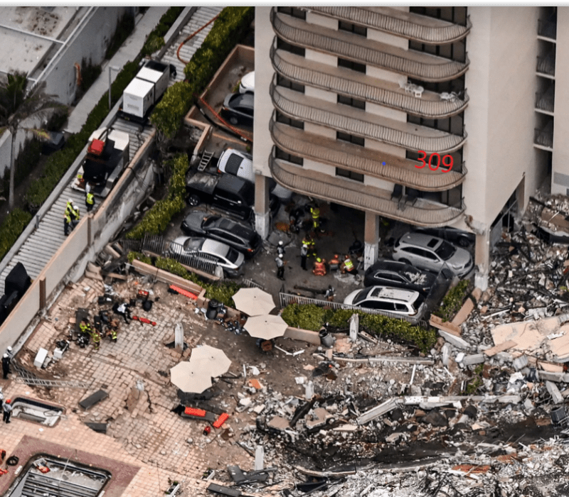

The NYT has the depositions and the security system logs, and we finally have an interview with a witness from 309 who actually saw the deck collapse in progress, collapsing from south to north. They also interviewed Shamoka Furman. There are some time stamps from the security log, including a Trouble code at 1:15:29, which may give us an accurate time for the deck collapse. The system logged a fire alarm at 1:15:46, which may be the lobby pull switch. If that’s the case, then Shamoka Furman is likely to have pulled it. Shamoka’s first 911 call was logged at 1:16:27. The 911 call from Central Alarm Control was logged at 1:16:39.
Here are highlights of the new information: [ul]
[li]“…Paolo Longobardi (309) on the third floor. Thunder, he thought. But his wife, Anastasiya, had heard something more unsettling: an unnatural, metallic crunch. The two of them, groggy with sleep, peered out the sliding glass door of their bedroom overlooking the pool. Below them, the pool deck was caving in. “It was disappearing into the ground,” Mr. Longobardi said. “It was like a wave coming from the right to the left — from the south to the north — and it was falling.”” NOTE: A long time ago, one of the witnesses in the lobby (it may have been Chani Nir…I’ll see if I have it in my notes…) mentioned seeing a family escape…this may be that family.[/li]
[li]Jonah Handler and Stacie Fang (1002,) having heard the “thunderous bang” of the deck collapse, went out on their balcony to see what had happened. They thought the sound was from above, but they looked up and didn’t see anything. So they went back inside to the bedroom, which is where they were when the building collapsed. [/li]
[li]“Around that time, the building’s alarm system was starting to activate, first at 1:15:29 a.m., when it signaled “trouble,” according to a data log. Seventeen seconds later, a fire alarm triggered. It sent out an automated alert to a monitoring company, though it is not clear that it generated an audible alarm on any floor. Soon after, a staff member at the monitoring company notified 911 that a fire alarm had been activated at Champlain Towers.“[/li]
[li]“The building also had a sophisticated audio warning system designed to broadcast an alert into the bedrooms of every unit. But it was never triggered, newly available deposition testimony and interviews show, because the security guard had never been trained about the system and the single button needed to activate it. “If I had known about it, I would have pressed it,” the security guard, Shamoka Furman, said in an interview.” “Ms. Furman, who had been a Champlain Towers security guard for four months, said in an interview that she received minimal training when she was hired, with another security guard explaining the contours of the job while they stood for an hour in the lobby. She said she never learned about the “all call” button. The other guard declined to comment.”[/li]

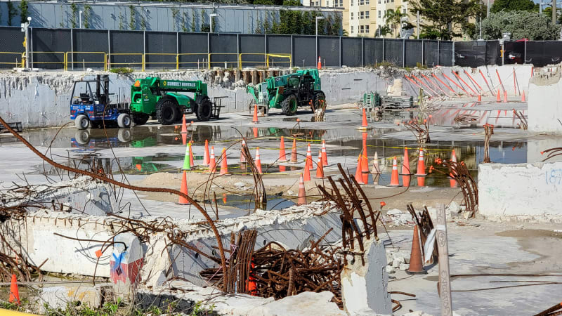

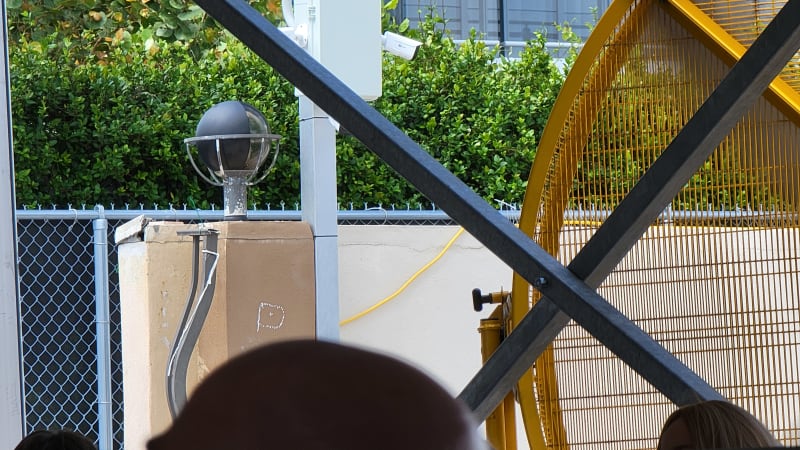

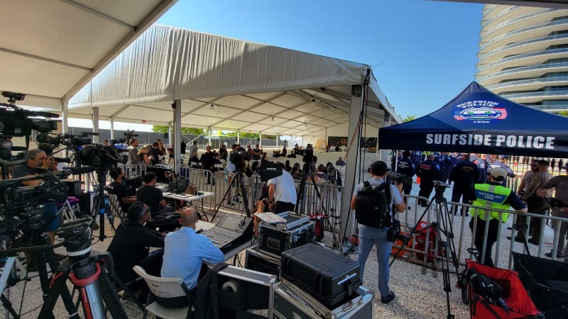

I am here at the sight of the Champlain tower's South condo collapse today for the memorial it's going to start momentarily. Here are a couple of photos I just shot of what the site looks like today and what they have going on here. In one of my photos you can see I zoom in to where they started the advasive testing on the floor with the squares around the 3 columns that I mentioned last night. Also they started cutting long rectangular holes in the South wall.
Security here is off the charts just to get into the property itself my camera bag was checked twice by 2 separate secret service agents commanders dozens and dozens of cops here there's probably at least 4 dozen media tents and trucks and trucks and live towers set up I'm in a pool area back here What about a 100 other media people.

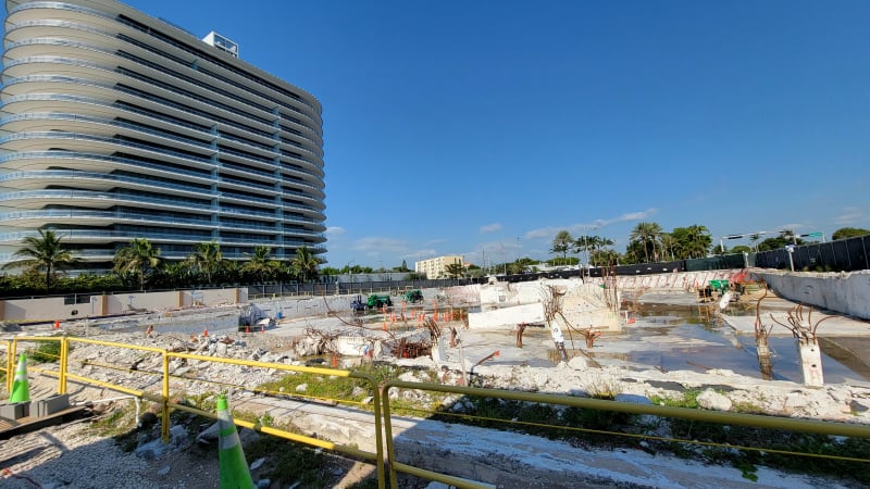

I am sitting next to the pool now during the remembrance event. There is one view of the Eastern most column of the pool wall in case you're still looking for photos near the pool wall.
That is new info. Seems to imply the deck collapse started at or near the perimeter wall since that is the south end.
Also implies the deck didn't drop in unison for there to be a noticeable wave.
Isn’t that how fast punching shear progresses? To the ear, it could sound like one big crash even though to the eye is progresses like a wave.

- 309 - that "wave from south to north" testimony is, imo, also compatible with an initial collapse at K14.1 - that would have propagated to the south wall by the time they got to the balcony, and the main effect would still be a northwards propagation towards the building. But I don't think it's compatible with a collapse initiating around M11.1 as we originally thought.

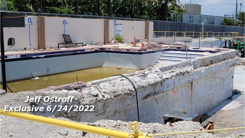

Here's a pool picture I shot yesterday at the one-year anniversary of the Champlain towers South condo collapse remembrance. Interesting shot of the pool you'll notice the two giant square holes to the left of the O.1 column marking on the wall where they've already started the invasive testing. I'm working on the video for all of this and there are so many holes everywhere that they have started to slice and dice all over the property.
