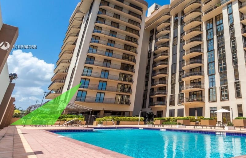

A quick study suggests it would be generous to say they had a complete view of even the pool deck.
Edit: full scale attached below It won't attach with edit

@Sym P. le, I would have thought they could have a wider view from that vantage point.
Likewise, until I sketched it out. The edge of the balcony creates a greater obstruction for someone standing inside the unit than I thought.
Had they moved out onto the balcony, they would have had a much better vantage point however it doesn't seem like time was available for that to happen and in their minds, they had all the information they needed to tell them to get out.
Edit: Perhaps the take away is that they could see enough of the pool deck to see what was going on but they couldn't see the parking area directly beneath them unless they moved out onto the balcony.

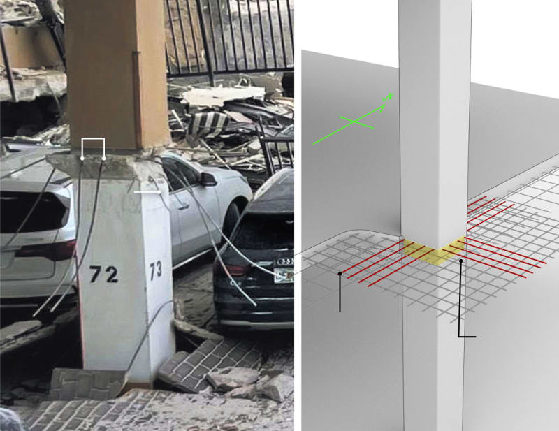

Is the punchout pattern around column 72/73 indicative of a directional wave of failure? i.e. The typical wedge of concrete on the south and west sides of the slab/column connection may indicate a zone where typical bending failure occurred while a wave of failure spreading to the northeast caused the slab to shear off the column vertically on the north and east sides.
Edit: ... which may bring us back to the big heavy truck parked southwest of that column.
Remember the deck started 6ft higher up.

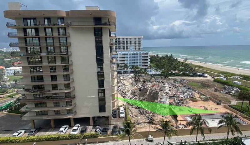

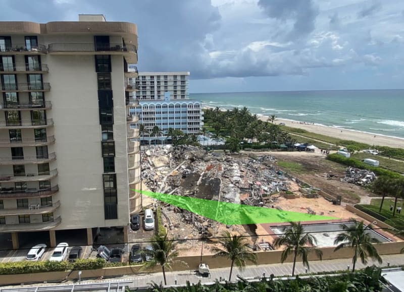

Longobardi's potential view to the south is much more directly down so I've indicated a potential footprint of view accordingly.
I am trying to visualize how this would work. So if the planter/parking deck fell with the sound of thunder, are you saying that could have pulled the deck off the south wall and resulted in the south-to-north wave?
I was just trying to gain some appreciation for the witnesses proximity and vantage point. It would seem the Longobardi's are the best witnesses to date and that gives a lot of weight to their statements. At the end of the day, all of the evidence should be telling the same story. As "investigators" we are the ones who have to challenge our thoughts and preconceptions to figure out what that story is.
