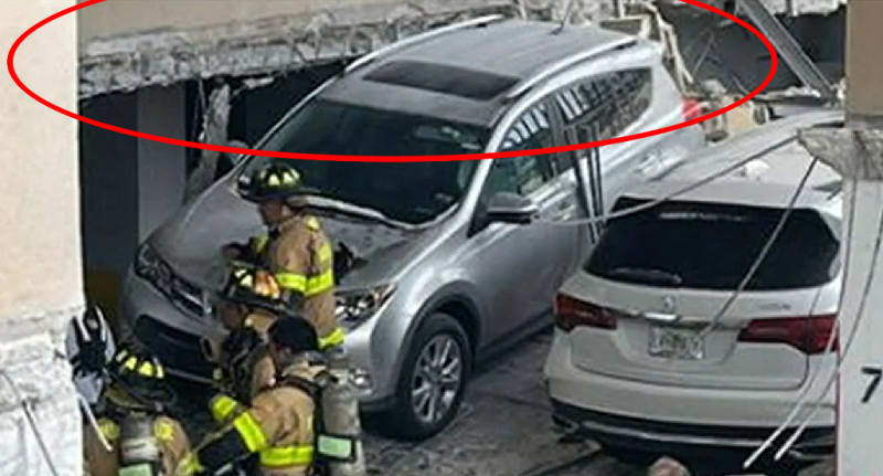

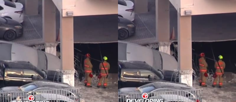

Is the punchout pattern around column 72/73 indicative of a directional wave of failure?
One of the puzzlements in the photo of that punch out is the way the broken stampcrete at the column ended up. Not to hijack any thought process on the actual slab. I just can't get my head around how the stampcrete passed over or around the bars and ended up so neatly in the front print of where they began. And then compound that with the appearance the the large piece seems as though it was under the rear end of car the whole time. There is an explanation of course. I just can't imagine it.
It's all rather magical isn't it. And the clean top bars.
Problem is "magic" is not how we should chalk it up. Anyways, I meant to say footprint and not front print. Must have been auto correct or some other voodoo.
Edit: I think it may have happened that the right rear under side of the bumper would have rotated the stampcrete clockwise over the top bars as it slid downward. Then after it passed the bars the car bumper would have pushed it down under the bars and it fell right back into the hole it came out of. Sorry, I just have to try to make sense where there is none. I just don't know why it took so long to figure out anything plausible. The clean looking bars are probably more concerning then.
Edit: dang I meant left rear. I'm looking at it like a CT scan I guess. (joke)

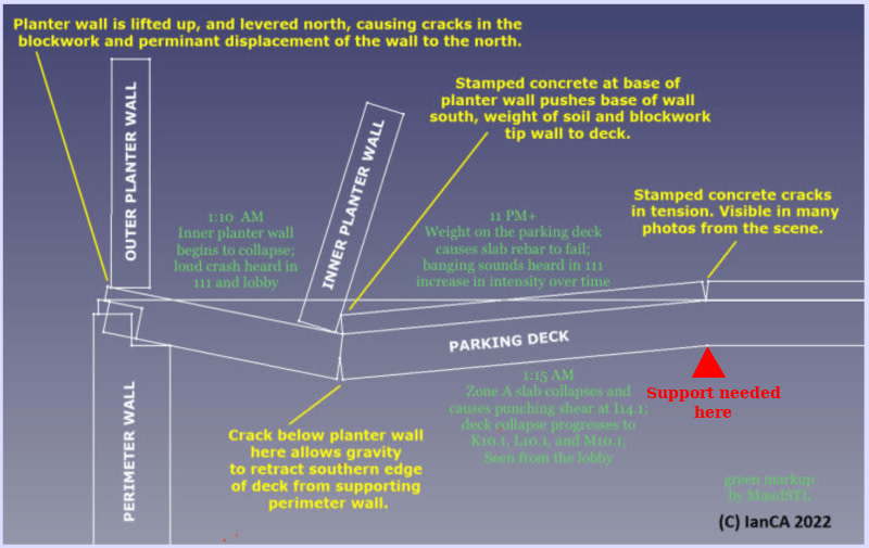

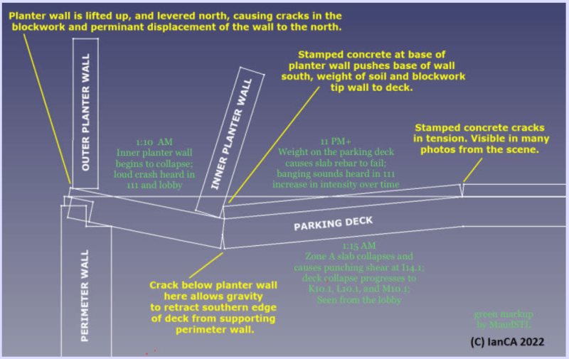

I would like to reintroduce the image that MaudSTL contributed to back in February.
MaudSTL (Computer)5 Feb 22 01:49 said:
I’ve mapped the narrative onto IanCA’s annotated drawing for the sake of discussion.
I think it is relevant in light of the recently publicized witness statements from appt 309.
The only thing I would adjust now is to suggest that the loud crash heard at 1:10AM could be a portion of the deck/planter base falling into the garage.
If the deck collapse is progressing from the south to the north this suggests the deck collapse started at or near the southern wall. Other evidence, such as the shape of the collapsed decks and the dust on the column, suggests that the parking deck collapsed before the pool deck.

Unfortunately, basic physics xnays that theory without additional support and once again, that planter is not likely to have the degree of influence that you imagine. It is far more likely that vehicle traffic caused deterioration at the column interface, which suffers from a lack of rebar.
Sym P le said:
Support needed here
We are talking a 2-way reinforced rebar grid slab, and more significant deterioration of structural slab under planters, due to no water proofing membrane under stamped concrete with edge of stamped concrete butting up to Southside planter wall. Then add pool exhaust chemicals mixing in plants and planter soil.
So if slab under planters deteriorated more, it is logical their loss of strength could affect that area more, leaving a cantilevered slab to the North, that at that moment has the N-S grid loads fully transferred to the less deteriorated E-W grid at the point where support is needed that would cause tension break in top of stamped concrete and structural slab.
Seems to fit well within the laws of Physics. Support does not have to be a wall or column directly under break, at a given second or millisecond.
Note E-W rebar grid held longer to West and was unzipped to the West, which is evidence of support provided to cause tension crack in top of slab.
Edit: It also appeared to me in photos, that there was no consistent laying of N-S rebar under E-W rebar. Sometimes it appeared E-W was bottom grid. This would seem to affect how loads transferred, based upon a given initial failure point?
I've always understood the laws of physics (mechanics of materials) to be the same regardless 8000 psi concrete or a wet sponge.
The other thought is all the flexing of the elevated parking deck has added weakness in specific locations based upon loading of that area, and slab deterioration in that area. So we do not have uniform structural properties in the reinforced concrete structure, which is an unknown variable in equation.
Yes but no matter how weak the concrete system is, in order for a downward force to break it, there have to be reacting supports or the system will merely rotate.

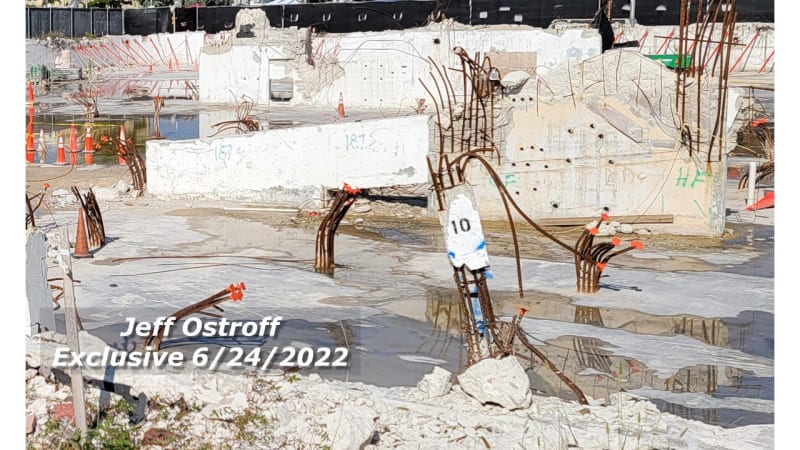

Here is another photo that I shot at the one-year remembrance ceremony at the Champlain tower South collapse site last Friday morning. You can see just how many round core samples they've taken from the wall of the garage ramp it's amazing they needed to take that many core samples also if you look in the background on the far West side of the site, you can see all of the holes they drilled into the elevator shaft vestibule, which is really the bottom of the giant shear wall.
I also noted in the video the other day about how they've really torn up the bottom of the ramp and there's a lot of sand piled up there now, unfortunately we still need more data all the way unless that is the C and from where they made those big 10 foot square cutouts around the columns M9.1/10 and L9.1/10, and L11.1

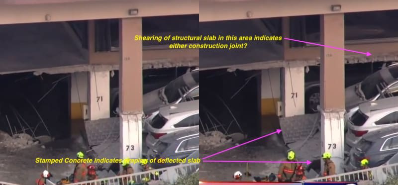

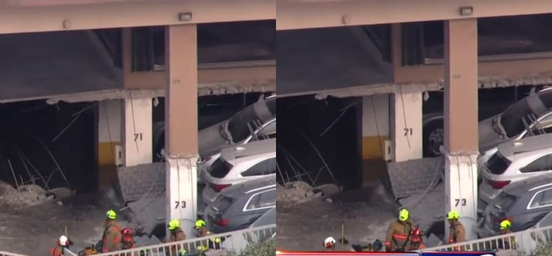

In Symp's 3D images, there appears to be different types of failure happening on either side of Column Lines between parking spots 71 and 73. Question is which direction does this say collapse is progressing? One side of column deflection of slab causes draping of stamped concrete, where as the other side just shears cleanly off.
Edit: Perhaps just Lobby step up in slab provided sufficient stiffness to cause shear of slab on parking deck side, once slab was deflected on South side of parking 71/73 columns due to failure progressing from the South to the North.
The point of your arrow looks like it's in the stampcrete, not slab or topping. In other words the stampcrete is sloped a lot there and becoming as thick as the slab towards the E/W planter box. The stamp-crete abuts the step or wall. I mean what do you see there?
