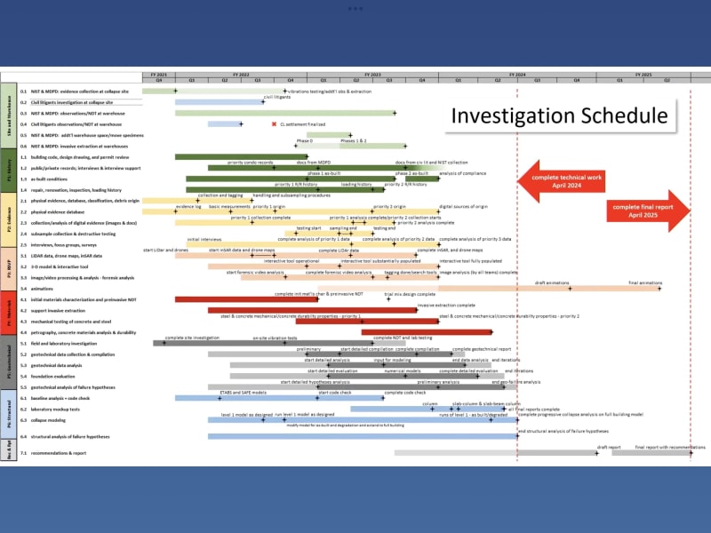

A reminder it's been almost year and a half, and we've yet to see the results of one concrete core sample post collapse.
I know the media and the general public can be irresponsible interpreting evidence and jump to conclusions, but this lack of transparency is still insane.
AP NEWSFLASH: The NIST announced that they are pulling out all stops and racing to meet thier 12/2024 deadline

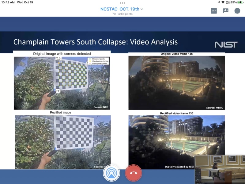

NIST has “rectified” and “digitally adapted” the MDPD video.
Here is the related slide.

I realize that this spreadsheet is a poor resolution because it’s a screengrab from a videoconference, but if you can zoom in on it, you can see what they’ve been doing. They have to follow methodical procedures to hire the contractors they need, so they definitely cannot hit the ground running.

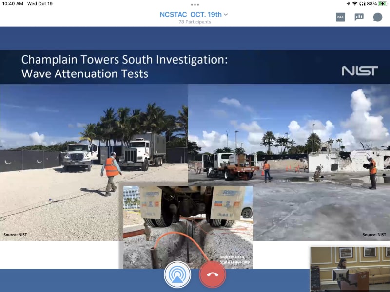

NIST started with wave attenuation testing.

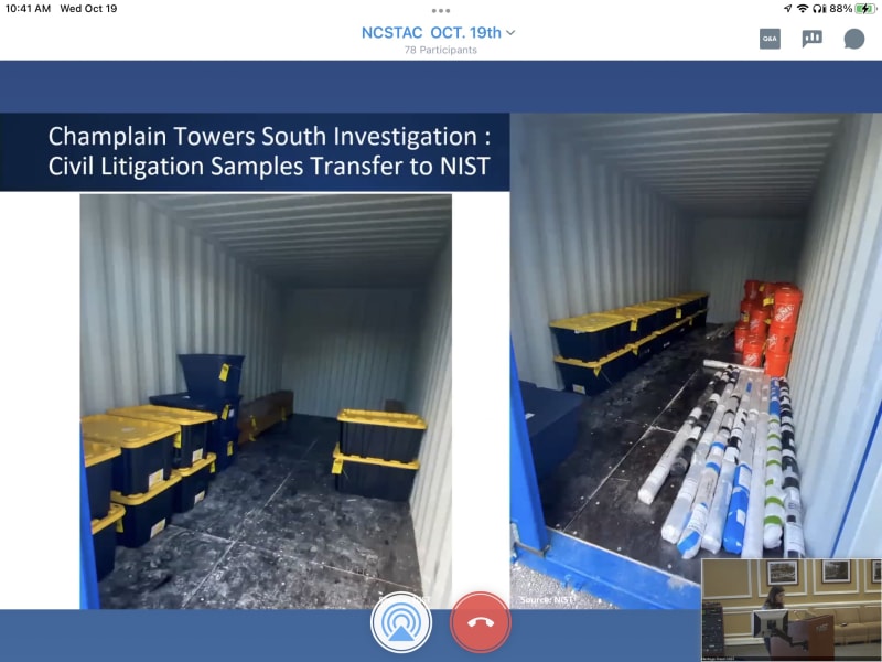

NIST received evidence that seems to include core samples from the civil litigants. They spoke warmly of how helpful the civil litigants were, because they had hired their own independent experts to perform analyses. I wish I could read the transcript of the civil litigants’ hand-offs to NIST.

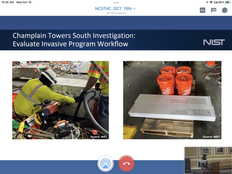

NIST took their own core samples.

The digitally rectified video made the building and all the trees on the right side lean.
Reverse_Bias (Electrical) said:
rectified footage
I agree. I'm sure they know their business but it looks utterly wrong to me too. Seems to me they have corrected a far-away thing using an up-close distortion scale. The distance ratios that create the spherical distortion are all wrong for that to work. It is saying that the delta of the distances from centre of pattern to lens and corner of pattern to lens is in the same ratio as the delta of lens to building centre and lens to building corner, just because the pointing angle from lens to those places is the same. I'm...speechless.
I notice that they did not identify the lens center. This is critical, as all corrections would normally be based from that point. Put another way, it's the origin of the x-y axis of that checkerboard. Or should be.
