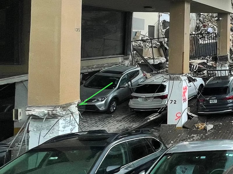

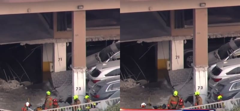

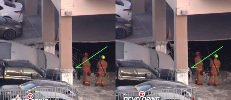

The state of decay of the lobby parking deck (for years) is so obvious (at least in hindsight), it should be embarrassing. Given the witness accounts of collapse initiation in the lobby parking and prior documented failure of two pool deck slab/support column connections it is really only a matter of scouting out the final straw. I might see one, the rebar stub below stall 135 and missing lower rebar mat.
It is something how some time away from this makes some things stand out slightly differently. To think about progressive collapse in this repetitive punch through at the parking/pool deck area seems almost too much. These were primed to go IMO as a unit IMO. So if you take that factor out, and say only one of these columns at the parking deck actually had insufficient mat, then does the building ever collapse? Was that one point the trigger? does that even matter? If you have a gas leak as an analogy in a building and the gas has reached explosive concentration. How important is it to identify which of a dozen or so possible ignition points were at fault? This contactor or that light switch? How many of those green arrows can you make if you really try? I should think there has to be something that allows this pool and parking deck to collapse without the result being that the building went with it, assuming it did not start at the corner of the gym. But yeah the parking deck seems to have collapsed before the building. So was the designer thinking "they better take care of the pools deck or else"? If he could say that today would it be shocking?

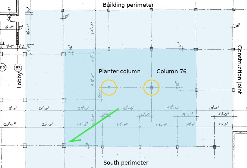

Three indicators became visible over time, the lobby parking slab cracks, column 76, and the planter column. The fourth, as I've indicated, was hidden. The rebar at stall 135 is more sparse than column 72/73 (it appears the last strand snapped) and provides a plausible conclusion to the evidence which fits with everything else that is known. It should help to focus the discussion. Unfortunately, the parking slab cracks were seen for their nuisance of water dripping on cars and the column connections for that uneasy queasy feeling they gave. Perhaps in the future, these inconveniences will lead to proactive precautions and remedies before the hidden factor bites anyone in the assets. Parking and pool parties should have been suspended.
It only takes one green arrow, the rest can be copied and pasted.

I'm not into conspiracy theories, nor do I subscribe to ignoring evidence. No one ran from the gym exclaiming "The gym is falling!". A witness did run from the lobby (past the gym) to collect their family when they saw the lobby parking collapse. When various pieces of the puzzle are turned over, it is actually possible to put the puzzle together.

If we're talking about the years of neglect, of course. If we're talking about ferreting out another puzzle piece, the rebar stub or two (single lower mat strand on column center line) are also relevant. Everyone can see that the rebar is sparse but no one has noted that there is even less under stall 135. To me, it provides additional weight to the collapse fact pattern.
