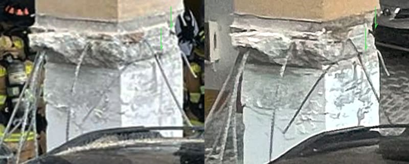

The following 3D is difficult to view (I had to manipulate one image substantially) but it shows the two rebar stubs below stall 135. I believe these are the only photos of broken rebar but this cannot lead to a conclusion that they are the only broken rebar. It will be interesting to see what evidence was collected by investigators in this regard.
The topping layer and tile would mask a lot of deck upper surface cracking and shifting that occurred leading up to the collapse. For example, the tile at column 76 did not appear to shift when that connection deteriorated and the tile near the planter column was in far better shape than the planter would indicate when that connection deteriorated.
Witnesses heard significant unexplained banging at various times prior to the collapse and this could be the breaking of rebar or as other evidence might indicate, a de-laminated slab loosing its grip on the rebar. Am I correct in thinking the broken rebar leads the failure and the other rebar gets pulled out?

...it shows the two rebar stubs below stall 135.
Thanks very much for posting these close-up images.

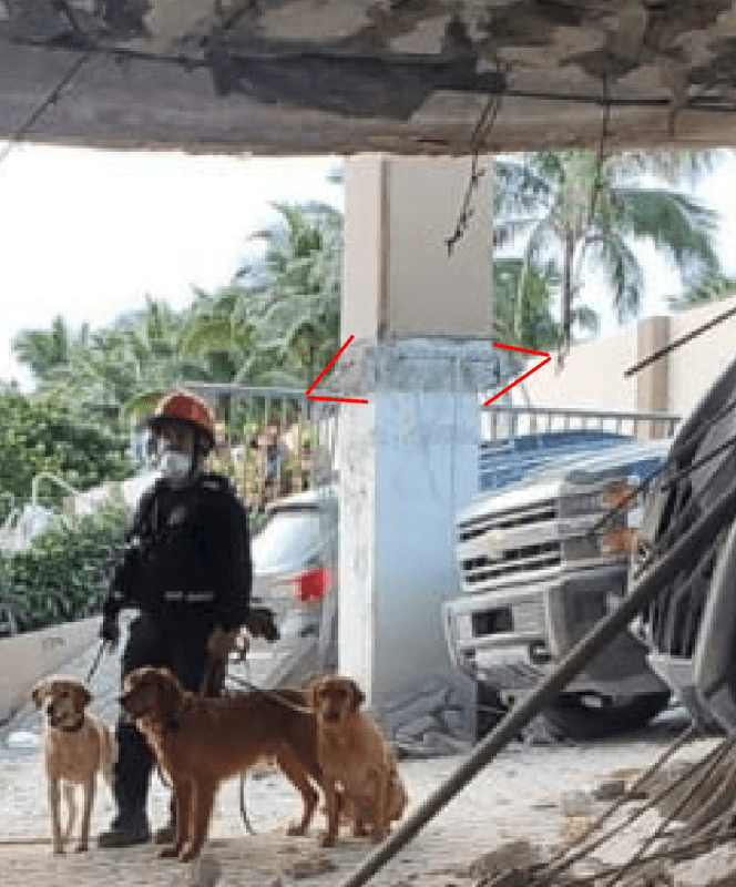

Thanks very much, I have read both versions and they are helpful. They do show in Fig. 1 view AA the expected shape of the deck remnants on the column if the deck fails due to punching shear and the load and bending moments are symmetrical and positive, but to me, the deck remnant on column I14.1 (stall 135) on the north side of the column appears to be inverted, please see the image below, suggesting to me that the deck north of the column was experiencing a negative bending moment and the south face was experiencing a positive bending moment.
I acknowledge that the north side looks more rounded in some other images.
The description by Ernesto Valdes of the punching shear failure of the columns in axis I attributes the failure to increase in vertical load due to the preceding failure of the deck at column K14.1, however, the area of failure on the east face of column I14.1 appears to be nearly vertical and flush suggesting to me that unbalanced bending moments from east to west were not as high as unbalanced bending moments from north to south.
Thanks for preparing the 3D image pairs I did finally get that to work for me by concentrating on aligning the arrows.
My basic thoughts of the two broken stubs are that they are evidence of generalized slab punch out to the east of the column, the same area compromised by failures of the now infamous Planter column and column 76 slab connections. They are, in fact, the smoking gun being sought to sum up the general speculation that we are left to. Hopefully more answers will be forthcoming with detailed engineering analysis and presentation.
I can't find any adequately detailed photos of the column immediately east of stall 135 (that would be K14.1) to see what it may reveal. Though vehicle traffic may have aggravated the decay, I now think it more likely that a drooping slab broke these two rebar. There was an extended period of audible warnings as the structure succumbed to decay but it was not understood. Just as the decay at column 76 did not leave concrete chunks on the parkade floor, it is now apparent that this type of indicator would not be forthcoming and explains why visitors could drive into the parkade minutes before the collapse and not see anything of concern.
