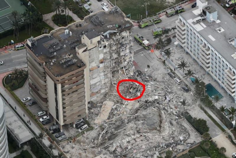

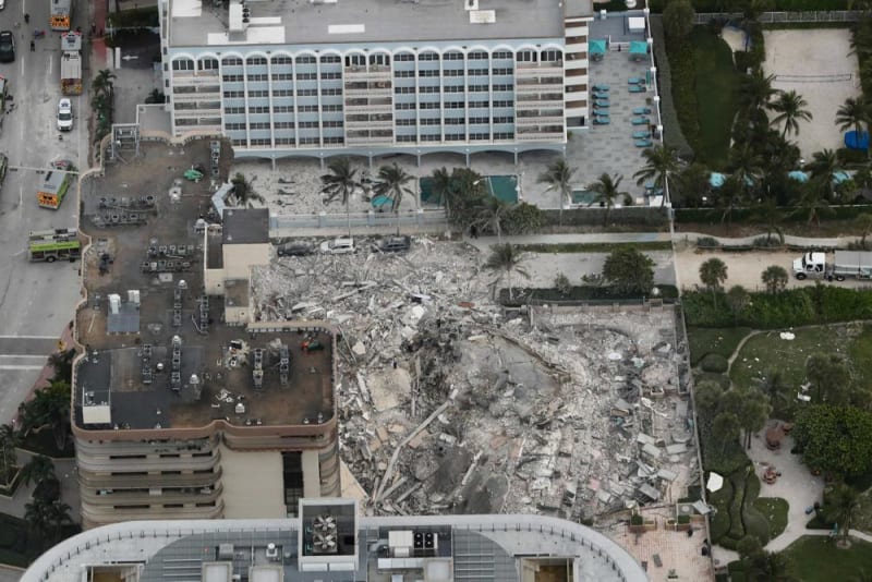

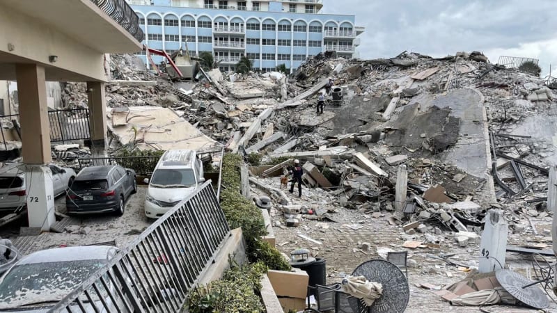

When you look at the debris field, you see columns and floors but not many walls. Link It explains why the debris pile is not higher, most of the walls are CMU, which can be seen here and there but likely a great deal completely crushed. Another reason, there isn't a lot of hope for finding survivors.
@epoxybot that is very typical construction in S Florida, main structural system is concrete slab/columns/beams, shear walls at cores. Most of the masonry is "infill" only

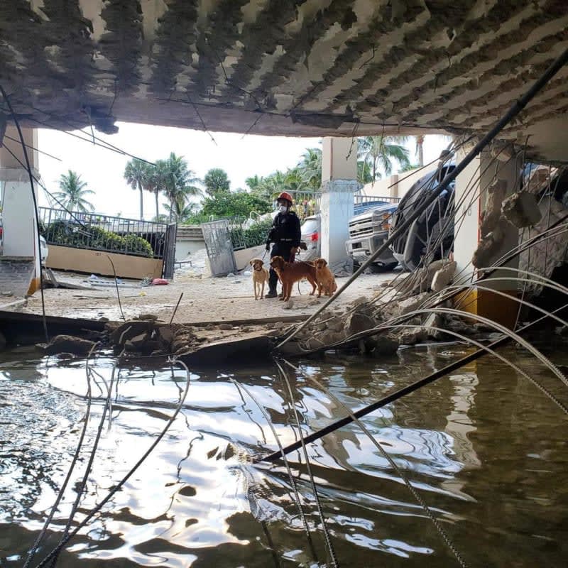

That bottom photo in epoxybot's post is intriguing. Are those black rods individual unbonded PT tendons? Are those closely spaced spalls where the tendons were? Is that photo of a tranfer slab?
I'd also be looking at the detailing... there appears to be little redistribution.

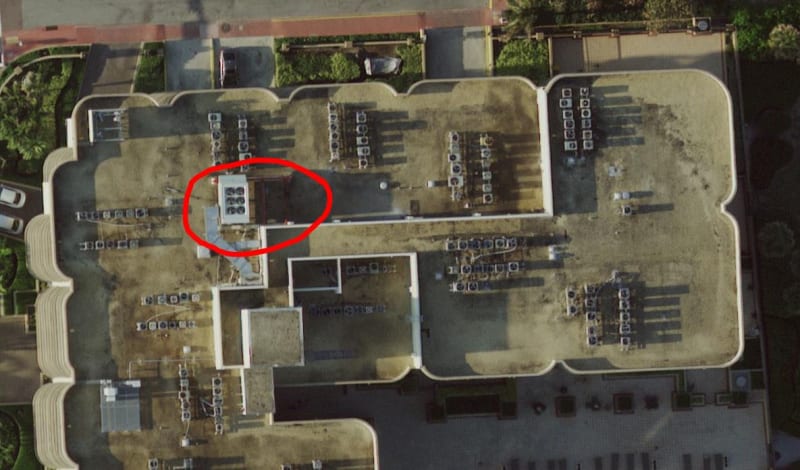

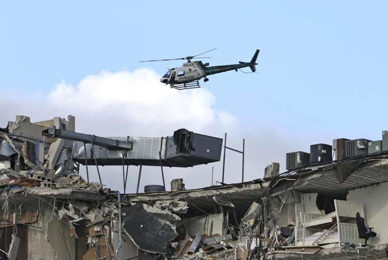

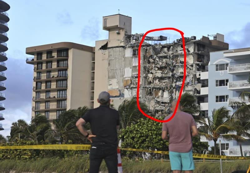

The building changed its HVAC equipment sometime after 2019. This equipment was on a red steel platform with corners sitting on concrete columns clearly visible in aerials. The equipment flipped over the platform as it fell down the building, this tells me it didn't ride down the building but may have been the reason of the collapse - falling first. The new equipment was on sitting the portion of the building that is still standing yet fell. There also is a large gash in the remaining portion of the building under where the equipment sat.
Furthermore, initial reports confused 135 and 136 units, it appears at some point the "Penthouse A" was added (possibly during construction) as the flyer from 1980 for the building only states 135 units and 12 floors. The penthouse is the 13th floor and 136th unit - it was recently sold and the listing noted marble floors. The penthouse and HVAC unit appear to share a column at the SE corner of the HVAC platform that seems to be the source of the collapse.
I wonder if they placed any additional equipment on or near the HVAC platform prior to collapse and if the building was structurally designed for the penthouse. It is also possible the platform itself failed if it was not designed for the new equipment - it does not look like they replaced or strengthened the platform when the new equipment was installed. To me, this does not look like a sinkhole but a progressive collapse from the roof for the first portion that collapsed as it did not tip over, followed by a failure of a low level (possibly garage) column due to debris causing the second collapse where the remaining building essentially tipped over on top of the first collapse.

2019 aerial (old equipment):
2020 aerial (new LARGER equipment):
hokie66, good eye. Those look like PT tendons that have been ripped out of the bottom of that slab as the area beyond came down. This spot looks to be at the juncture between the standing and the collapsed. The rescue worker seems to be standing on one or two floor slabs that have come down along with the PT. Area to right shows something similar with the PT still in slab. Although, the way those concrete blocks are dangling, and it being near the column, that could also be mild steel in the slab-column connection zone.
hokie66: No PT from my observations. I am seeing bottom rebar that has 'unzipped' from the slab soffit.
Doesn't it look a little too clean to you Ingenuity if those are direct bonded bar? I know the water has probably washed off a bunch but when I repair structures concrete is stuck onto rebar all over the place, even when it basically falls down from the slab. To see all those bars cleanly rip from the underside, it just feels like there was a greasing agent or something on the bars inhibiting the bond. Maybe not, but it's weird to my eye. Those bars look like new.
I don't think these are PT tendons.
No appearance of drape. No anchorages appear to have been ripped out. No one - not even in the 'evid-80's' - placed single PT tendons at 12" centers - always multiples bunched in flat groups at greater spacings.
Looks like deformations on the fallen/hanging 'bars' - so possibly rebar (that has unzipped from the slab soffit)?

Where are the transverse bars? I guess the longitudinal bars (in this view) were on the bottom of the cage and they unzipped?
