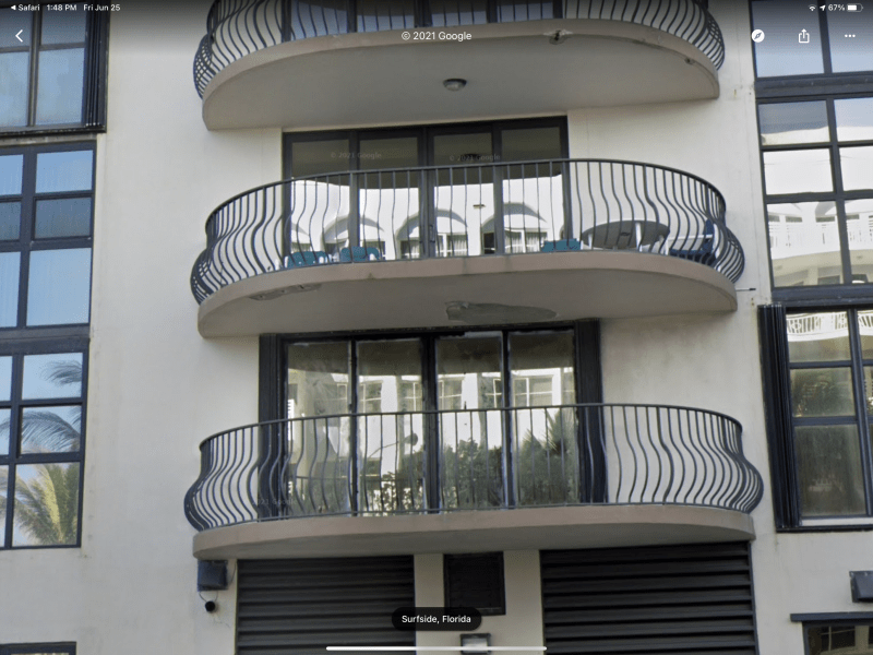

There's definite spalling on the underside of the concrete on the roof and some balconies in Google street view. Rebar exposed. Image taken in January 2021. The March 2018 images don't show nearly the same level of damage, just a small amount on the corner of the roof. Even that isn't present in the 2015 photos.
@Eufalconimorph
I played with the street view you linked to, and you can definitely see that several of the lower balconies were in poor repair on their undersides:

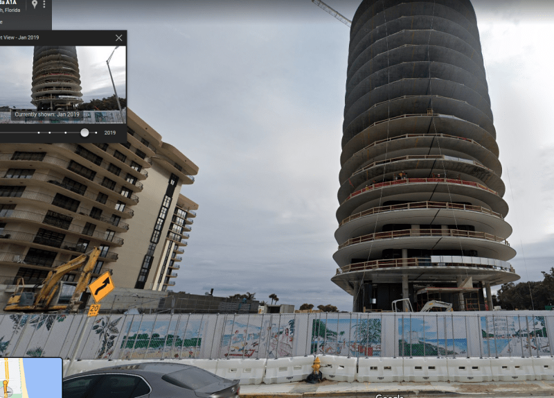

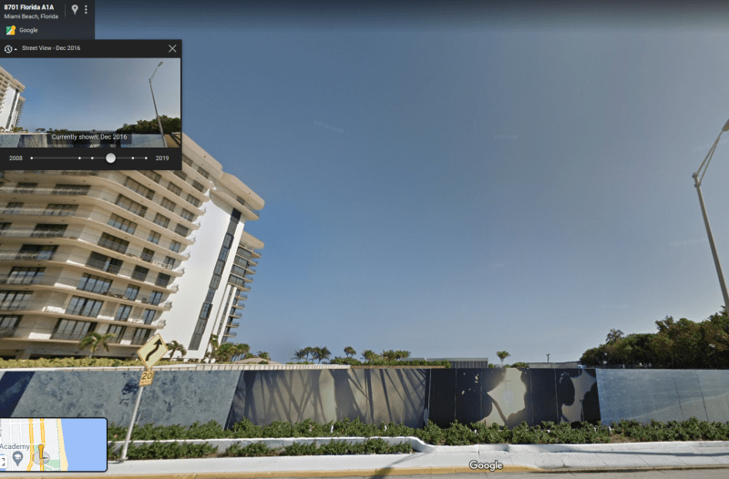

2018: not much visible concrete damage
2019: construction of building on adjacent lot
2021: noticeable damage at roof and balconies
I am hesitant to speculate, but that building did not collapse due to overloading. Design defects, construction defects, settlement, corrosion, sinkholes, are all issues for investigation.
