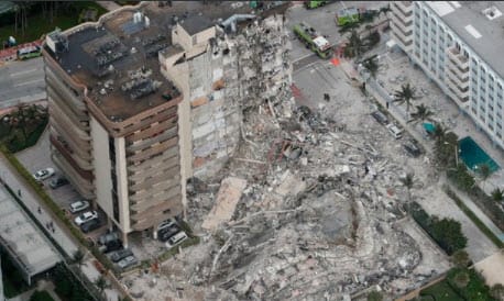

This picture just makes my jaw drop and my heart sink:
How much concern should there be about the remaining structure? I’m not a structural guy but it seems that floor diaphragm might be kind of important as it pertains to those columns.
It seems like if any sort of forensics is going to be done the cleanup and recovery will have to be done in a very controlled fashion. Will they have to bring that part of the building down before they can start to clean all of this up?

In this case, I don't think it is wild speculation to hypothesize that long term settlement overstressed and led to the failure of a 2-way floor slab to column connection. This doubled the bracing length of this column which then exceeded its axial capacity and failed suddenly under buckling. The other hypothesis would be a failure at a column to transfer beam connection.
Questions to investigate - what is the detailing of the 2 way slab to column connection? Photos only evidence top horizontal rebar
What was the geometry of the parking grid columns to apartment grid columns?
Did the building really settle 3" and was that settlement discrete or overall?

@Spartan5 I'm actually concerned about the columns supporting the remaining mid-rise. Their unbraced length has doubled due to the ground floor slab falling down. Thats can be a significant drop in axial and bending capacity for a column.
ongoing settlement over decades certainly seems related to the problem. Seems a, "pop-type" failure, for sure.
