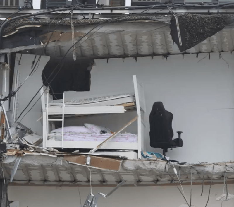

On this building if you look at the roof level and the floor below that (11th or 12th), the rebar appears to have also unzipped like the photo posted at the ground level (photo above):
I think the bottom cover to the bottom rebar was very small - with possible badly consolidated concrete surrounding bottom of rebar and therefore little bond ==> hence ease of unzipping.
The potential unzipping of rebar may have commenced at a construction joint - the rebar was developed into the slab portion that collapsed, and as the slab/s fell it ripped/zipped the reduced-cover rebar in the span that remained. Notice how 'clean' the exposed slab edge at the roof level.
Also, notice the 3" vertical slices @ 10" c/c (?) to the dry-wall under the roof slab soffit - rebar 'cut' the top of the partition wall.

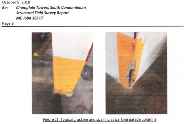

The sudden collapse of relatively new RC concrete frame building is unusual. As the failure appears to be related to the crushing of
one or more concrete columns at the garage level the plausible reason is salt weathering of concrete. Concrete spalling due to the corrosion of rebars
should be also considered, but this will be rather unlikely, as the core of column shall be unaffected, and the local loss of section would create a "Freyssinet
hinge" contained by the vertical rebars and stirrups, or the remaining parts of these. The following is an interesting and likely related quote from a research paper
"Damage of Concrete and Reinforcement of Reinforced-Concrete Foundations Caused by Environmental Effects" published by Procedia Engineering as open access article:
"Salt weathering"

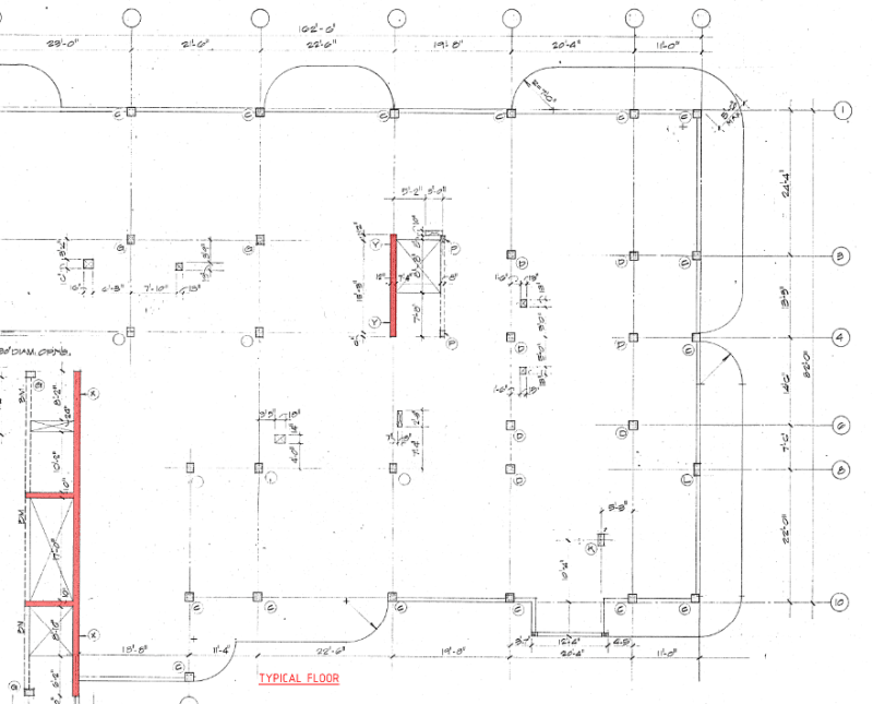

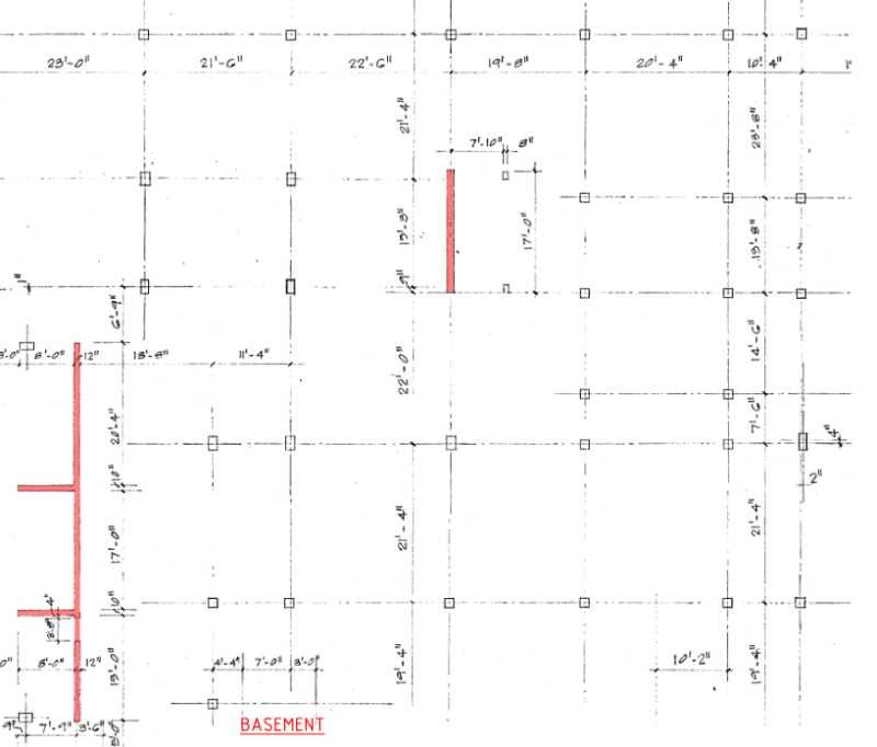

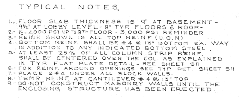

8" thick RC flat plate to typical floors.
9.5" thick RC flat plate at ground floor.
EDIT: No obvious column transfer conditions to the ground floor level See post below.
Typical floor dimensions and column layout to the collapsed area:
Basement dimensions and column layout to the collapsed area:
Very 'light' on structural walls for lateral in E-W direction!
3,000 psi concrete from Level 9 floor to roof level - oh, the 80's!!!

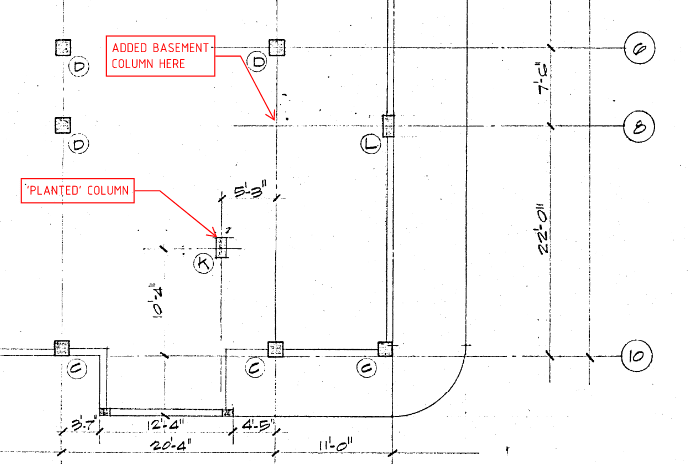

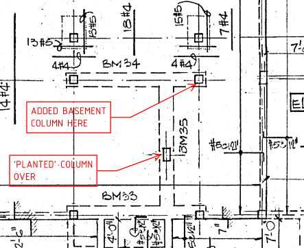

Whilst drawing S-3 PILE CAP DETAIL PLAN appears to be missing (or out of order in the many documents) drawing S-11 has this note:
There is a 'planted' column (from all typical floors over), however it is supported by 24"W x 42" deep transfer beam/s at the ground floor:
Typcal floor part framing:
Ground floor part framing:
Maybe these drawings are not as-built / for construction drawings?

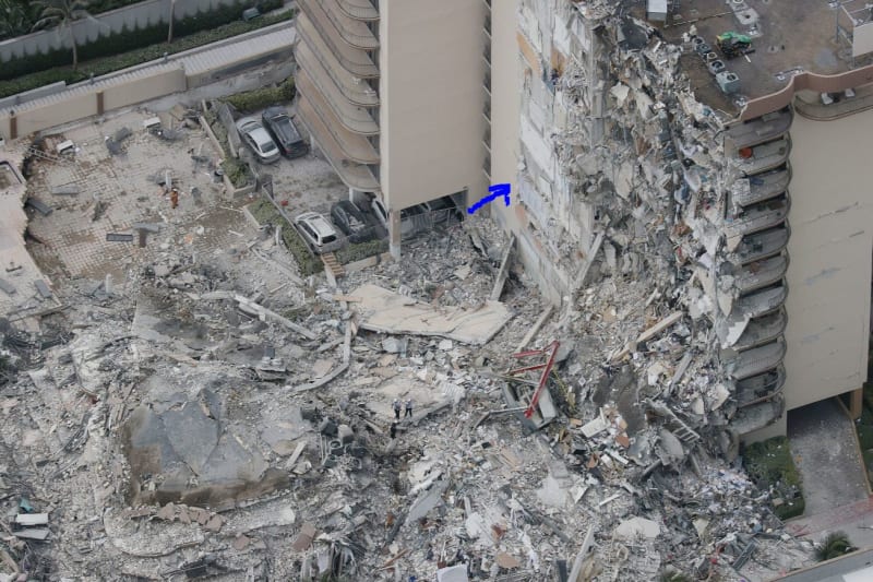

Something that wasn't obvious to me before. The entire site's at-grade slab was elevated, and a large portion collapsed, essentially all the way to the pool and to the property line, even though the collapse of the tower was 100' or so away from this extent of the pool deck. It is remarkable that the remaining building didn't collapse as the elevated slab supporting the parking of the cars in the images failed and dropped a level, leaving the still standing columns with an unbraced height which is double of the "design" condition.
