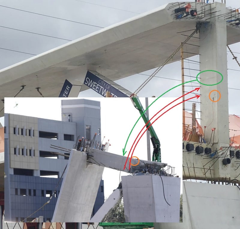

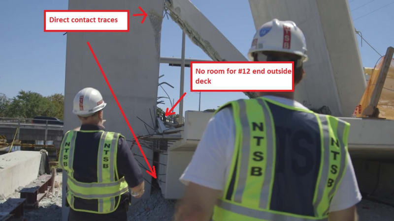

I searched for images with reference points and angles in same plane and mixed with a software editor capable to work with layers and transparency, GIMP in my case.
Images used:
Confirmation for north end of deck:
No traces from end of #12 outside deck:
@Meerkat 007: Nice! Well done finding images with same orientation. I imagined you had some clever technique that rotated 2d images in 3d to get them to align.

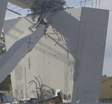

I am rethinking the shear surface. The skid marks and impact on the pier are along each side not in the center where the extension of member 12 would have impacted and slid. Perhaps the failure occurred through the white pipes with red on top. The photo of the NTSB worker digging through the rubble looks like there is a void between the two sets of white sleeves. The pipes would have made a weakened shear surface. Thoughts?
Concrete of member #12 base was pulverized before north deck end fall.
You can still see skid marks of like 2 rebars on pier surface.
