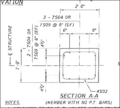

The genesis of this may be in Detail A-A, sheet B-39, which has the note (members with no PT bars). That detail shows 10 - #7 bars. Details with PT bars seem to show 8 - #7 bars.
Temporary PT bars were installed in members 02 and 11 for transportation.
An opportunity for a wrong interpretation? I am not sure 10 bars would been enough - maybe so.

In Section A-A, drawing B-39 I do not see ties wrapping/turning around each compression bar. Is this not required in AASHTO?
I see the bars 6" from the sides and the side bars much closer. In looking at the underside of 11, with the PT rod pulled out, I do not see any longitudinal bars and only a single outside tie with its bend maybe 3 inches past the bars at the corners if the detail is correct.

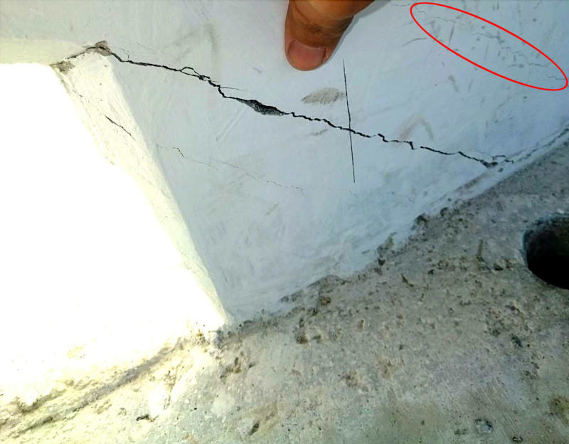

Vance Wiley, since you are examining cracks, here is diagonal crack that appears to have traveled across diaphragm.
The device I marked here is one of 5 string pots Link used to record/plot vertical displacement (position) vs time.
It is for seismic zones. I don't think it is in FL.
I've pointed this out in the past, the odd detailing of the reinforcement. No longitudinal bars at corner bends?? The J-bars embedded in the slab are just floating there?? Maybe the shop drawings show something different.

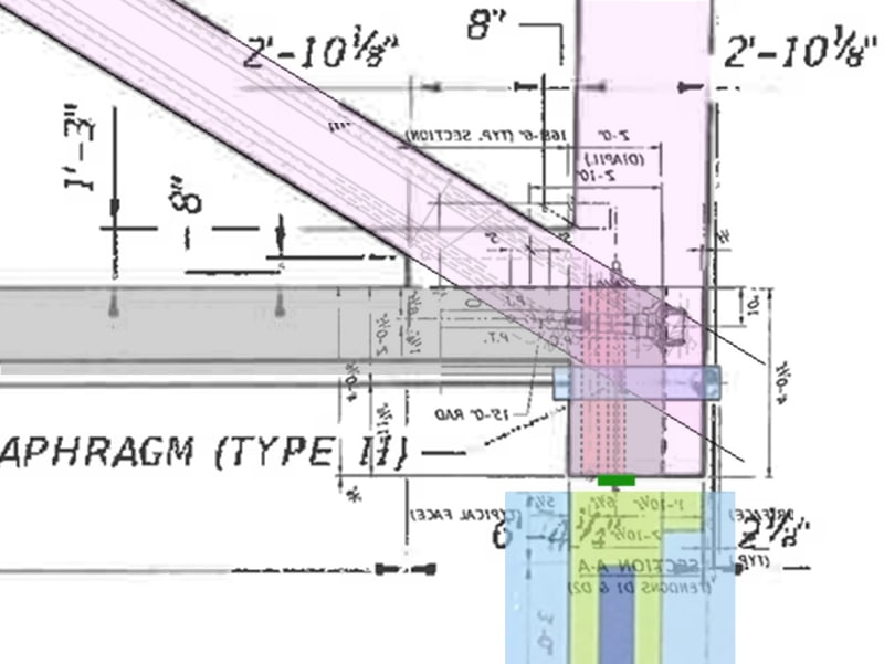

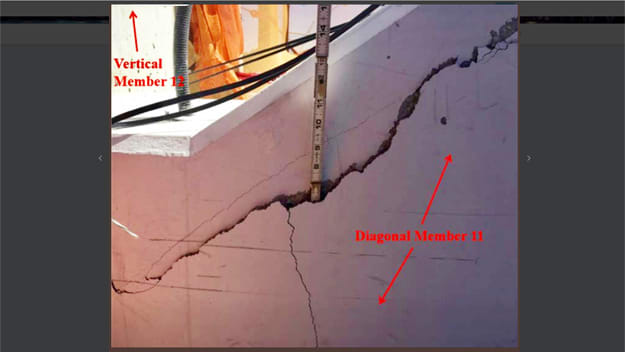

#11 failed early - See attached report. It was posted on the forum earlier and I only know it by its title "CRACKS_REPORT_AFTER_SHORING_REMOVAL", seemingly contradictory to other references as all being well after the shoring was removed. None the less, I refer to Photo #4 and #5 which show a longitudinal crack along #11 proximal toward the centerline of the member and from both sides. Below is a better copy of Photo #4, also taken from somewhere off of this forum. These photos were also revealed in the Preliminary Report as Photo #1 and #2.
I doubt that there is any reasonable explanation to disregard the the nature of this crack. Quite simply, #11 has been racked and will only get worse, and it did!
Also, I've taken some liberty with overlays to highlight the issue of vertical forces transmitted from #11 to the shims. They have to wend their way around both the horizontal drain sleeve and the four vertical sleeves. The 11/12/deck node needed all the help it could get and this didn't help.

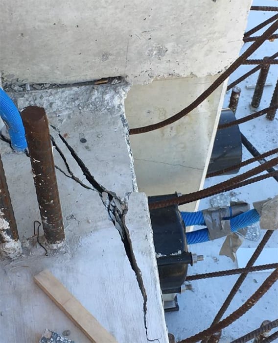

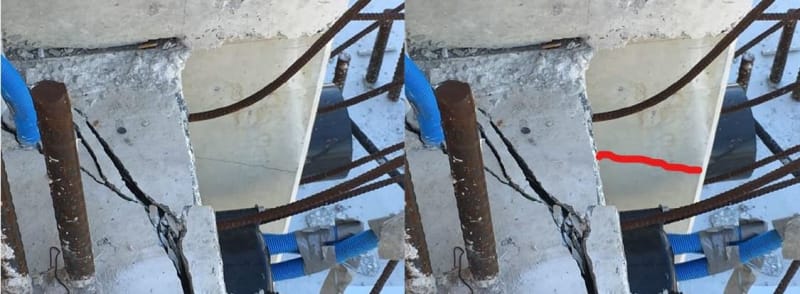

jrs_87 - Yes - that is a breakout forming on the east side of node 11/12. Your photo is remarkably clear and shows perfectly the 8" pipe sleeve thru member 12. That sleeve should have created the formed surface I expected to see in 12 at 20 inches or so below the top of the deck. In looking at the bottom of 12 hanging over the pier,I have not been able to see that formed surface. That suggests the bottom 2 feet or so of 12 is not still attached to member 12.
Have you seen a better photo which shows the sleeve formed opening?
Thanks for the reply.

Looks like a classic diagonal shear crack. Imagine rotating Member 12 90-degrees to act as a beam, with the applied load being the horizontal component of force coming from diagonal Member 11.
TheGreenLama (Structural)8 Jun 19 11:57
TheGreenLama said:
Imagine rotating Member...
I swear you read my mind. That occurred to me too yesterday, I'm very glad you affirmed it. [bigglasses]
Some other random observations. Figg calculations seem to check if steel in only 12 can contain force from 11(?) We know 12 broke at deck cold joint from photos. We also can guess very base of 12 remained for small period of time as diaphragm slid down pier face since the top inside central edge of pier was chipped out. (Or burst force caused chip before deck moved) (Edit: PT bar more likely cause of chip) I cannot confirm, but In NTSB stills, I see what looks like shattered piece of 8" PVC pipe on deck near PT bar. If so, it got there from being scrapped off by pier.
My edited timelapse videos are finally up as a Playlist on the Whirled Gnus YouTube channel.The Playlist and videos are all unlisted so they can't be found by Google search. I didn't add any individual video descriptions - all the details are combined in the lengthy playlist Description. Asmuch as possible, the individual time frames are the identical - all "Move 2" videos start and stop at about the same time, etc. When I get a chance I'll see if I can add links to other relevant non-timelapse videos.
jrs_87 - Good catch. And if the 8" pipe was on the deck after the collapse, it was sheared or knocked loose on the way down the face of the pier. That supports the idea that the failure was at the surface of the deck, or mostly so.
It would be so informative if we could see a good photo of the top of the deck at the base of 11 and 12, all swept clean and all debris removed. That will probably be in the final report by NTSB. I think I saw they had cut out that section of deck.
I would like to see the condition of the 4 hoops of reinforcing across the cold joint - designated 7S01 .
