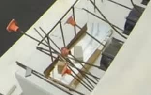

Is there any indication that this was completed or were they still working up to it? Did they lift the span and reset it or just jam stuff in there? Did the remedial action relieve any relevant distress to the structure? Also, the presentation appears oblivious to the significant cut-outs. It just adds to the high drama of incompetence.
jrs_87 said:
Note what appear to be four through holes for the 190 foot pylon.
Sym P. le said:
Instead the forces had to be carried through the slab, around those four holes to the laterally placed shims.

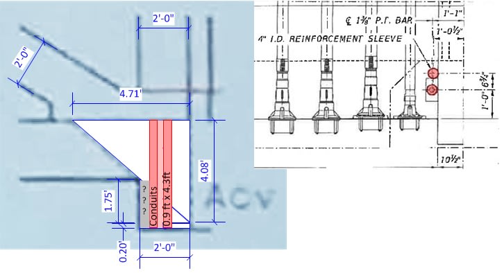

Regarding the four holes, and in connection with the Mar 15 "cracks" meeting and PowerPoint presentation. You might look back to May 11th on the current page of this thread, where this was discussed:
Basically the PowerPoint calculation of shear looked at the vertical planes on each side of the projection of #11 through the deck and diaphragm (not the horizontal plane between #11 and deck), and failed to take into account the four holes. So that area was overstated by 50% (ie: should be reduced by 33%). That was one of three aspects of the presentation's calculation that appears to overstate the shear handling capability of these planes.

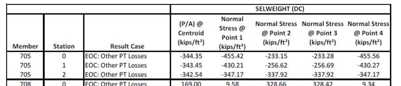

TheGreenLama said:
here's a member load summary extracted from the LARSA model
Thanks for posting those diagrams, which add significant understanding of the otherwise somewhat cryptic pages of tables in the calcs.
Do you have further insight into the meaning of the multiple columns (P/A@Centroid, And Normal Stress at points 1..4), and also the multiple rows per Member (Stations 0..2)?

gwideman - I think you called it here - you posted "Basically the PowerPoint calculation of shear looked at the vertical planes on each side of the projection of #11 through the deck and diaphragm (not the horizontal plane between #11 and deck)".
From what I recall, a recent post (yours, I think) had a shear plane at the top of the deck until it intercepted the sloping plane of the PT rods and followed down at the PT slope, where it exited the end of the deck. I think that will be found to be the failure plane. It also explains the cracks in the top of the deck, which FIGG could not explain in pages 39,40,and 41 of their PP show. As the shear plane followed the PT slope it went deeper into the top of the deck, causing the cracks at the surface and rupture from the end of the deck.
VW - if the failure was in the bulk of the deck then that chunk of deck would have remained attached to 11/12. Instead the deck was sufficiently strong as to pull the lower PT bar out of 11. The failure plane is the cold joint between 11/12 and the top surface of the deck.
Gwideman, I'm no expert in LARSA, but this is how I interpret the output format. Each "beam" member input into the computer model goes between defined nodes. Station 0 would refer to the first node, station 2 refers to the end node, and station 1 is the midpoint.
For stresses you're following the basic formula (for 2D behavior):
normal stress = (P/A) +/- (Mc/I)
where P is axial force, A is area, M is moment, c is distance away from centroid to stress point, and I is the moment of inertia.
The "points" are then locations on the cross section where a stress is calculated. These points are defined in the input somewhere. For the rectangular diagonal members I believe they've been defined as the four corner points, beginning in the upper right corner, then going around clockwise. For the deck, where 6 points are defined (I believe 6 is the max allowable for LARSA), I'm not exactly sure. But they'll be extreme points on the cross section, and will move clockwise around the perimeter.
In our situation, where we only have bending in one direction, half the points are redundant. So, from this stress table you should be able to back out axial and moment forces.
3DDave - I agree the the failure likely began at the cold joint - and days before the collapse. But it appears that, on the way, something developed enough resistance to the movements to transfer enough loads to the top portion of the deck, and cause the cracking photographed on March 13, at the west side of the node and the beginning of the blowout in the end of the deck.
