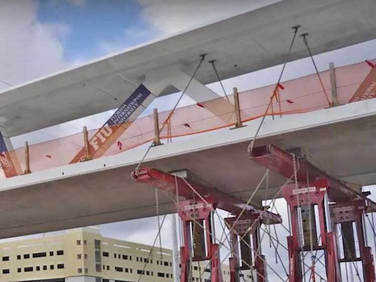

Possible cause of canopy damage to the 10-11 blister area:
[ul]
[li]During the move the underside of the canopy south of 10-11 was anchored to the "arms" on top of the SPTM movers but the span bottom was resting on cribbing directly beneath the canopy anchor points. This allowed the canopy to move independant of the deck.[/li]
[li]The canopy at 12 was chained directly to the deck edges. The canopy could not sway sideways with respect to the deck.[/li]
[li]When the bridge was moved over the roadway median there were several instances where the south SPMT movers moved independent of the north movers, causing the span to spin and shift on the cribbing (watch the north end of the span).[/li]
[li]If the canopy flexed at all during this, the 10-11 blister area would be near the midpoint of section between fixed end at 12 and the flexed portion chained to the SPMT arms. The 10-11 blister appears to be one of the initial failure points.[/li]
[/ul]
Shortly after spin-and-shift events the move was paused and somebody was taken up in a manlift to have a look around. The moved resumed immediately after the manlift came down - before it was even parked.
The SPMTs axles all go up and down independently, you can see this in the ground level shots and time lapses. So going over the median "should" not of tipped the structure. We do see the structure tip when it is being jacked up and down, but it looks as if the trailing edge is raised first, and then the leading edge, so no twist "should" have been induced. Besides, the cracks were noted while the structure was still on the construction supports before the SPMTs came on site. So whatever broke was starting to break before the move. Could tensioning the PT rods in 2 and 11 have pushed the already weak design over the breaking point?
SFCharlie - I'm not talking about rocking or tipping the entire structure. The canopy is chained directly to the SPMT arms, but the deck is sitting loosely on top of cribbing. If the deck shifts sideways (as viewed in the Ground Level video) the canopy chains hold the canopy stationary with respect to the SPMT arms, so the truss area between the canopy and deck is being bent - the vertical line of "I" cross section is bending as the bottom line moves but the top line does not. Similarly When the deck spins on the SPMT timbers while the canopy remains stationary with respect to the SPMT, the truss area between the canopy and deck is being twisted - the bottom line of the "I" cross section is rotating about the vertical line, with respect to the fixed top line.

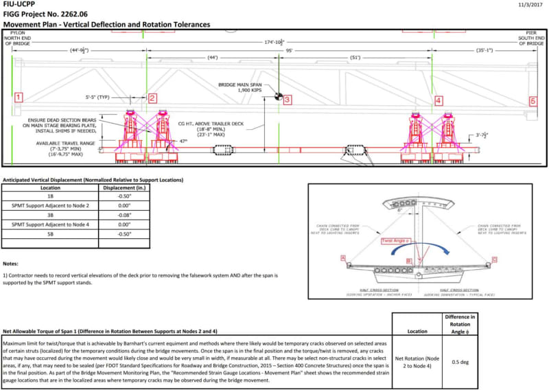

Based on the original SPMT locations, the north end of the canopy was probably supposed to be chained to some arms on top of the northern-most SPMT, but after the design change that SPMT was moved inward, and Barnhart ended up chaining the north end of the canopy directly to the deck edges.
MikeW7 - It looks like the cables run over the edge of the deck and attach to the transporter beams. I had originally thought they were connected to the deck surface.
Vance Wiley - Canopy chains attached to deck at span ends, but to SPMT arms at SPMT lift points:
Re: "Canopy Chains"
This is final plan for move, includes call out for canopy chains.
See jrs_87 (Mechanical)7 Jun 19 19:06 for link:
EDIT: I re-uploaded the images but they still look like crap. A "feature" of the forum I guess....

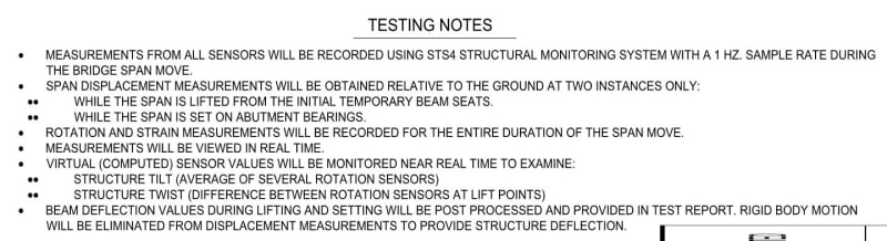

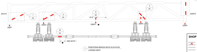

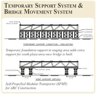

Some notes on the SENSOR instrumentation, taken from the Barnhart Movement Plan link provided by jrs_87 (Mechanical) 7 Jun 19 19:06
In the diagram below, columns 10 & 11 were not monitored at all, and rotation sensors were installed at the points marked DISP2, DISP3 and DISP4. These monitor the structure tilt in the lengthwise direction.
In the diagram below, at 5 equally spaced points (labeled 1-2-3-4-5, but the same as DISP1 to DISP5), 3 rotation sensors (labeled A-B-C) were installed at the deck edges and center. These sensors monitor the tilt of the structure across its width. NOTES:

In the Testing Notes below:
[ul]
[li]STRUCTURE TILT is defined as the AVERAGE OF SEVERAL ROTATION SENSORS - I assume that will be DISP2-DISP3-DISP4 for the lengthwise tilt, and each set of A-B-C sensors at the cross section points 1-2-3-4-5 for the side-to-side tilt.[/li]
[li]BRIDGE TWIST is defined as the DIFFERENCE BETWEEN ROTATION SENSORS AT LIFT POINTS, which I assume are the A-B-C averages at cross section points 2 and 4.[/li]
[/ul]
My observations:
[ul]
[li]Columns 10 and 11 are devoid of sensors. The sensor record will indicate "nothing happened" to them during the move.[/li]
[li]There are no sensors anywhere on the canopy, and BRIDGE TWIST is defined between two deck cross sections (EDIT: at "floor level") at points 2 and 4. The events I described in my earlier posts involve the canopy area at the 10-11 blister moving/flexing with respect to the deck, which is I assume remains rigid. The sensor record will also indicate "nothing happened" to this area.[/li]
[li]These two facts explain why the on-deck activity during the move "pause" did not seem to involve the area around columns 10-11.[/li]
[/ul]
It's been a long afternoon piecing this all together (and I'm hungry), but hopefully I didn't mis-interpretate anything from the Barnhart document.

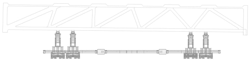

One final note: Below is a drawing of the bridge as shown on the cover page of the Barnhart document. I can understand why it shows the exaggerated tilt, but why are the SPMTs not in the same location as they are shown in the sensor location image? They are shifted quite a bit to the north (right). Attention to details....

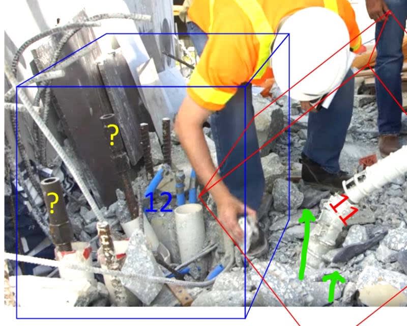

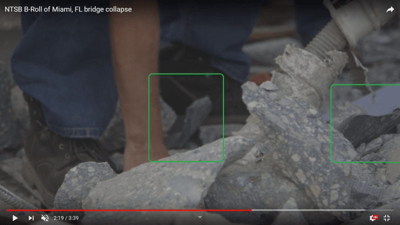

Green arrow show possible remnants of 8" PVC pile. While I believe it's unlikely these are actually remnants of drain pipe, I don't have any idea what they might be instead. Other markups apply to another post.
Still looks like 8" PVC pipe? See attached in next post for larger size.

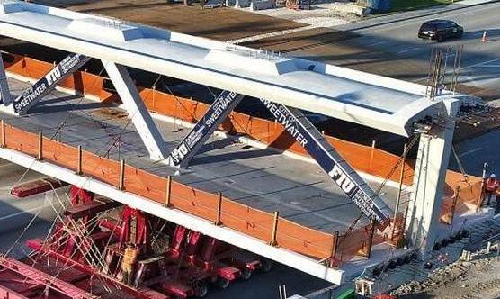

MikeW7 re cables and chains bracing canopy during move - I like the chains better. Big chains well anchored. This seems like the place for something with very little stretch under load - so that means large steel areas. Cable is not called wire rope for no reason.
