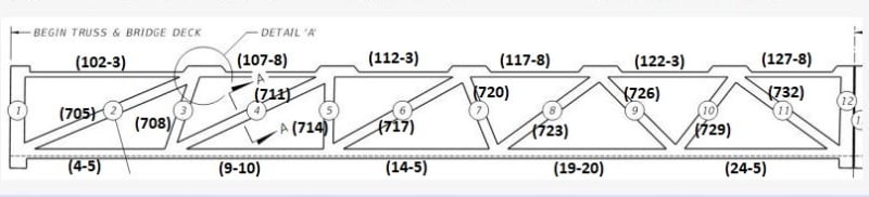

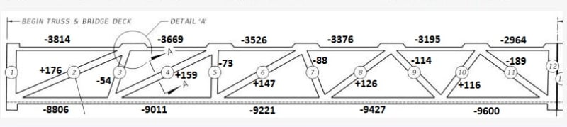

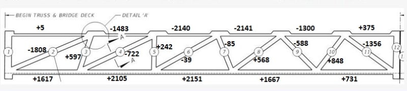

For what it's worth, here's a member load summary extracted from the LARSA model. The issue with the calculations, however, is that they do not include any results for the construction stage at the time of collapse. As far as I can tell, the LARSA construction check done in the calcs only reflects the span during the move. As a result, the closest state I could find is the "end of construction" (EOC) conditions, which is NOT the load state on the span at the time of collapse.
So, a couple of things to keep in mind:
1) EOC state includes continuity PT, pylon, and faux stays.
2) It's presumed the PT case below excludes the permanent diagonal PT; see note at end.
3) Only two load cases are shown below. Others, such as LL, creep, etc., can be found in calcs.
4) A maximum load has been extracted for the LARSA member numbers shown below. These member numbers constitute the bulk of the length for each of the diagonals, top, and bottom chord members. As a result these loads are approximations only.
5) Loads shown are axial only (kips). Bending moments exist, but are not included in this summary. Axial loads are calculated by multiplying the "P/A @ centroid" by member area. If I'm interpreting LARSA output incorrectly please let me know.
6) These are uncombined loads w/o load factors.
7) Negative is compression.
LARSA Members:
Area (canopy) = 16.46 sq ft
Area (deck) = 45.67 sq ft
Area (diag 2) = 5.25 sq ft
Area (diag 3-11) = 3.5 sq ft
Self Weight Forces (kips):
Chord loads found on pp.579-583, diagonals on p.807 of calcs.
Diagonal 2 components (for 23.88 deg):
Horiz = 1653 k
Vert = 732 k
Diagonal 11 components (for 31.62 deg):
Horiz = 1155 k
Vert = 711 k
Total vertical = 711 + 732 = 1443 k
Rough hand calc of self weight of span based on input areas (excludes blisters and some incidental end zone area of each of the diagonals):
Clear span = 174.83' - 2.83' - 3' = 169' (this will exclude weight from Members 1 & 12 and end diaphragms, which are supported on the bearings)
Self weight of deck + canopy = (45.67 + 16.46) x 169' x 0.15 k/cu ft = 1575 k
Self weight of diagonals:
L2 = 29.1'
L3-11 = 162.8'
Wt = [(29.1 x 5.25) + (162.6 x 3.5)] x 0.15 k/cu ft = 108 k
Total self weight to be carried by truss = 1575 + 108 = 1683 k
Post-tensioning Forces (kips):
Chord loads found on pp.603-7, diagonals on p.811 of calcs.
Compare with PT stressing forces from design dwg B-69:
Total deck = (835 k x 10) + (527 x 2) = 9404 k
Total canopy (w/o cont.) = (531 + 534) x 2 = 2130 k
Total canopy (incl cont.) = 2130 + (556 x 4) = 4354 k
Note that the two self weight loads, 1443 k for the LARSA model end diagonal forces, and 1683 k for the rough concrete volume, conflict with the 950 x 2 = 1900 k that has been quoted from the first post in this thread. Not sure if it's a result of my approximations, or if it's something else? The 950 tons was reported as the "lift" weight, which would include Members 1 & 12 and end diaphragms and additional 5.83' of span, so that may be where the difference lies.
Also, if you look at say Member 10, PT shows a positive value. This implies that diagonal PT is not included in the LARSA run for PT case shown above. Diagonal PT is sized on p.842 of calcs based on service load combinations, among others, for the critical axial and bending stresses. After having determined this diagonal PT, it's unclear if the model was then rerun to check long term stresses.
And finally, looking at Member 11 end loads. As Gwideman has pointed out earlier, the values used for calculating the shear reinforcement on p.1283 of calcs (Horiz = 589, Vert = 1233), which were supposedly pulled from the FEA, wildly contradict the loads found in their own complimentary LARSA analysis.

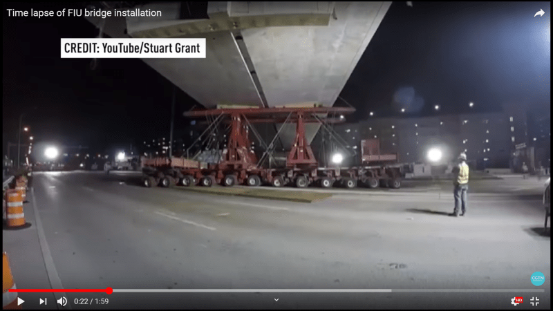

It's worth repeating this link: Especially 17. Time lapse videos (Caution File is large 16GB)
Digging around here you will find high-resolution time lapse videos that you may have seen before, but perhaps not at this resolution. I was able to see someone was indeed down at 11/12 spotting while PT work was being done at blister right before collapse. It would be very difficult to dispute tension was being added to get some type of mechanical result at 11/12. It is also easy to detect uneven lifting and rocking of span (not to say it was undue amount). And you can observe how many times in the two days before collapse, workers visited 11/12.

One thing that has concerned me about this bridge from when I first heard about it: Holding the casting form diaphragm base to be exactly relatively coplanar to the permanent pier landings would be absolutely required, and yet difficult to achieve. What if the form supports settled during casting or were not built with this in mind to begin with? The entire surface area of span was supported during casting, so I admit settlement would not be expected, but it should still be kept in mind.

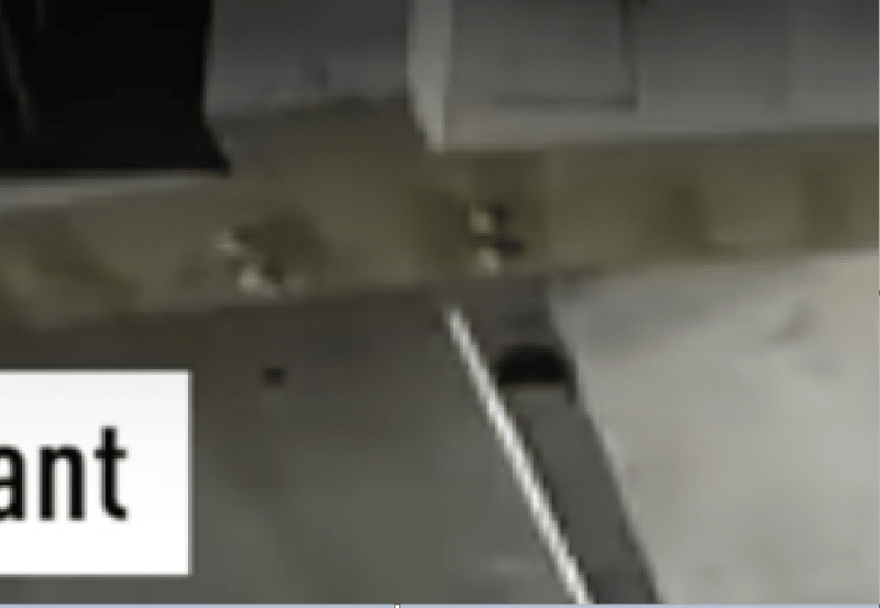

Underside of north side diaphragm shown here. Note what appear to be four through holes for the 190 109 foot pylon.
You've touched on one of the biggest unassuming issues with the placement and it screams from this perspective. The primary vertical load vector passes directly through the pad beneath #12 and yet there was no shim at this location. Instead the forces had to be carried through the slab, around those four holes to the laterally placed shims. This was apparently addressed early after the placement but I have not seen details of how this was carried out.
That was an oops they thought they got away with!
The lack of vertical support directly under node 11/12 was the main focus of the FIGG PowerPoint Presentation of March 15 meeting. They could not explain the cracking at the top of the slab so they proposed to place more shims directly under the node ( between the spaced bearing pads).
I think I recall a 1/2 degree limit for handling/moving the bridge. That is about 1-7/8" across the top of the pier. They would set forms much more level than that. Then there is the chance to level the tops of the bearing pads.
