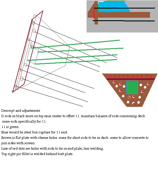

Yes Vance "moving the base of 11 southward will move the "joint" of 11 to deck off the pylon". In a previous post I asked if adding material at the top inside corner of the deck pier joint would violate clearances. I was thinking "Could 11 be extended through the deck to the pier?"

Vance Wiley said:
I would caution that moving the base of 11 southward will move the "joint" of 11 to deck off the pylon and leave moments and shears in deck to deal with.
The idea would be to alter the abutment design with a cantilever to minimize the shears and bending in the deck. This does put bending and shear into the abutment but it would be manageable. The cantilever could also be thick enough to keep the shear within 45 degrees of the vertical abutment support.
In a sense, member 11 is considered to be extended thru the deck because it is intended to be cast EDIT: "ACT" END EDIT monolithically - if the construction joint works as intended. The line of force projects thru the deck and, in my mind, works better if that member inside the deck is defined by a cage of reinforcing and confinement ties like those along its free length. In this case, that was done but the ties were not carried into the deck, as I recall, and really were not adequate along the length of 11.
If all is working right, the center of the joint should be the intersection of the center of 11 and the PT tendons in the deck. The horizontal component of the axial force in 11 should have been intercepted by the PT tendons, leaving only the vertical reaction at the joint to be supported and distributed by the diaphragm.
That is the condition addressed at the Power Point Party.
In this case, the horizontal component of 11 was not intercepted well. I think captured was a term used at the meeting.
Making diaphragm 2 (north end) thicker and casting the main span 175 feet long would have accomplished much of what you are suggesting. Correcting the smooth surface of the cold joint was needed. And perhaps the base of 11 should have been something like 3 feet wide and 3 feet high and extended maybe 5 feet farther south than the little 8" fillet, all loaded with enough reinforcing to ensure no slip at the deck surface and adequate capturing of 11. That would provide the option to use a square end of 11 into the base above the deck
