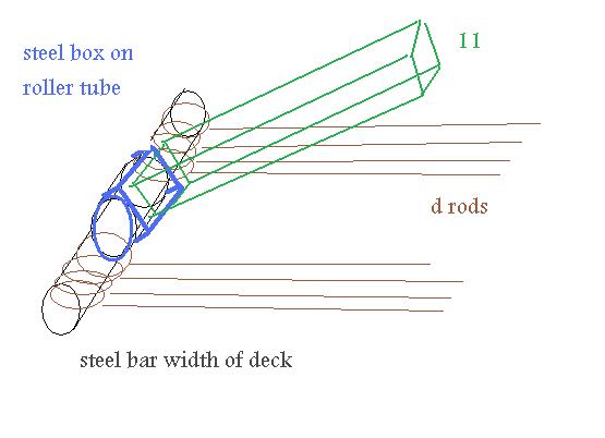

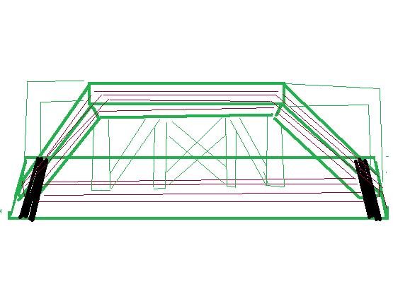

Just a thought. Trying to stay close to original design profile. And it probably wouldn't hurt to fan out all connections. Of course to save time and money, you could build it to original specs. But I don't know how well that will work...........
Next pic shows redesign using upper pic with what I call endless cable running thru and around entire middle to capture forces at ends. You would add my concept to original design.
Sorry I ran out of crayons.
While we're at it. Why not relocate the drain pipe. Fill in the hole. And run some bolts completely thru the canopy down thru the verticals and out the bottom of the deck. So maybe like the bottom doesn't fall out. Get to work people. Let's see the new design revisions.
