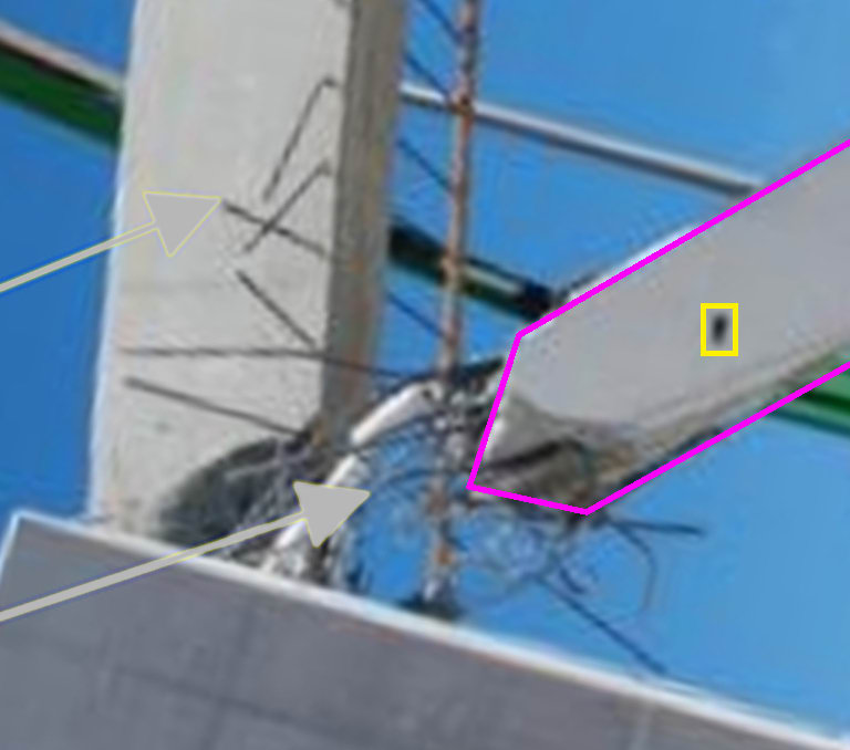

I have also posted what I consider evidence of compression failure of member 11 as the leading event of the collapse immediately after completion of retensioning PT rods in member 11. This includes questionable reinforcing design and deformation patterns in exposed rebar post-collapse.
To forward my own hypothesis, it is that two failure mechanisms were at play, one was the nodal region degeneration, and the second was the member 11 degeneration as it came into the nodal region. Although they played into each other, the weaker nodal region allowed the deck to detach from the node but the structure was able to rely on the connection of the diaphragm with the repurposed member 12 (i.e. a connection not including the deck). Meanwhile, the demand on the flawed member 11 grew and the structure collapsed when 11 failed just above the node.

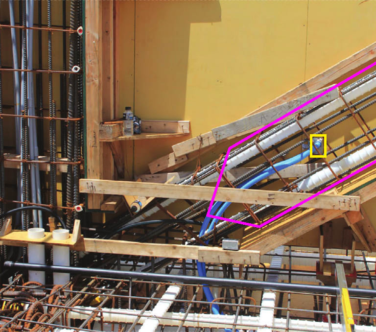

My curiosity kept drawing me back until I happened to make a connection (which I posted in Part XIV, 26 Nov 20 01:39) precisely locating the stub of Member 11 to the formwork/rebar photos and that's when I finally realized what I was looking for. That this explanation (compression failure) was hanging in plain sight for all these years does not lessen its validity. We all missed it even though we were all looking at the same deficient design drawings.

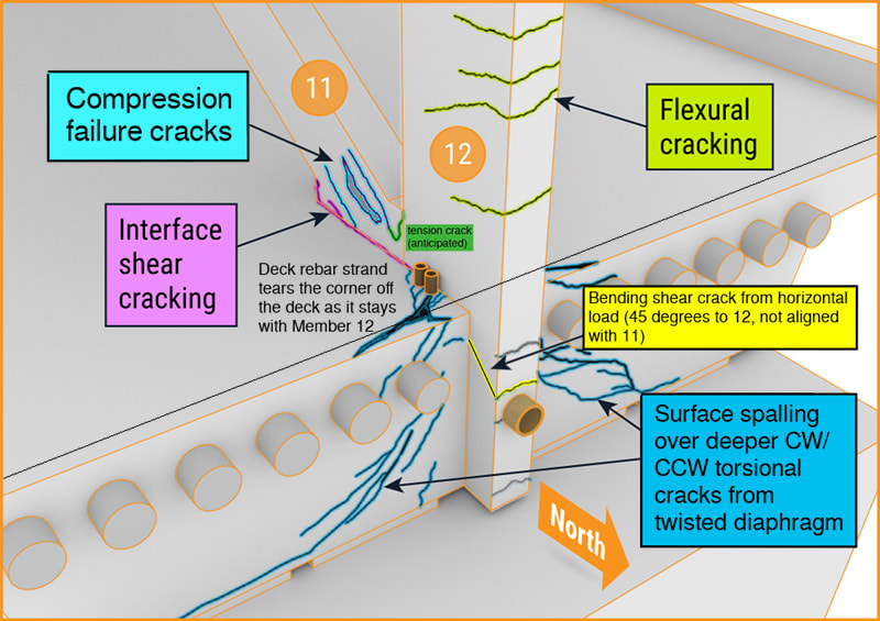

The deck is sagging and moving south relative to 11/12 thus causing the diaphragm to twist. The heel of 11 was not capable of punching out the slab thus it is a very weak argument that somehow the toe of 11 punched out the base of 12. The NTSB essentially posits that the toothpick (11) when pressed against the 2x4 (12) caused the 2x4 to fail which in turn caused the tip of the toothpick to break off.
Does anyone have a take on how much 11 would compress longitudinally at its critical load (Edit: or should I say the critical load of the unreinforced concrete since the rebar was free to pop out)?
The interface shear cracks (below, fuchsia) become vertical, encompassing 12.

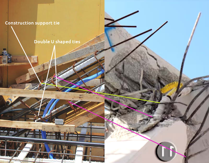

What I am pointing to is a design flaw which I consider part of Member 11. I differentiate from the nodal block based on the rebar design which includes a cage that extends only about 8" above the deck or the height of the filet beneath 11. In Part XIV, I posted a sarcastic sketch illustrating the problem, and I will post a comparison here. No one in their right mind would consider the detail on the right side, yet this is essentially the detail used at the base of Member 11.

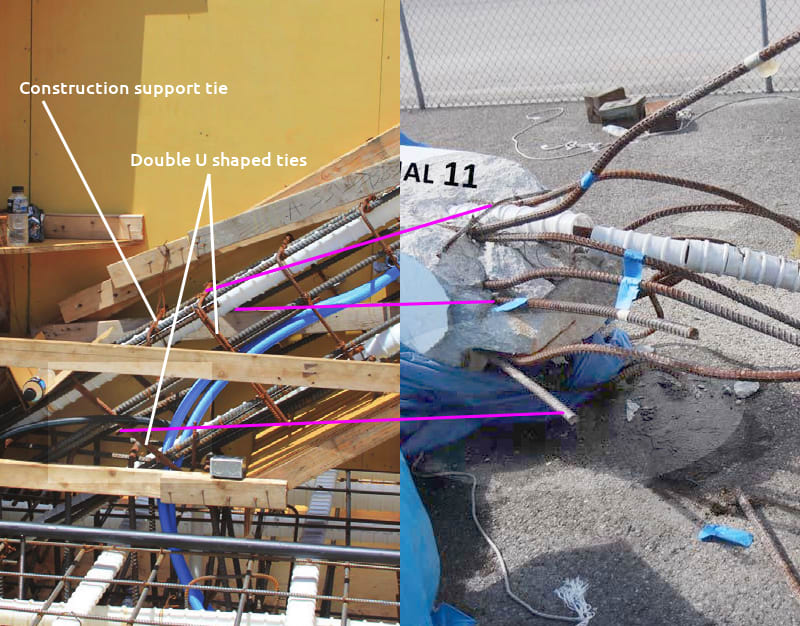

The precise location of the failure in Member 11 is easily seen in the following photos. Note that the skewed U shaped tie (called for in the design) is doubled and the lowest full hoop tie is substituted with double U shaped ties. Unfortunately, Member 11 needs to carry 450 xxx tons through to the deck/diaphragm but the design is clearly inadequate. Calculations are not required and this clearly is not part of any design node, it is the bottom of Member 11 above the node.

As seen in the rebar drawing photo, they did use overlapping U bars. I did the sketch based off the design drawing before I understood as built photos.
It's hard to make allowances for flaky designs with the results produced. I can see in the bottom photo that the two east side longitudinal rebars were sprung free along with the east top face longitudinal rebar. Combined with excessive spacing, this should be seen as something not to do. The substitution for the lowest full hoop seemed to work.
