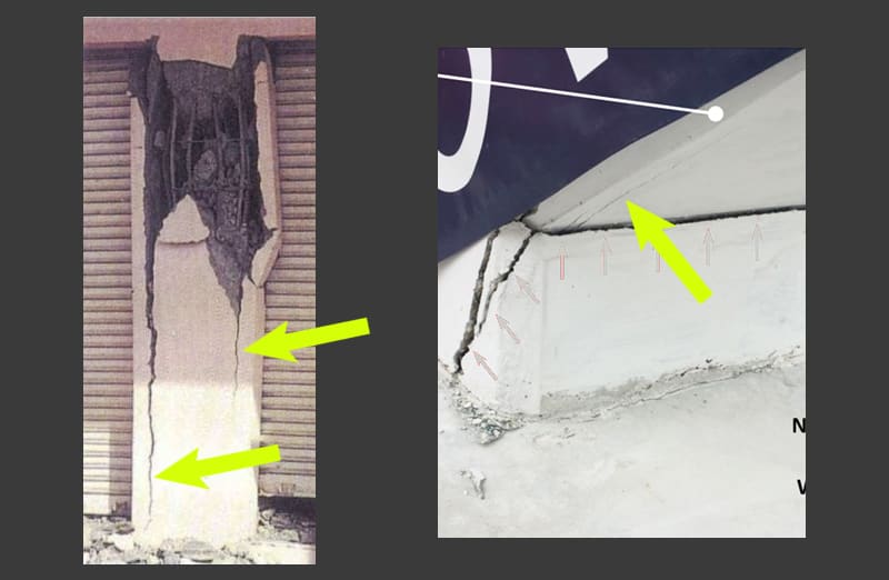

left photo from gharpedia.com right photo from Alexis Molina prior to detensioning.
The NTSB did not core the truss members for evaluation. Although all other testing confirmed the adequacy of the concrete, I felt that they were presumptuous in skipping that opportunity.
If 11 failing in compression was the instigator of the failure, the base of 12 would not have been driven north out of the deck, 12 would have failed in bending somewhere midspan, instead of remaining mostly whole as it was post collapse.
I don't believe that the configuration of the various components as they appeared after the collapse supports your theory.
The photo you've posted above makes it very clear that the node has already migrated north when that photo was taken; member 11 is cracked, but the totality of information is not consistent with a lack of capacity in the last 24" of member 11 being a singular cause for the collapse.
I honestly find it pretty ridiculous that you're leaning into this so hard. The photos don't lie, and they disagree with you.
The cracks on the east and west faces could be complicated by the interface movement but I can't see the underside longitudinal cracking being affected by that movement at all. Another complication when making comparisons is that member 11 doesn't have any rebar in the corners whereas most examples, if not all, do.
The root crack at the base of 11 which runs east-west, and is open by 1/4" or more, cannot open unless the base of 11 has moved north relative to the deck. Cracks can only open if there is localized crushing (i.e. material is removed) or if there is relative movement between components on opposite sides of the cracks.
All the other cracks on 12, in the deck, between the deck and the node areas, are all consistent with the 11/12 node moving north. They are not consistent with compression failure in 11 being the sole trigger.
The video of the collapse also very clearly shows that at the moment of collapse, debris was blown north from the north side of the 11/12/deck joint, and that the canopy hinged at or near the 10/11 node. None of that is consistent with a compression failure in 11 until after the node has already detached, the collapse is in progress, and 11 is compressed dynamically by the movement of the other members.

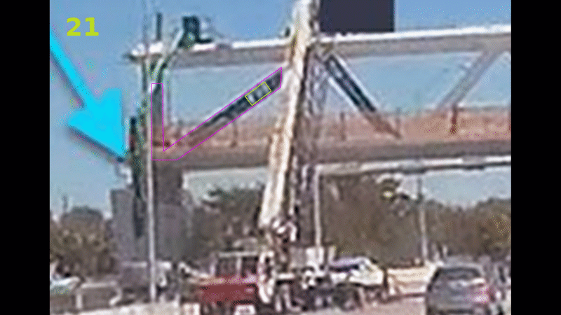

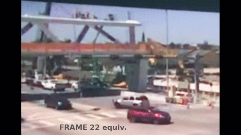

From the Security Video Factual Report (item 106 from HWY18MH009 Docket), the GoPro frames 21 to 24 offer the best indication of the events immediately after Member 11 retensioning was completed. Also the FDOT frames offer support. In both cases I've tuned up the colours to offer more clarity.
The GoPro frames are aligned vertically at the top of the west end of the pier and horizontally at the southeast corner of Member 12. This gives us the best opportunity to observe relative movement of concern. The scale has some issues since the camera platform was moving (increasing frames magnify the subject vertically and horizontally) but over 4 frames, this just needs to be taken as advisement. I've simply magnified the images for processing but have not rotated them or manipulated them otherwise because the vague detail deteriorates quickly.
Frame 22 gives the first indication of collapse and, of interest, in frames 22 and 23, Member 12 does not move from its base. In frame 24, Member 12 shows severe bending which I take to indicate that it's still firmly attached at its re-purposed base, it's connection with the diaphragm. Of further interest is the vertical decent of the banner graphic (or the 10/11 node at the canopy). These two observations offer proof that Member 11 is being reduced. From a fixed point, any other point along a hypotenuse of length 'c' that is following a downward vertical trajectory sees c1 > c2 > c3 etc. So we have all the proof we need to show Member 11 failed in compression.
To further follow my theory, Member 11 is also pushing out to the east and as it gives way, the structure descends. The canopy and slab both show indications of failure in frame 23, the canopy on its upper surface and the deck on its lower surface. Both are fully fractured in frame 24. Through these frames, Member 12 is held in its vertical alignment by the rotational trajectory of the north south portion of the structure.
As Member 12 is held in place and the slab starts to descend at the 9/10 node, the slab rotates the diaphragm off of the base of 12. Torsional failure is super efficient at turning concrete into small chunks, thus explaining the gaping void and surface spalling that wrapped around the base of the diaphragm.
And before I forget, the big blue arrow in frame 21 which the NTSB identified as a concrete blowout can plainly be seen as the bundle of pull cord or flagging that is hanging off of the corner of the deck. All of this has been covered before but I've reordered it to make my point.

Where's the breakage in member 12 where that video shows it bending, because there is no way it could bend that much without being damaged. The failure damage in member 12 is at the deck joint end, not in the middle. If you consider that it's a video artifact and that member 12 was actually relatively straight the bottom was moving north.
Also, I see a funny step artifact in the deck line below or just a little to the left of member 12 in those 2 frames.
Personally, I have yet to see picture or video evidence that proves what exactly happened either way, other than it seems obvious the failure started at the bottom of that 11-12 node.
Barrel distortion in the lens or rolling shutter effect from the video camera do not negate the fact that the base of Member 12 had not gone anywhere significant by frame 24. They still support the fact equally as strong as an exquisite video system. You're suggesting that a propeller is not attached to an airplane if it looks weird in a video.
Sadly. the traffic lights hide the east edge of the deck and the crane hides the top of 11, but it is clear that the north end of 11 descends while the deck does not. The bottom of 11 must be damaged while 12 manages to remain.
PS the rolling shutter effect can be seen in 11 horizontal with the "bend" in 12.

You completely ignored the question I asked and instead posted some stupid comment about a propeller and airplane. How about you answer how 12 could bend like that and yet not have any damage where it bent?
LionelHutz (Electrical)20 Feb 21 02:21]...how 12 could bend like that and yet not have any damage where it bent?
It did not bend. What appears to be a bend is the the camera recorded the top half (of the frame) later than the bottom half. Please note that this camera artifact extends all the way horizontally across the frame.
It not actually bending is why I don't agree with this. The angle of the canopy in frame 24 and the fact 12 stayed attached to the canopy after the collapse together strongly suggest the bottom of 12 was moving north, not still attached.
I agree that 12 appears tilted in frame 23, The canopy appears to till slightly before. We have after collapse photos that show damage to the 12 - canopy joint even if it did not separate.

Sym P.le said:
long post
11 is not translating purely vertically- it is rotation about the end attached to the node, along with the node.
Your own markup shows this clearly. The displacement relative to the north end is roughly linear between the sign you've highlighted and the node- clear indication of rotation.
Note also that the canopy and deck remain parallel through this rotation, and that 12 remains pretty much vertical the entire time. This cannot happen unless 12 is detached from the deck.
