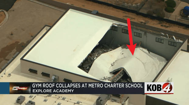

ALBUQUERQUE, N.M. — In-person classes have been canceled at a local charter school for the rest of the week after the roof of its new gym collapsed.
School officials say the new gym at the Explore Academy middle and high school campus was basically complete. They were even planning on hosting a ribbon cutting Wednesday, but that’s been canceled, as well as all in-person classes.
Parents learned about the collapse through an email from the school Sunday night.
“The students are out the whole week now,” a parent told KOB 4 anonymously. “Because they have to get inspectors to gather and, at the request of the inspectors in particular, for students to stay away until they can just look the whole thing over.”
The parent said the incident has raised many more concerns about sending her child back to school.
“Students were going to be in that building in two days, and I think one of the big questions I personally have is, did it pass the inspection already?” the parent asked.
The answer is no. KOB 4 spoke with a rep from Albuquerque’s Planning Department. They said the construction company, AIC General Contractors, failed a building frame inspection on March 6. Inspectors found the trusses bowing or bending.
The city’s Planning Department didn’t know the roof had caved in until KOB 4 called Monday afternoon.
Explore Academy leaders say, as of now, it’s just the new gym that seems to be impacted, but they aren’t taking any chances.
“They discovered the damage and evaluated the situation and decided that we would go ahead and go to asynchronous learning until we have a sign off that the entire building and structure is, in fact, safe for students to enter,” said Katia Pride, Explore Academy’s director of outreach.
Pride said there was no obvious damage to nearby classrooms. The school will also have to bring in an engineering company to create a repair plan.
The city’s Planning Department will be sending a building complaints investigator to figure out what went wrong.

In jerseyshore's very first aerial photo it looks like the truss may have buckled right around the area of the Vierendeel panel?
It's not difficult design and is often done. I don't know why it failed. Maybe we'll find out. On a level of difficulty with 0 being easy and 10 being difficult, this would likely rate a 2 or maybe 3.
Anyone see any remnants of ductwork going thru those bays in the trusses? I don't. Maybe not yet installed? Or maybe using that inflatable fabric ductwork that was easily ripped down with the roof.
If that roof is cast concrete hollow slab, I doubt that any duct work would withstand the impact and will be under the rubble and the remains of the roof membrane.
Are ideas (speculation) as to how/why the roof panels failed in a nice straight line, a line that is not at the unfailed girder? Seems odd.
I'm rather impressed that there seems to be zero information released since April 9th. It's an obvious place to use an FPV drone to get more detailed images of the scene, but nothing from news agencies. That leads me to think there are political shenanigans to cover up some decision.
SWComposites - The panels fell off the truss, the membrane tore at a lap joint.
Roof failure brought down the truss?

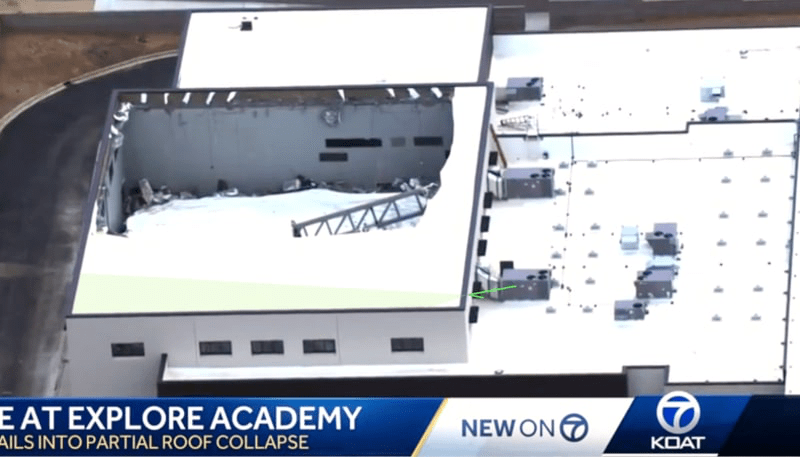

And I don't think at this point that there is much doubt that they omitted the two diagonals so that they could run HVAC ducts through the clear bays.
Well, the HVAC units are installed so the ducts would be parallel to the trusses so this reason for the missing diagonals is highly doubtful at this point.
Those gaps in the truss are clearly intentional. Maybe they were going to string up a walkway there to use lights or hang things from the roof - who knnows?
I'll add something for the benefit of those who may not be familiar. With hollowcore plank roofs, sometimes a 2-3" concrete topping slab is added to provide sloping to drains and to reduce the amount of tapered insulation. Hollowcore planks also have an upward camber, which has to be taken into account by the contractor installing the topping slab. There is always potential for the ponding effect, where the structure deflects during concrete placement, and more concrete is added to compensate, which further increases deflection, and so on.
For those who don't know, and are speculating.
Large Supply and Return Trunk Duct could have been run thru the two openings in the roof trusses. Supply Trunk on one side and return trunk on other side to create distributed air flow. Registers could be on supply trunk or some branch supply ducts could have been run from trunk, parallel to roof trusses for better distribution of supply.
Duct layout all depends on where HVAC unit is located, and whether one or more units are chosen to meet requirements.
The image posted above, shows two package units mounted on roof at end of gym wall, one on each side. So that would confirm that one unit supply trunk runs length of gym on one side, and other unit on other side of gym doing same thing. Returns for both units would be in between the two units on same end of gym as package units. Thus supply is distributed and flows back to central return ducts. Therefore, clearly the truss openings were for HVAC duct work.
