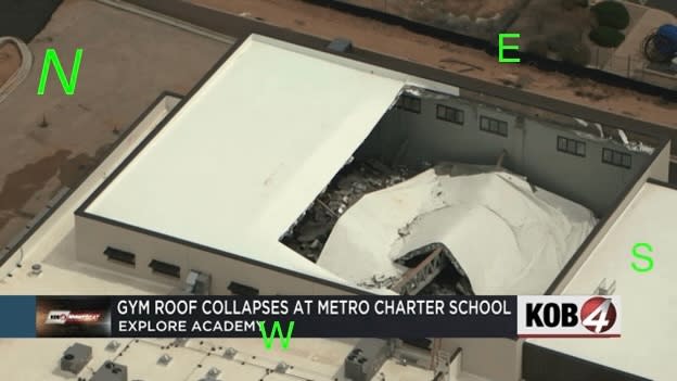

One of the most common problems for a failure like this a construction error. We can order OWSJ with mechanical blockouts exactly as pictured. This detail is not all that unusual. In my experience this is for the main supply duct. The duct piled up in the picture would seem to be feeder ducts given the small size. Those would be parallel to joists in the joist depth. To get sufficient air flow for a facility like this I would expect some rather large mains that our artistic friends prefer hidden as much as possible.
Seems like that if the roof broke on the straight line, it would get pulled into that position by the time it hit the ground and wind up just like that. The roof moved laterally right while the truss mostly just moved down. The straight seam looks like it moved south as far as a line between the two windows. During that process, the truss was shaken off it's support bearing. Then the roof broke at the other seam. That side doesn't look like it moved laterally very much. It doesn't look like it hardly reached the edge of the first window. That half of the roof went almost straight down. And it did not make that "V" formation like the other side did. Its almost a uniform slope.
Did not the left roof panel cracked in the center then went down, pulling it off the left truss and , the edge landing quite far to the right, as it orbited downward from a radius at the top of the still intact right hand truss, which finally gives way, going straight down. Yeah. Crack initiated at the left roof center span seems to fit the end pattern. The damaged truss moved laterally left, look at the bearing point left of the wall pilaster. Why would it go left like that, if the left panel didn't go down first, pulling it in that direction?
I don't know why the east end of the south girder moved north as it fell down off its support. Sometimes we get too comfortable using our words and loose our bearings. [smile]
Like Air Alaska... don't you hate it when they don't put the bolts in?
The north edge of the fallen concrete panels probably landed on a man lift.
Maybe. Looks like there could be a hump there. Regardless, it still looks to me like the direction arrows point to a center of collapse at the left roof.

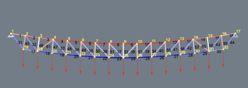

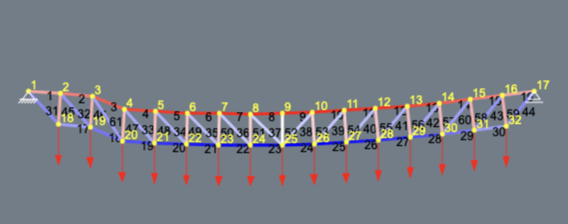

Sym P Ie said:
Below is a 2D analysis of a simple pin connected truss showing distribution of tensile and compressive forces.
I may be misinterpreting your output, however it appears you have a pin support at both ends of the truss, with the truss acting as a stiff rope? Both top and bottom chords in tension, near the supports?
An interesting observation. Perhaps if I introduce a slight camber it would generate compresion across the top.
A normal instsllation would be welded at both ends?
Edit: Using a roller at 17 generates compression across the top and makes the structure more resilient. That is I have to use a lower modulus of elasticity for 61 to elicit the dip.
With 4x4 support wedgies
If the excess deflection was sag and if, as above, a concrete layer is used to control drainage, then that would make for something of a race condition. More concrete is needed to take out the sag and produce correct drainage than expected. The weight of the additional concrete causes more sag. More concrete is used. Someone says "Enough, we've spent more than expected on concrete. Leave it." and thus leaving a very noticeable sag in the main beams.
Since the hollow rectangular roof beams should be supported at each end, that would also add a sag in the gym long direction which would tend to cause the main beams to deflect to the side and make for a non-uniform loading on the pads.
Anyway, any articles after April 9? I suspect a number of people are crowding the exits and trying to reach the lifeboats before this ship sinks.
Using a north facing image of the larger building along with Google Earth, I estimate the gym clear span to be 80 feet. That makes the 16 panels 5 feet wide each and of similar height. A further approximation using the north facing image leads me to believe the top chord buckled at node 4.
Is it possible the vertical compression element coupled with the moment at the lower chord deformed the top face of the lower chord (node 20) and similarly at node 3?
3DDave - if they used topping, you'd be onto something. Since they were only placing insulation on the concrete panels, I don't know if topping was required.
That is ignoring the lack of shear transfer across the open panels.
A lot of the vertical deflection will happen in that open pannel.
It will not look like a rope in tension, but more like a stair step.

The analyses being done are not going to tell us much. There is no question the Vierendeel regions will affect deflections. The question is, does the design work. To answer that would require actual sizes and many other details we do not have access too. The welded joints and sizes would be critical for it to work, but it has been done successfully in endless cases. The stiffened joint pictured previously would rarely be used. They would upsize the vertical many sizes before going that route to save fabrication costs.
