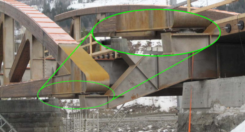

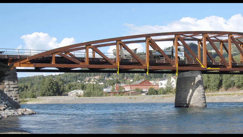

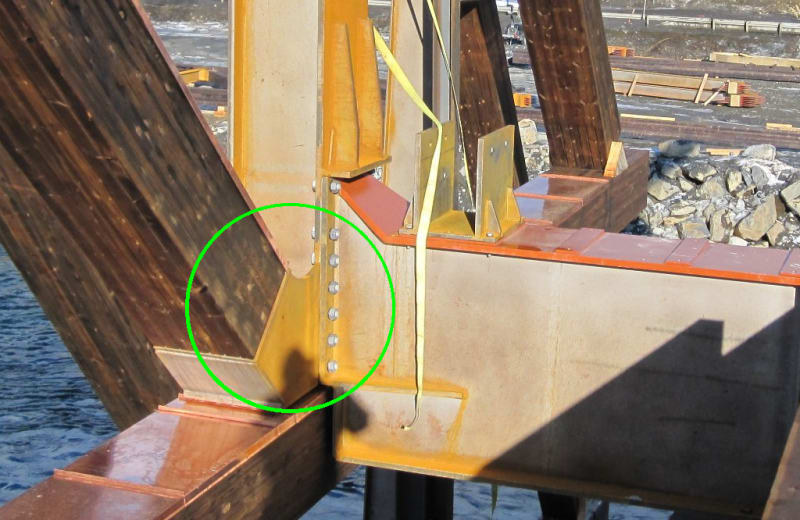

Further to my previous animation, which would require the lower chord of the center span to stretch, is there anything preventing the following motion from happening, given sliding bearing pads? The 5x2 pin pattern at the node on the stone support wouldn't offer much resistance.
No. It looks like a reasonable representation of what would happen with a load. Bottom chord stretches, verticals pull down on top chord, which compresses.
So tell me what I'm missing. Please.
spsalso

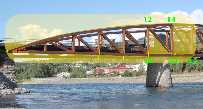

spsalso (Electrical) 21 Sep 22 03:54 said:
... what I'm missing

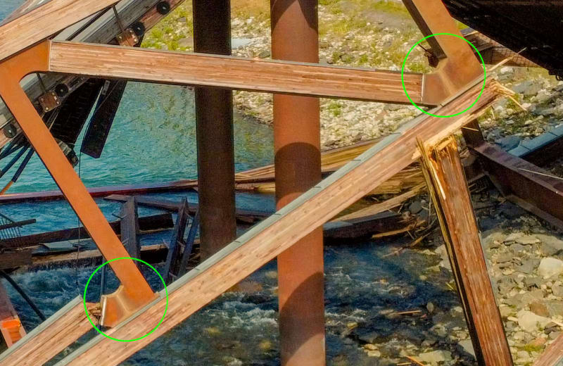

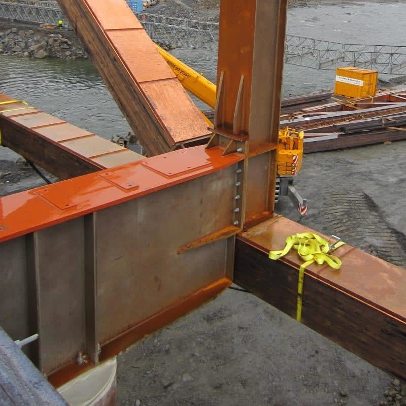

My previous effort imagining the center span to initiate the collapse doesn't work because it required the lower chord to stretch. This progression doesn't require any elements to stretch or compress, at least not to any significant degree. The westernmost truss node is free to move east and nodes 11, 12, 14, and 15 can all flex enough to accommodate the western span downward deflection. That leaves node 13, which is not clearly indicated in the animation.
My theory is that the steel support frame (the cross beam and two vertical elements) at the stone support pushes east (at node 13) across the support causing the slotted-in steel plate and pin connection to tear the lower truss chord effectively eliminating that connection point. The chord doesn't have to drop away from the node, it just has to be ineffective or "shredded". The chord will still exist momentarily until it succumbs to the compression between nodes 11 and 15 (and the pin arrangement at the node likely served to split the chord).
Once the structure is diminished to this extent, the self weight of the west span will continue to push the supported frame off the support as the lorry moves to the center span. From there the center span will sag and snap off at node 14. As I was proposing earlier, as the center span sags and starts to drop, it pivots about the steel column support at its east end. This will cause the two trusses to splay out (above the steel column support) and detach the bolted connections between the cross beam and vertical elements.
Edit: I had east and west mixed up. It's fixed now. (The image is of the western span of the bridge)
To summarize, my theory is that the collapse initiated with damage to node 13. Though the lorry was the final straw, the damage was likely accumulated during the short life of the structure, and likely punctuated by a few exceptional loads as have been documented. This incident, resulting in the collapse, likely started as the lorry proceeded across the western span.

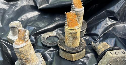

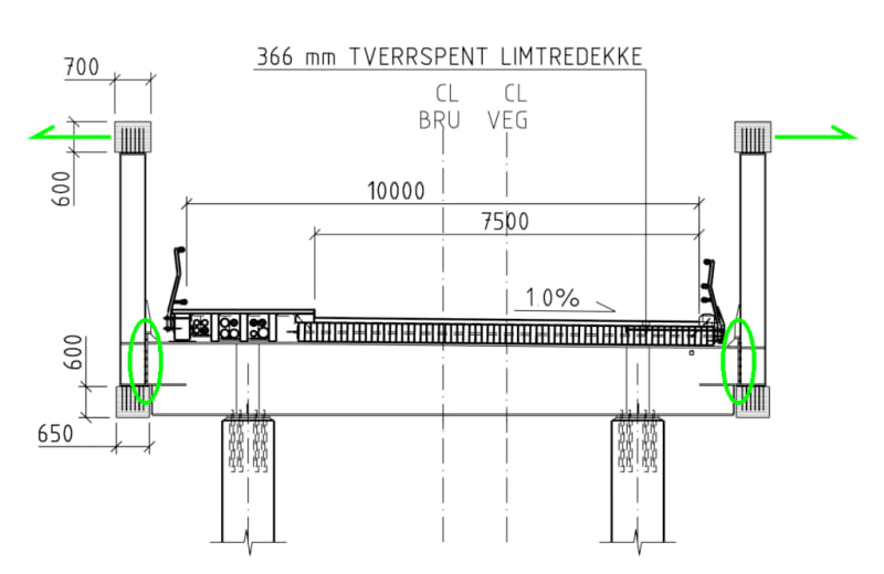

The Accident Investigation Board is investigating bolts on Tretten bridge that broke at 90 degrees after overloading
Paywall article
havarikommisjonen undersoker bolter pa tretten bru gikk i 90 graders skjaerbrudd etter overbelastning
Are these bolt fractures consistent with the theory that the truss splayed outward and unzipped the bolts from top to bottom?

Edit: see Figure 3 on this page
croberts.com said:
The 45 degree full-slant fracture surface indicates high tensile loads. The fine, gray appearance of the fracture surface is consistent with a sudden overload failure.
I believe the pockets at the nodes are covered after the bolts are installed and thus a number of the bolt heads can be recovered.
From the report, regarding the recovered bolts (using Google Translate)
Report on examination of bolts from Tretten bridge
SINTEF has so far received and examined 21 half-bolts that were used between trusses and cross-beams on
Thirteen bridges. The bolts were retrieved from the river in the area around axis 3 (see figure 2). It was quality M24 bolts
8.8 and M27 bolts of quality 10.9.
All M24 bolts received (14 halves out of 48 possible) have a shear fracture 90° on the longitudinal axis, and have
probably been sheared by relative movement in the plane between the cross member and the knot in the truss that they tied
together. All M27 bolts have fractures caused by tension/bending movement in the bolt's longitudinal axis.
Furthermore, no signs of fatigue or previous damage have been observed on the bolts received, and the fractures show
ductile behavior for both bolt classes. Overall, this indicates that the bolts received have broken
as a result of overloading when the bridge collapsed.
At this point in the investigation, it cannot be ruled out that there may be other bolts than those examined
been subject to fatigue or failure that has developed over time.
Rapport om undersøkelse av bolter fra Tretten bru
SINTEF har til nå mottatt og undersøkt 21 halve bolter som ble benyttet mellom fagverk og tverrbærere på
Tretten bru. Boltene ble hentet opp fra elva i området rundt akse 3 (se figur 2). Det var M24 bolter av kvalitet
8.8 og M27 bolter av kvalitet 10.9.
Samtlige mottatte M24 bolter (14 halvdeler av 48 mulige) har et skjærbrudd 90° på lengdeaksen, og har
trolig blitt klippet over av relativ bevegelse i planet mellom tverrbæreren og knuten i fagverket som de bant
sammen. Samtlige M27 bolter har brudd forårsaket av strekk/bøy-bevegelse i boltenes lengdeakse.
Videre er det ikke observert tegn til utmatting eller tidligere skader på de mottatte boltene, og bruddene viser
duktil oppførsel for begge bolteklasser. Samlet sett indikerer dette at de mottatte boltene har gått til brudd
som følge av overbelastning da brua kollapset.
Det kan på dette tidspunktet i undersøkelsen ikke utelukkes at andre bolter enn de som er undersøkt kan ha
vært gjenstand for utmatting eller feil som har utviklet seg over tid.
Lots of things can get broken in a collapse, things which are not necessarily the cause of the collapse.
Yes, and thank doG we can rule out the concrete and rebar as well.
Interesting that they dragged the river for those bolt pieces. In the end I suspect we'll find out that the heads popped off.
No, the heads are still attached. They broke through the threaded part of the bolt, probably just adjacent to the nut, and the bolts in the location you pointed out don't seem to have had washers.
