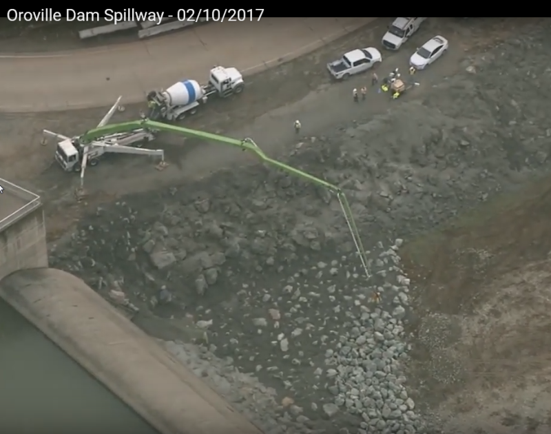

msquared: The pictures of the guy pumping concrete into the riprap below the lip of the emergency spillway two days agodidn't give me warm fuzzies regarding the state of that outfall.

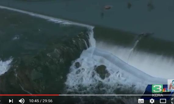

I'm wondering if the thing they were concerned about was on the LHS of the spillway as you look from downstream. You can see that the water level was so high that water was flowing from the entire area to the ~LHs and creating a gully right at the end of the concrete slope. If you look at the picture racoope posted you can see the concrete seems to end abruptly. Maybe that end was being eroded by water flowing from the grassy areas and getting behind the concrete face of the spillway / eroding the toe??

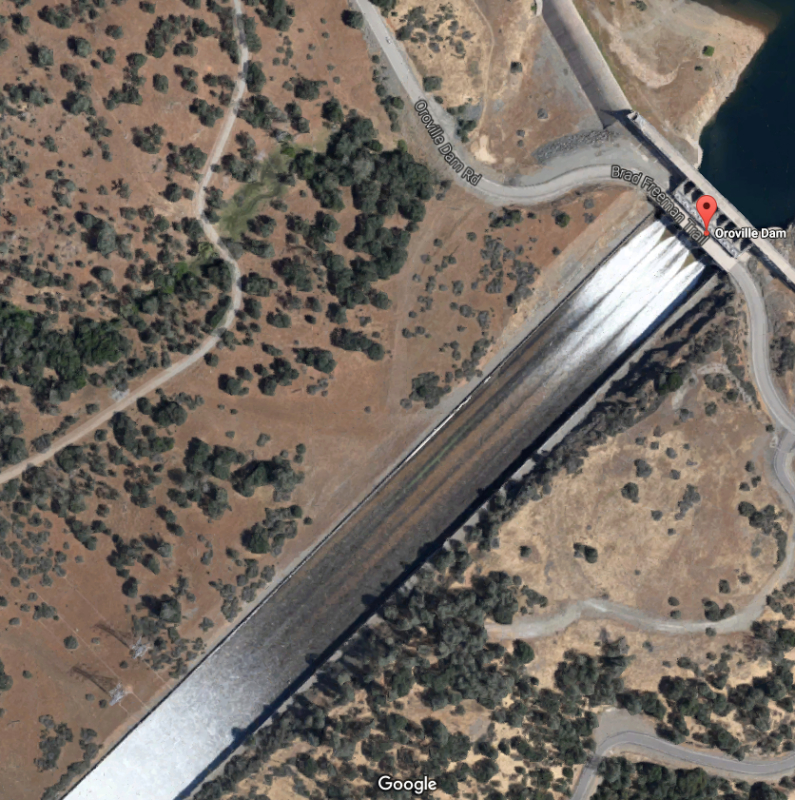

It wasn't obvious what the issues were with the normal and emergency spillway, but one issue is the transmission towers at the lower left of this Google Maps image, which sit between the two spillways, and either one could generate hill erosion that could potentially topple the towers.

I got a 404 to that link, but this is where I think they were concerned - I would have been.
Basically the end of the concrete ramp where the water from the rest of the area is funneling down, threatening to get behind the concrete wall.
Also very difficult to inspect until the water stopped.
