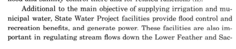

itsmoked: On your statement that these projects originally were for flood control, check this out. I recall in the 60's hearing talks by a famous engineer who had opinions on several subjects including water projects, his main specialty. Adolph J.Ackerman complained about the wishful payment plans for these projects and mentions the Feather River project as a planed major source of drinking water, not flood control. He predicted funding failures.
Here is part of a paper on this subject and a portion about Ackerman.
The Google search also shows a number of other references for this famous engineer.
I will add one more part of the California Water project
[URL unfurl="true"]https://res.cloudinary.com/engineering-com/image/upload/v1487177366/tips/Califoria_water_project_1_sip9jp.bmp[/url]

Oroville Dam was part of the Central Valley Project, which was to control spring floods and provide a year-round water source for farming further south of the delta. As with most projects of this type, multi-functionality always sells better than single-functionality. Therefore, the ability to supply drinking water and generate electricity simply adds to the appeal of the project. The CVP plays a major role in allowing the southern half of the Central Valley to be part of the agribusiness of California.
