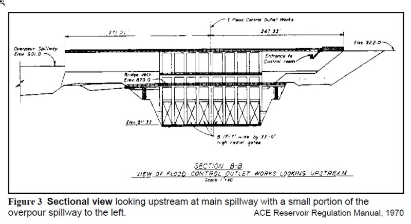

According to the document referenced by Spartan 5 the bottom of the main spillway gates is 90 feet below the top of the emergency spillway.
Interestingly this also gives section details of the spillway - looks rather simple to me.... No wonder they were worried. The section is noted later as being in the middle of the emergence spillway.
SNAP!
WOW!
90 feet of head on a 33 foot high Radial Gate.
These must be some honkin' gates!
At elevation 855 or so where they are now, they still have 44 feet of head on the 33 foot gates.
You'd think that they have some lower sluice gates they could open too, but maybe not.
Mike McCann, PE, SE (WA)
