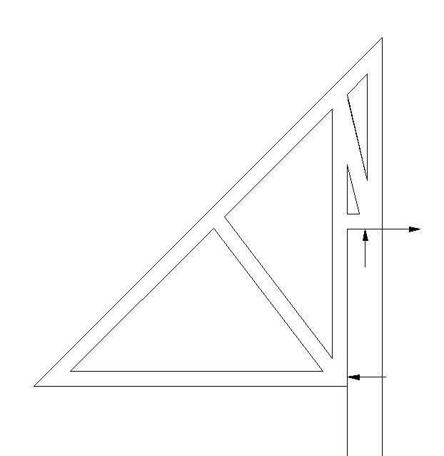

Partial collapse of false Mansard roof at 17500 NW 68th Ave, northwest Miami-Dade County, Florida
There's a picture illustrating the method that was used for the Mansard:
It appears there was a concrete wall built up to the height of the roof, with some sort of shelf inside to hold the roof rafters. The lower 40% of the Mansard could/should have been attached to it. The remaining 60% of the height was a stud wall placed on top of the concrete.
Some of the weight was returned with diagonal 2x's landing at the bottom of the concrete section. That would then appear to be the "point of rotation" for the assembly. I believe the only thing that was preventing that (or not) was the 90 degree "return walls" on the roof.
I don't see much evidence of significant attachment to the concrete to provide an anchor against the rotation.

spsalso - that's a pretty common cantilevered truss detail. It isn't a 2x4 wall - it's part of the truss. It's stepped to produce a bearing seat so the vertical reaction is taken in bearing on top of the concrete wall while a connection at the base of the truss and the connection at the top of the wall take lateral forces as a couple to resist the moment and hold it in place (prevent rotation)
You're most welcome - and thank you.
The problem with this kind of truss is that the connections are concealed. You're relying on the roof and flashing to keep water from getting in there and rotting out the wood at the connectors. In a building with lots of water issues...yikes. Used for the front canopy on a shopping center with a vented soffit with access panels isn't that big of a deal since it's easy to inspect. But 30 to 40 feet off the ground? This is probably the first time anyone has laid eyes on those connections since they were installed 45 years ago.
